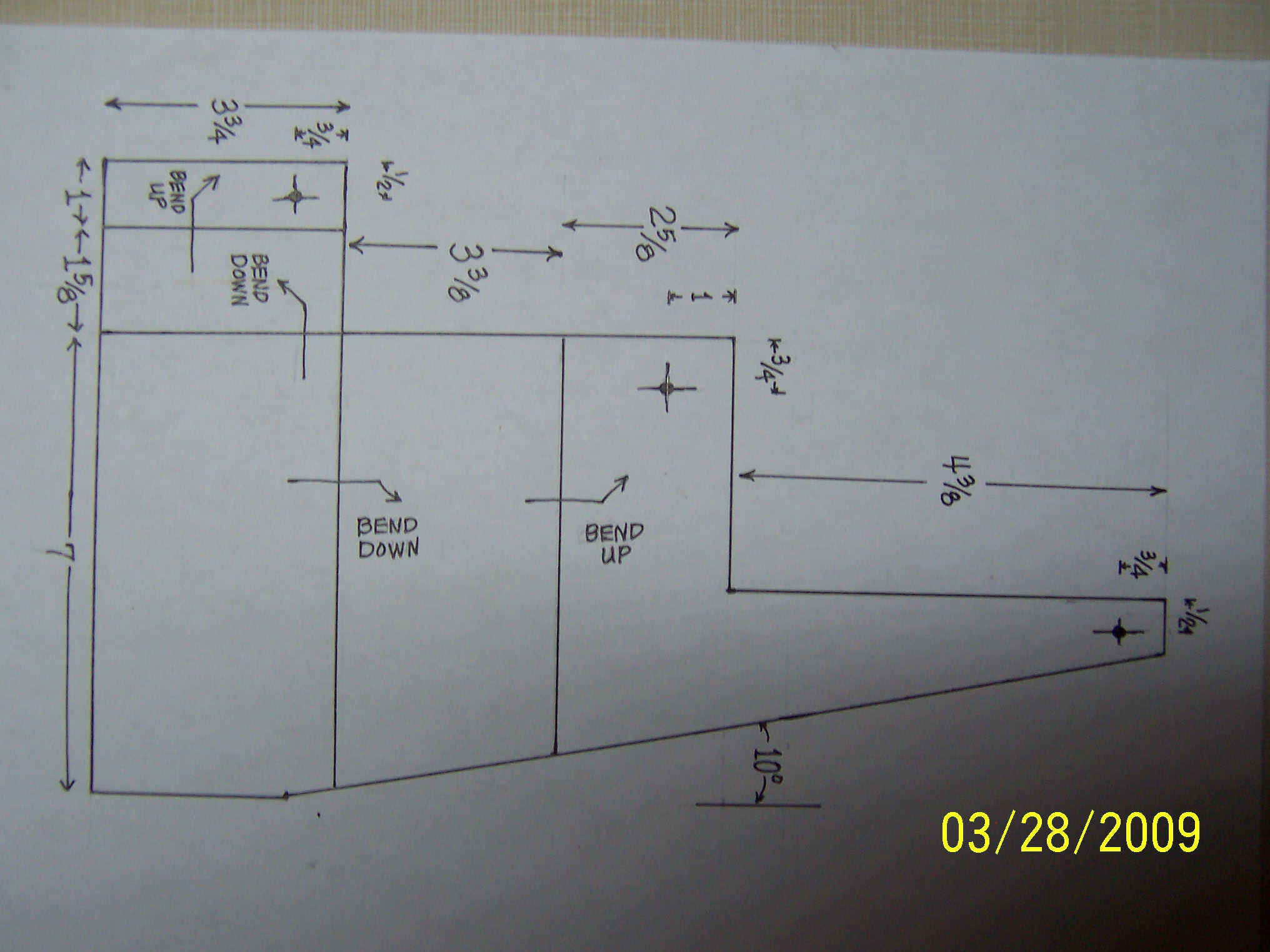

just remember
the mower is your trans fan shield until you make one up
this is taken from another member
others please help with proper credit
winter is here so have spare fuel filters
and "enjoy"
/ JD 2210, 54C Belly Mower #6
just remember
and "enjoy"
tkoza:
I'm the one who posted that template.
Did you make one for your tractor?
