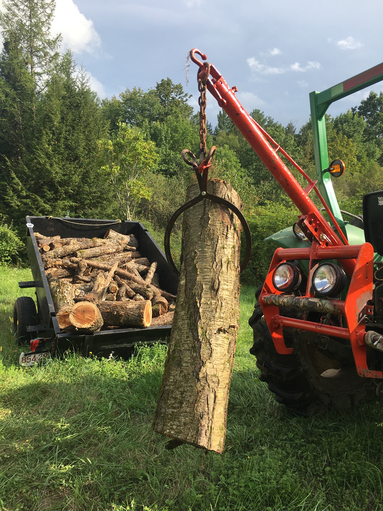

My 1050 with rear 3pt log drag, boom pole that extends another 4.5 feet. Home built.
