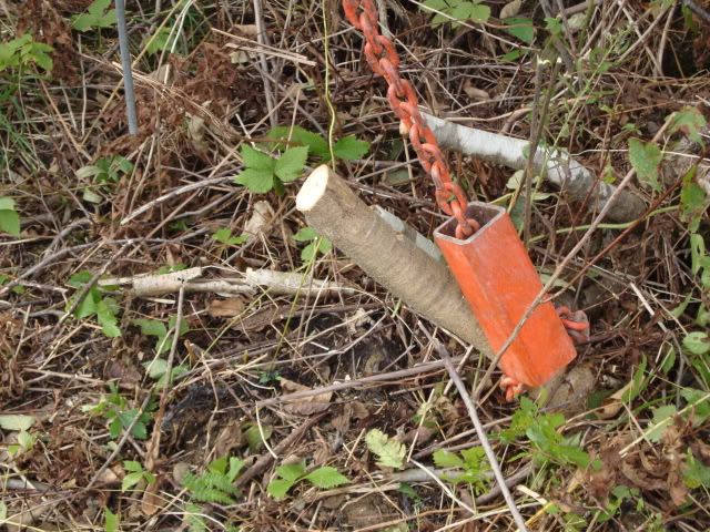

The advantage is that the pipe acts as a pry against the trunk, the pipe ends bite into the wood preventing slippage.
Here is a high-tech drawing of it:confused2:. You could also use square tube. Drawing is not to scale.:laughing:
thank you very much for the drawing.. I have followed this thread (or one very similar) for months now and was embarrassed to say I was clueless to how the chain/pipe connected to the tree.. For some reason I thought you slid the pipe OVER the small tree..

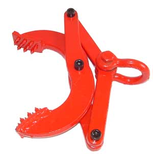

The store version looks great but it is too much money. I'll weld something together, now I know how it should look.
From the picture it looks to be a great idea but for 450$ it should cut it, and stack it in the wood pile.
Thanks for the drawing. I asked for someone to post a picture 5 months ago since I just didn't understand why it would work. My mistake was I believed the side of the pipe rested against the tree. The end of the pipe digging in as you illustrated makes sense. I think I will make one up this weekend and try it out.

Be sure to use high strength chain, mine broke on the first try.
Come to think of it, the rain has almost stopped here, I think I'll spark up the ol' welder and try making another one. I've got some 5/16 grade 70 chain somewhere here..
We're pulling a ton or six of alder stumps here lately, I'm getting tired of wrapping the stumps twice with chain.. although that does work with 90% of them.

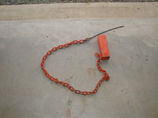

I finally had a chance to get some pics and a video of both the "gripper" and the A-frame in action.
The stumps weren't big, not really a challenge for the tractor or frame, but show how they work. Larger, more deeply rooted stumps load things up more, but still come out for the most part.
The pipe is 2.5 inch 1/4 wall square tube, grade 70 chain, the "feather" really helps threading the chain through roots, etc. I decided to leave the chain longer this time, it's easier than threading a grab hook through the pipe every time. If you're trying to get a clump of small stumps (alders) out together, you can still loop the long hauling chain through the tube and hook it to the bitter end of the chain if the attached chain is too short.
