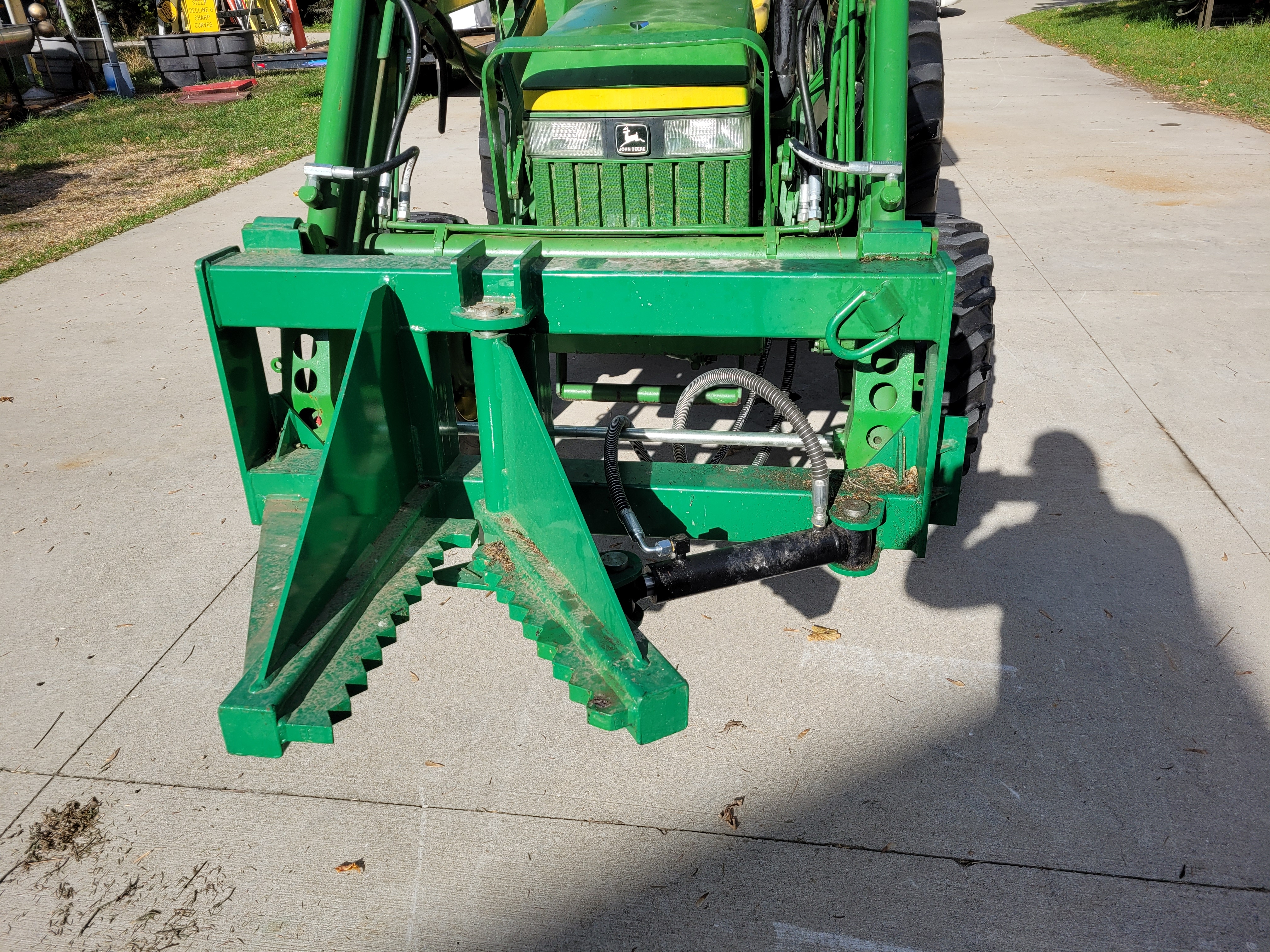

I use a 'Tree Shear'. Basically a horizontal scissors like gripper. Works perfect for 3-5" trunks (limited by loader capacity). I use the bucket curl circuit to open and close the jaw. You get roots and all the rest.
