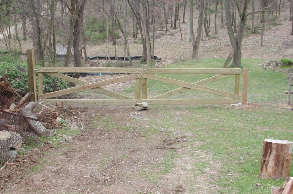

I like your FOPS. It seems well thought out. I noticed in your first photo that there are some gates in the background. Did you happen to make them? If so, could you post some closer photos of them. I am thinking about making some that would be similar.
Thanks,
/ It's not a Canopy, but...
#27
Re: It\'s not a Canopy, but...
Yes, I made them this spring...
Here are some photos...they work real well. Each one is about 9 feet long. I think I made them from 10' lenghts and just sized them so the cross pieces would reach.
Front view without the man gate...
PS...that stuff is the 1" thick PT wood. I think it is called 5/4...

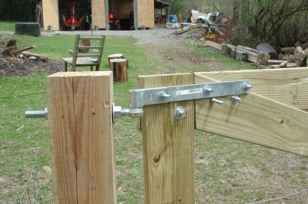

#28
Bolted things together with grade 2 stove bolts from TSC, and use the TSC gate hinge hardware as well.
I am reall happy with the way they turned out and work...

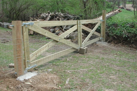

#29
View from the back...

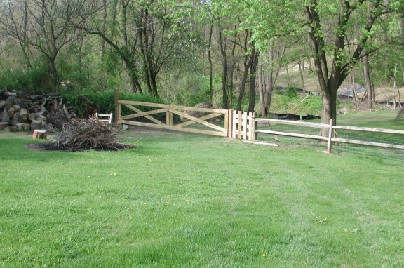

#30
With man gate in place...
Hope this helps... /forums/images/graemlins/smile.gif
