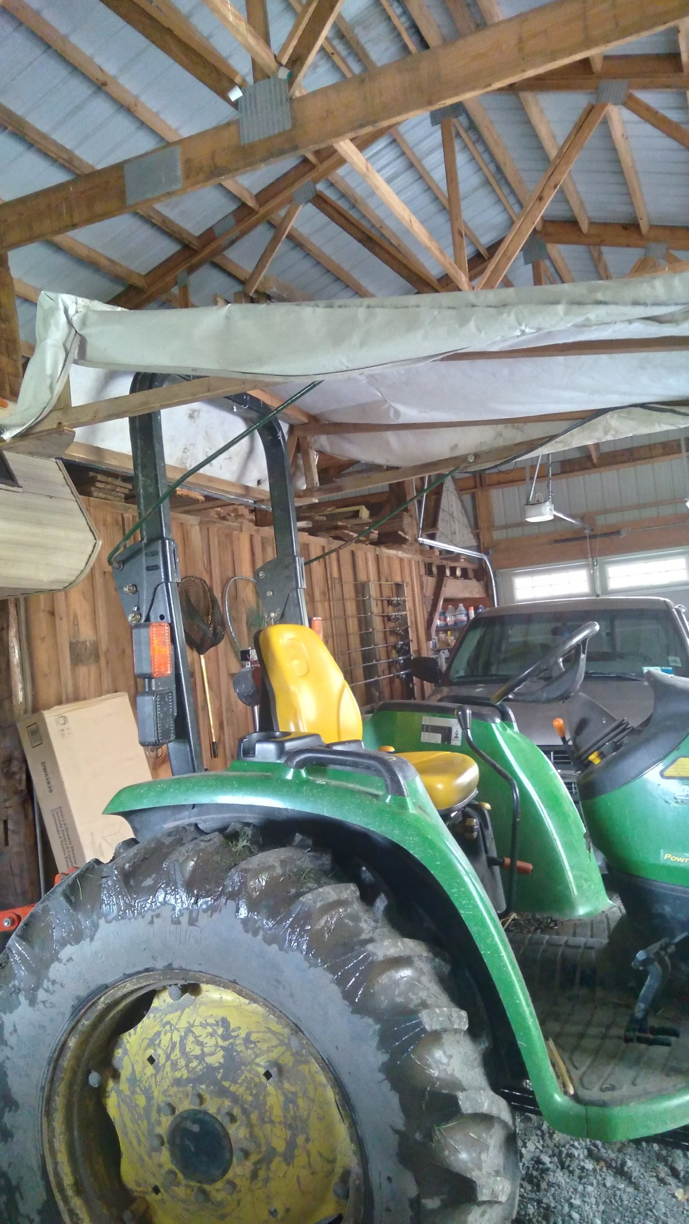

There are many reasons why I prefer a canopy, with the chief one being cost. A close second is the fact that I enjoy my time outside mostly because my full time job is inside a factory. Other advantages of a canopy is increased stability due to lower center of gravity, lower maintenance cost, and increased fuel economy. Also does not cover up abnormal operation noises from equipment. When you add all that up, you couldn't pay me to own a tractor with a cab.
That said, you also couldn't pay me to work on a tractor in the hot sun or rain, without a canopy. This is the one I spent a couple hours making for my JD 4120 back in 2005, when it was new. It has held up well for 16 years, although I did replace the canvas top when the old one (made from an old boat cover I got for $5 at a garage sale), got a tear in it.
My brother in law was scrapping his tent camper and some canvas from that made a perfect replacement cover for my canopy. The frame is made from 1-1/2" square pine and a couple 2x4's. It attaches with (2) 3/8" bolts drilled thru the top of the rops, and two metal diagonal supports (cut from an old fertilizer spreader handle), attached to the rops folding brackets with (2) 5/16" bolts.
The whole assembly weighs about 35 pounds and can easily be lifted into place with one hand.
The effectiveness of a canopy in the hot sun really has to be experienced to comprehend. The motion of the tractor, coupled with the shade from the canopy, makes for comfort, even on extremely hot, dead-calm days. So much better than being locked in a glass box waiting for your air conditioner to cool you down.

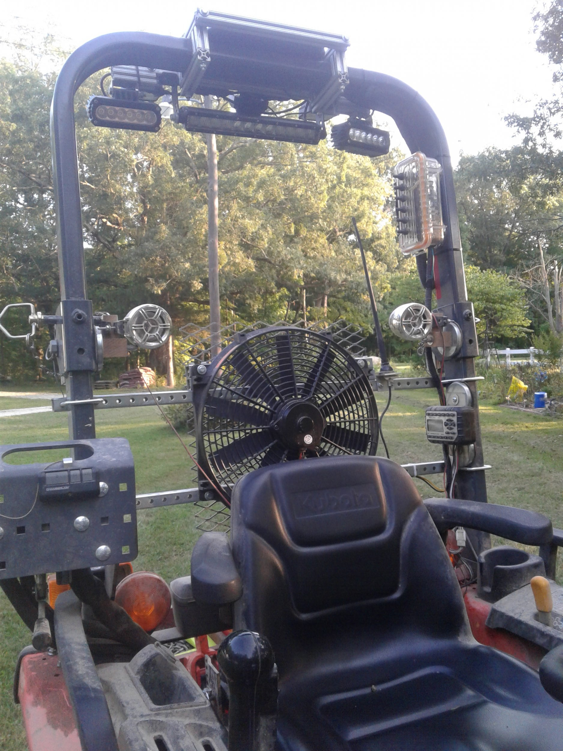

Yep better than nothing...in heat of summer maybe fan blowing on your back side would help.

That sounds like the one my prior tractor (Ford 2110) had on it. I busted the corners up on that one a little, using the tractor in the woods. It was very large and heavy but did a decent job of blocking the sun.
I vastly improved on that one with the one that I made for the John Deere. I made it about the same size overall, but deeper. That let's it do a better job of blocking the sun when it is not directly ovehead. Mine is also wider over the operator, but tapers towards the front, so that it does not snag branches easily in the woods.
The biggest superiority of my homemade canopy is it's light weight and ease of attachment. If I want to take it off, so that I can fold down the rops to fit in a standard sized garage door, I can do it in under a minute.
I used to park the Ford 2110 for the winter because my older, non-rops Ford 8n fit in my standard garage doors but the 2110 did not. It also lacked a block heater and refused to start without either when the temp was below 45 degrees F.
By contrast, my 4wd, JD 4120, with the canopy removed and the rops folded down, with a block heater and loaded R-1 tires, is far and away the best piece of snow removal equipment that I have ever owned or operated.
