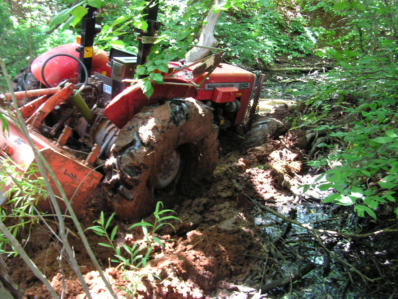

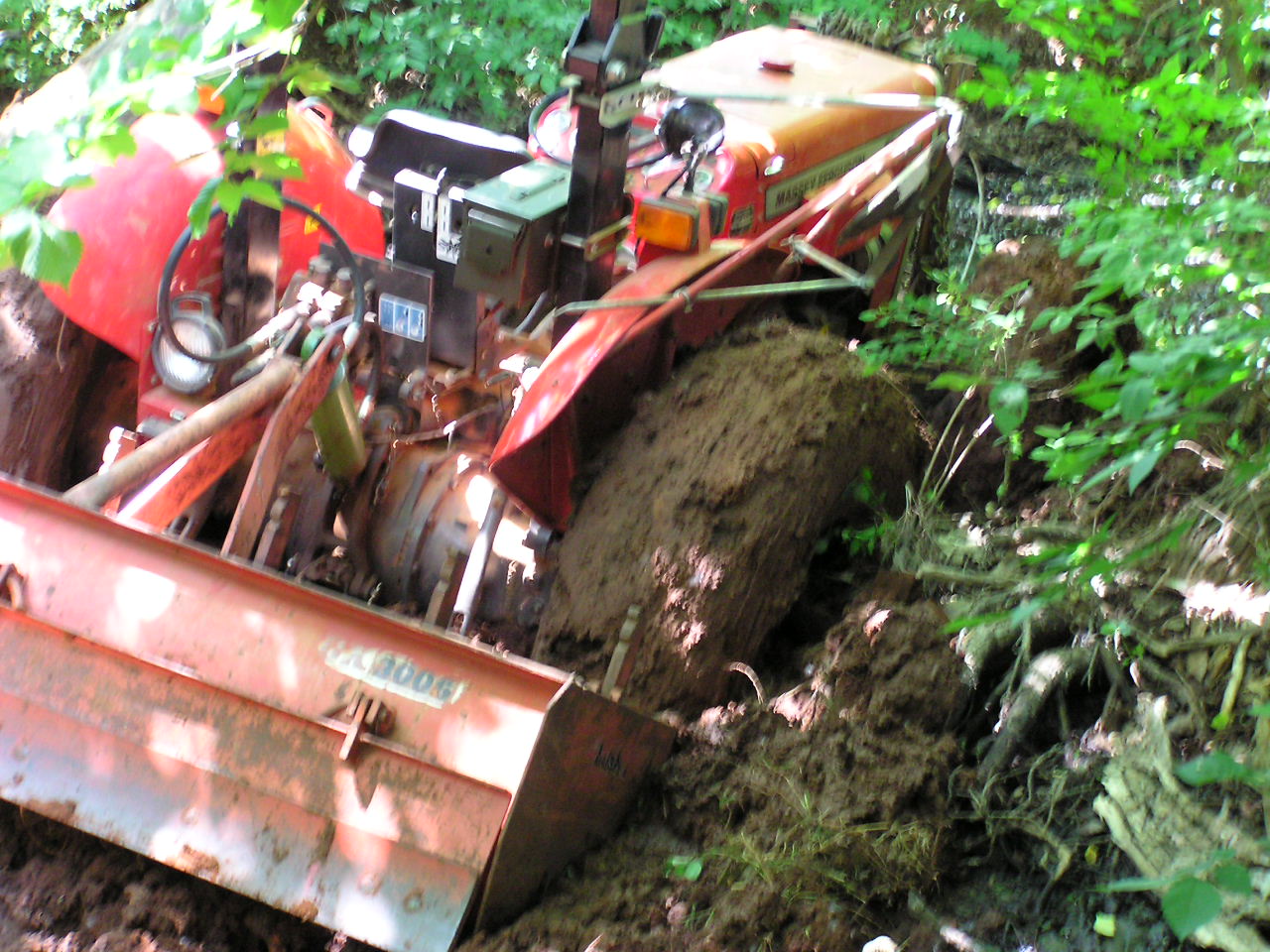

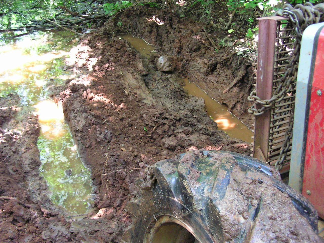

@KennyG
If you're sunk at both ends with a 3PH attachment on, it seems to be pretty standard operating procedure to have to remove it in order to unstick yourself. Unless of course, you have a 100 ft electric or hydraulic winch on the 3Pt.
/ It really does work #7
@KennyG
Or on a receiver hitch on the front of your truck. :D
From 10 years ago, when I had a tractor.
