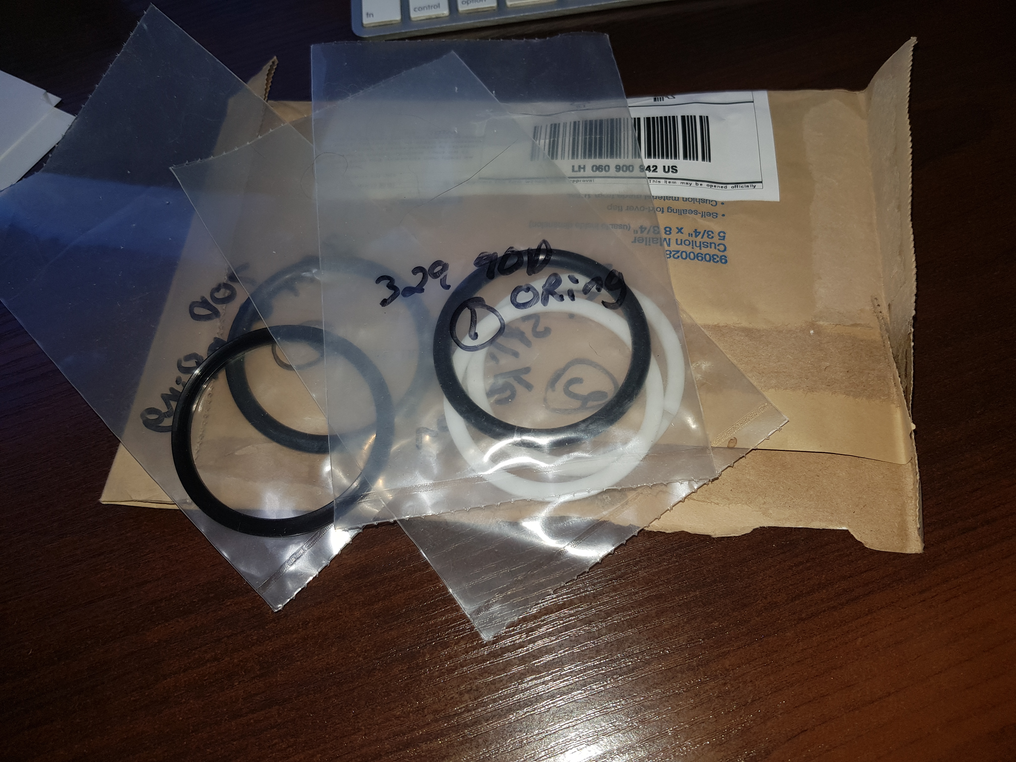

Hi Marcel,
I mailed the o-rings yesterday 3/2/2019. That was the first chance
I had to make it to the post office before they closed.
The fellow at the post office said it will take up to
10 days for package to get to Poland. He also said
after they get to Poland he didn't know how long
it would take for the package to be delivered to you.
So let me know if you get them. Also, I used the white
split teflon back up rings and a 70D o-ring in my tractor.
But just for the heck of it I also put a rubber backup
ring in the package as well. I felt that the rubber backup
ring would not hold the main o-ring in the groove. The backup ring
is in there to keep the main rubber o-ring from being
squeezed out of the groove under pressure.

Hi Don, miracles do happen. The parcel already arrived in good state :)
I'm really happy, now waiting for my little iseki to return from getting a FEL installed, then i will open things up again.
once again thanks, really appreciate it.

   / Iseki tx1500 name of lifting arms part? #57
I just checked the container of Iseki stuff and I have the
o-rings for the 3 point piston. I have one o-ring that
is 90 durometer and one that is 70 durometer. The 70 is
softer than the 90 and I used the 70 durometer in
mine. I also have 2 of the split teflon backup rings.
I used 2 of the Teflon backup rings and one of the
rubber o-rings on my piston.
I will mail the 2 Teflon backup rings and the 2
rubber o-rings. You can decide which rubber o-ring
you want to use.

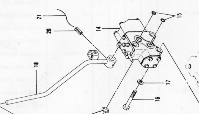

I have to bring this subject back to life. My hydraulics on the tx1500 have given up. Pump is working, all seals and o-rings are new and ok, oil is new.
So it can only be this valve assy. But with all manuals i have, i cannot find anything on the inside of this thing. Does anybody have any better diagram that the one i found on this part?
