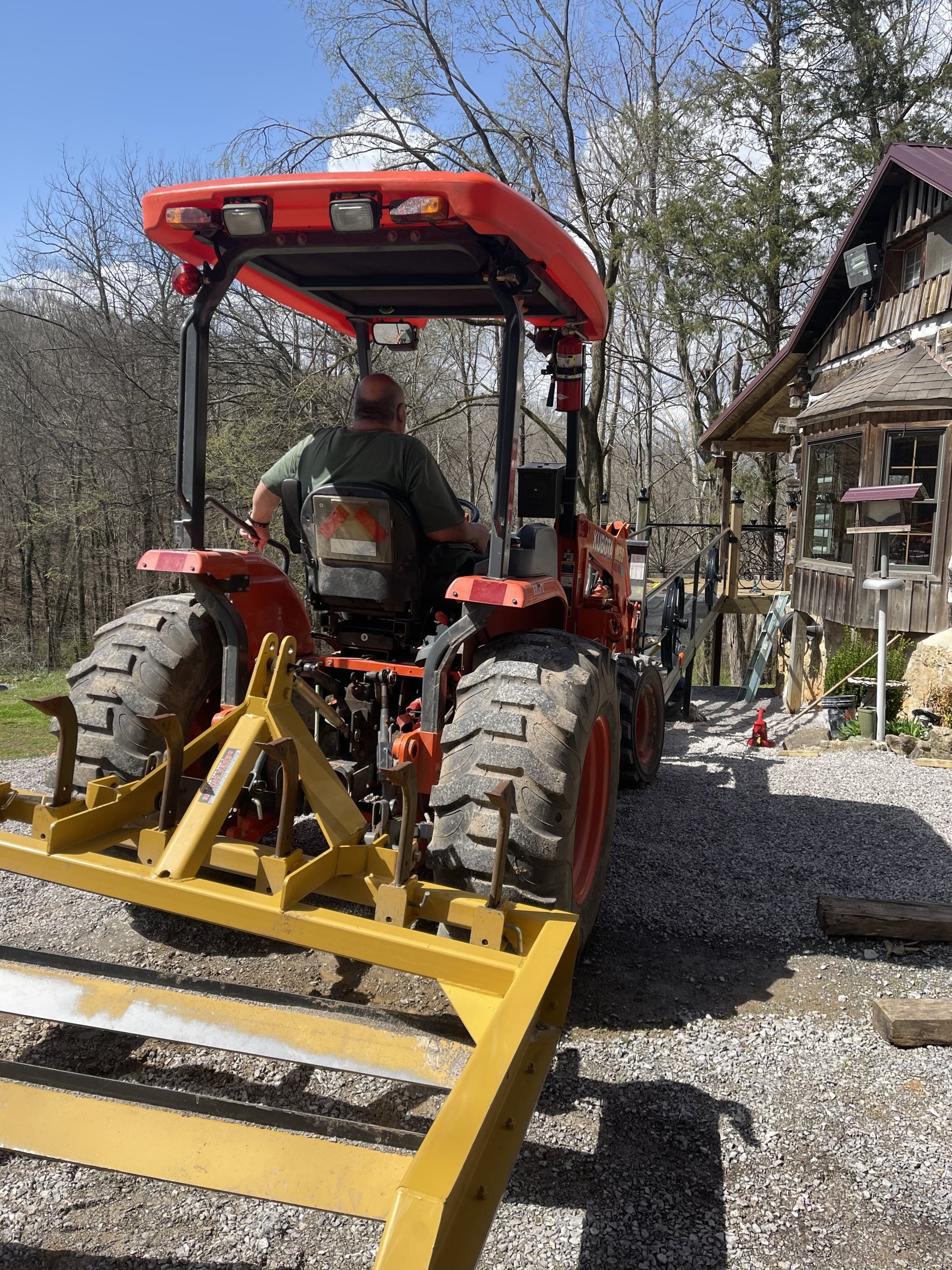

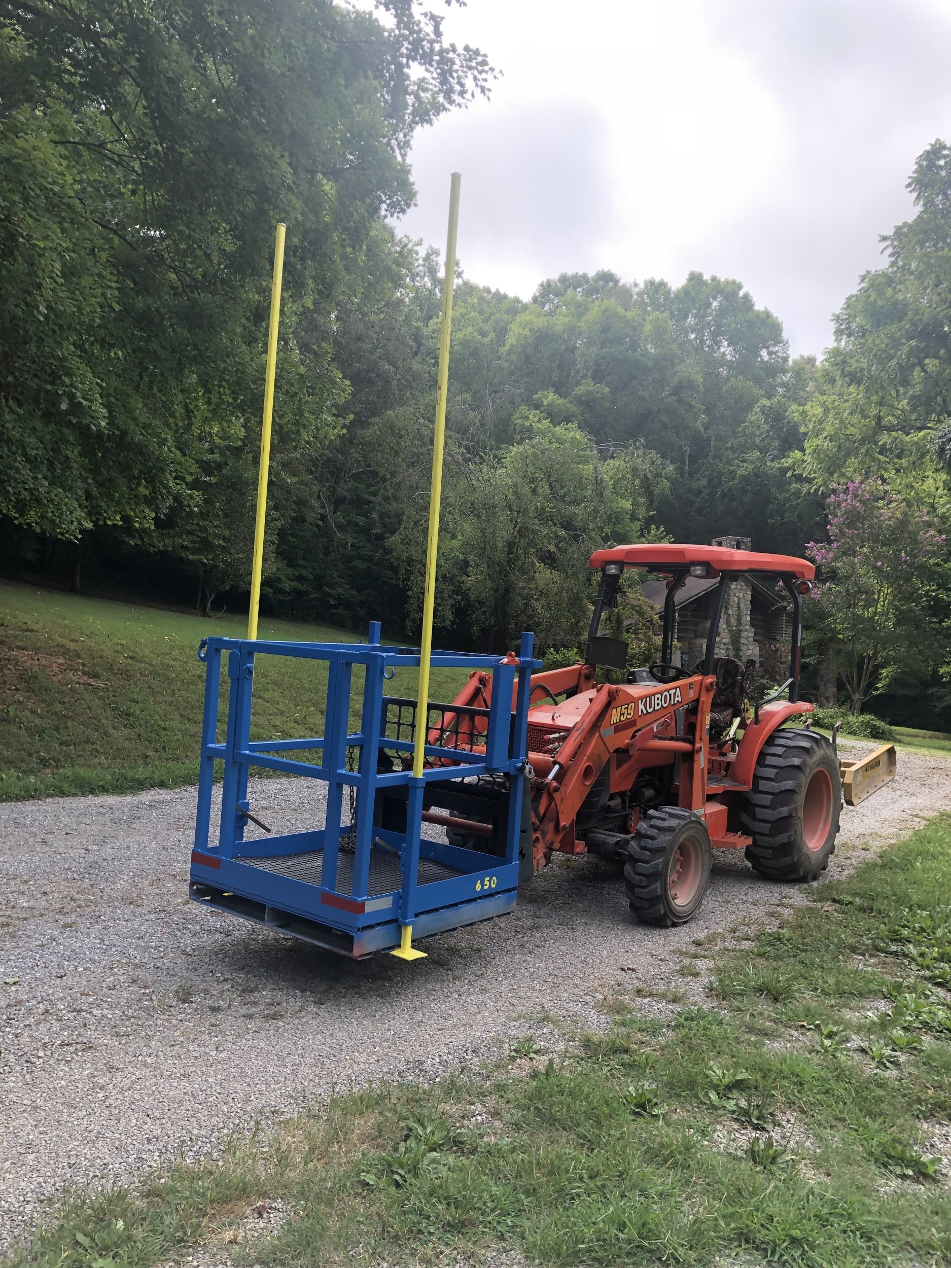

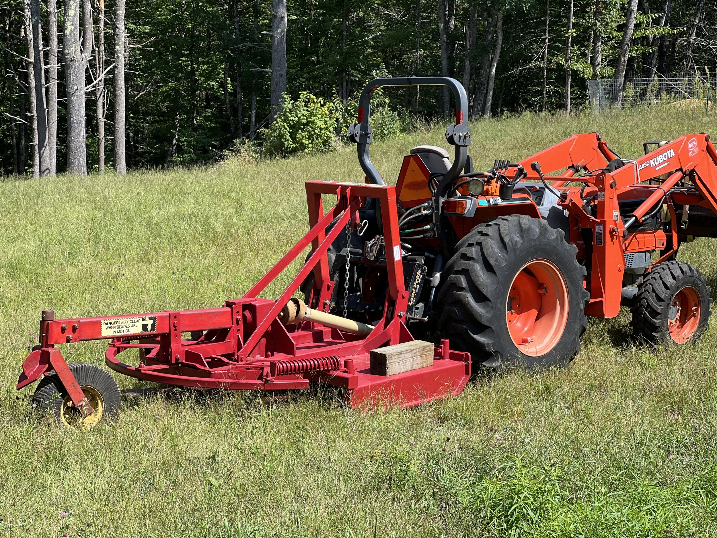

Both our B26 and M59 spend 80% of their time in 3pt mode. Top n tilt and remotes from Brian would be nice. Great for grade work but do have concerns about drift when mowing/bushhoging. Have gotten pretty adapt about changing from backhoe to 3pt but weight of M59 arms is near my limit. Not sure how much weight the tilt cylinder would add.
Do wonder if the backhoe connections could be used in 3pt mode to provide flow to a remote valve block? Like to control cylinders on a pto stump grinder or ditch bank mower? Said attachments often have their own mountable valves powered by a remote circuit.

SmokeyDog, thanks for the great pictures! I doubt I'll ever mount my M59 3pt kit. Glad to have it as an option, but it is really heavy. Easier to just use the JD.
When we got the M59 it was one of the first ones sold and at that time the 3pt kit was included as a "factory bundle" along with several other extras.

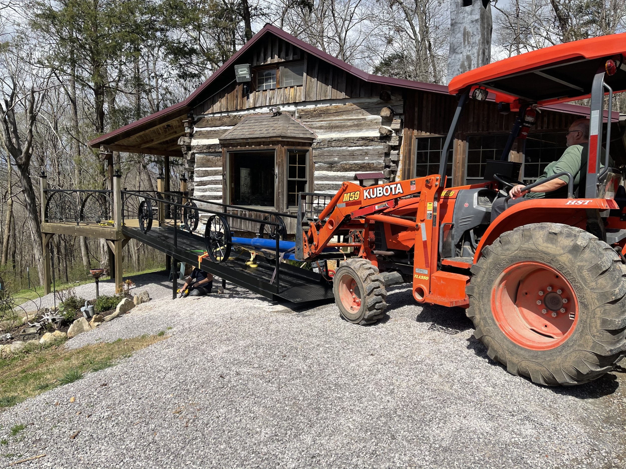

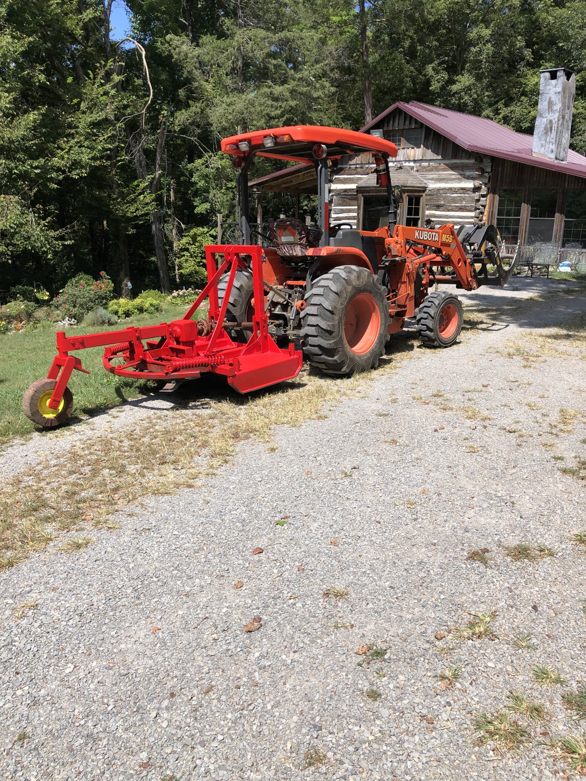

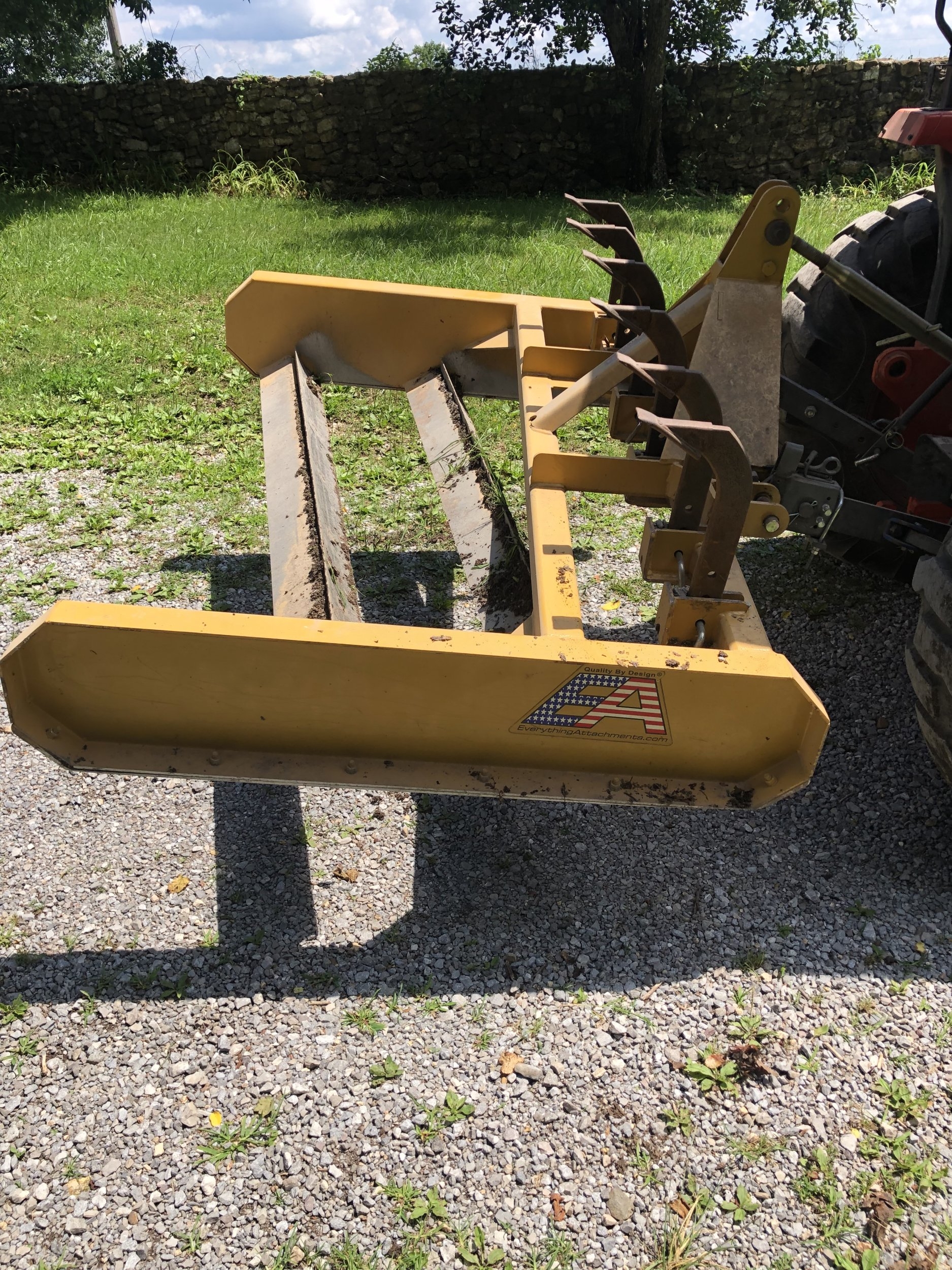

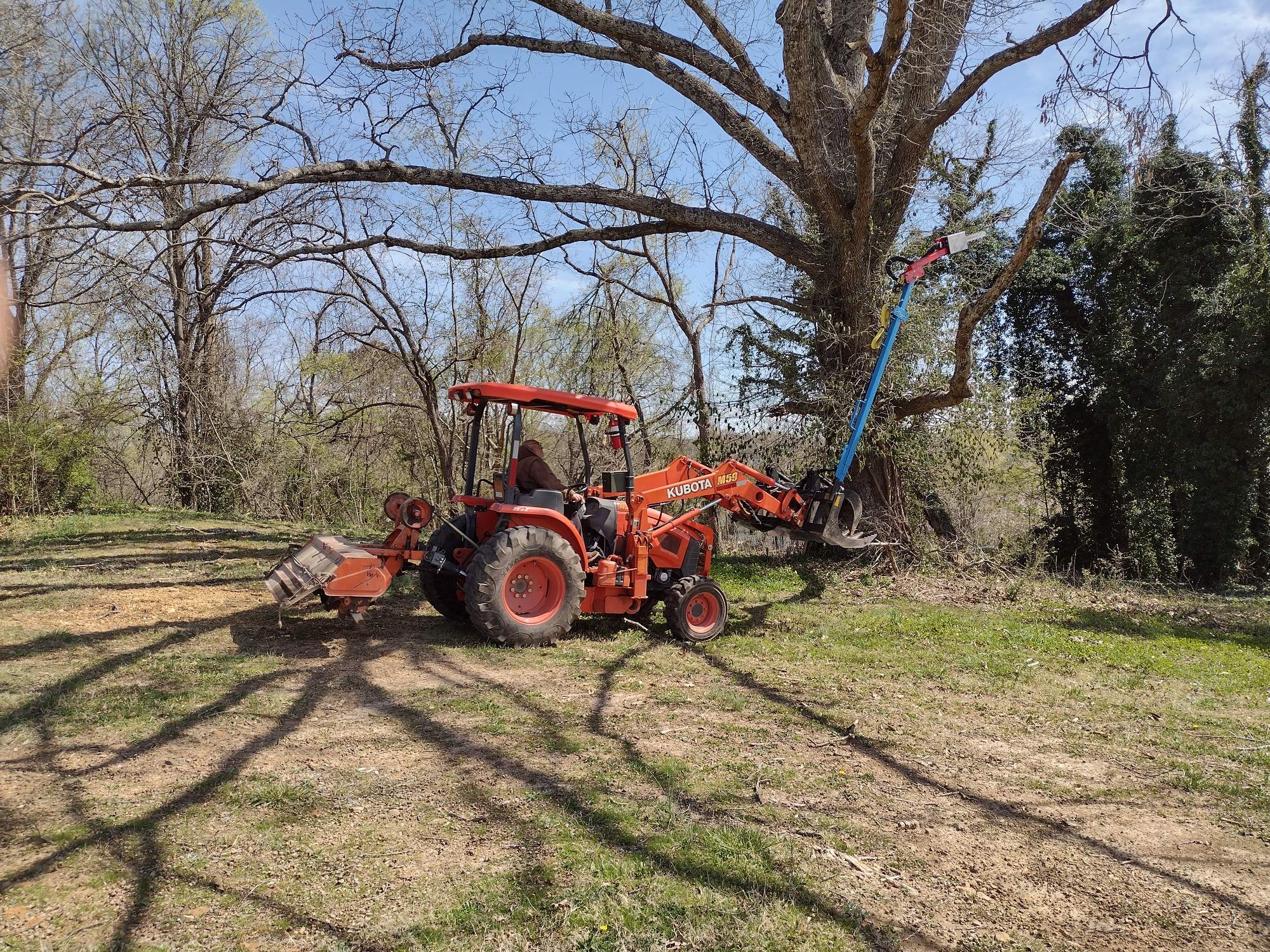

View attachment 841660View attachment 841661View attachment 841662View attachment 841663View attachment 841664View attachment 841665Both our B26 and M59 spend 80% of their time in 3pt mode. Top n tilt and remotes from Brian would be nice. Great for grade work but do have concerns about drift when mowing/bushhoging. Have gotten pretty adapt about changing from backhoe to 3pt but weight of M59 arms is near my limit. Not sure how much weight the tilt cylinder would add.
Not sure about the whistle cause. Keep us posted.
Great photos! Especially the Brown Tree Cutter! It looks like a 5', hows the machine handle it? I just sold my 6' model, it was way too much for my little tractor.

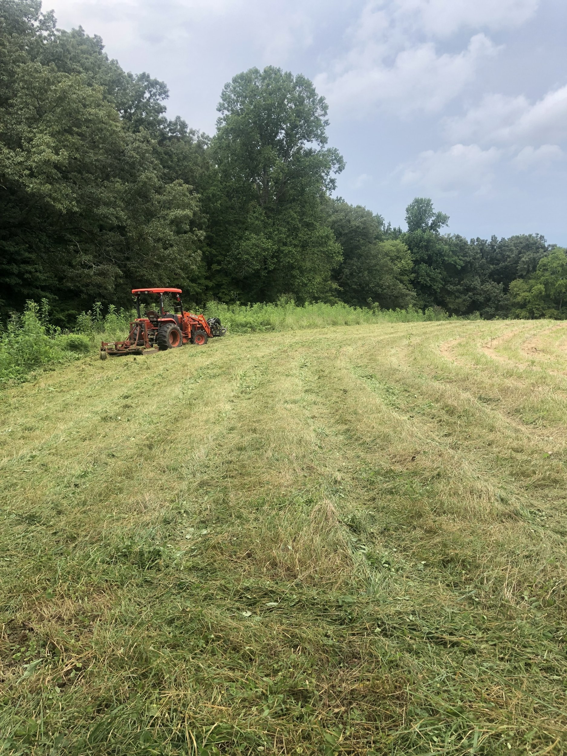

Just at the minimum pto hp for the 5’ Brown cutter. HST and heavy built m59 helps manage its use. Been very handy clearing larger under growth around wooded perimeters and roads.

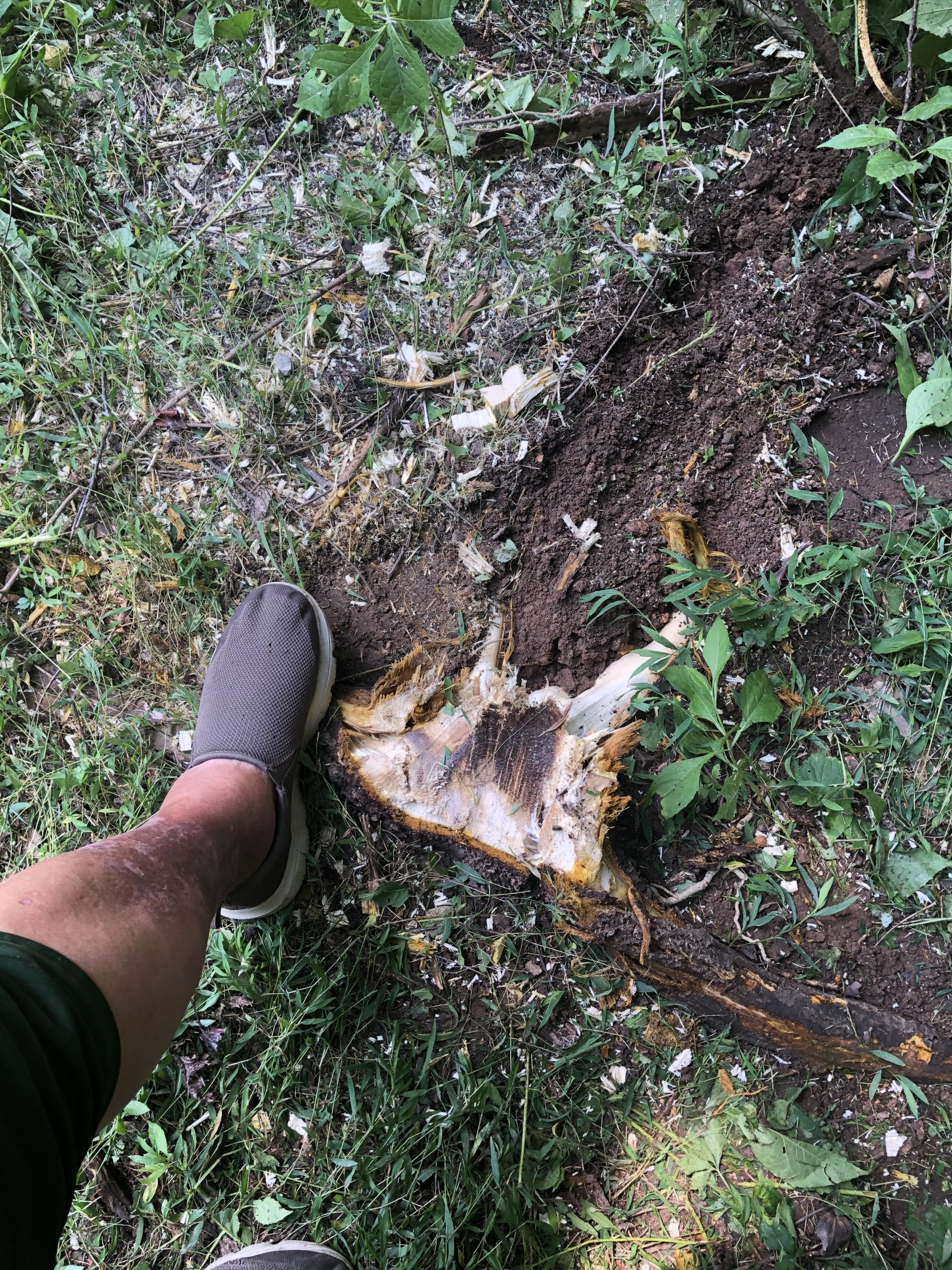

Black walnut stump compared size 13 shoe. Works much better on <6” trees with the M59. It’s like a drive over chainsaw, flush cut stump grinder and brush chipper except much faster.
Mowed off the now fallow pastures last year with the Brown cutter as a test. Takes about the same time and hp as a 6’ rotary cutter. Be interesting if topNtilt could improve cut?
Not really. When I'm using a rotary cutter I set the tilt so the cutter is level with the tractor's rear axle so it follows the terrain as I drive. My rotary cutter's hitch allows the cutter to pivot up and down to follow dips and hills as I'm cutting. So the top cylinder position doesn't have any effect as long as it keep the mower's linkage from fully extending or bottoming.
