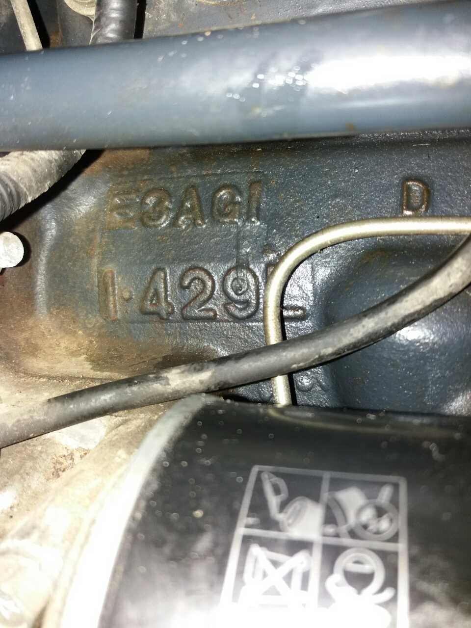

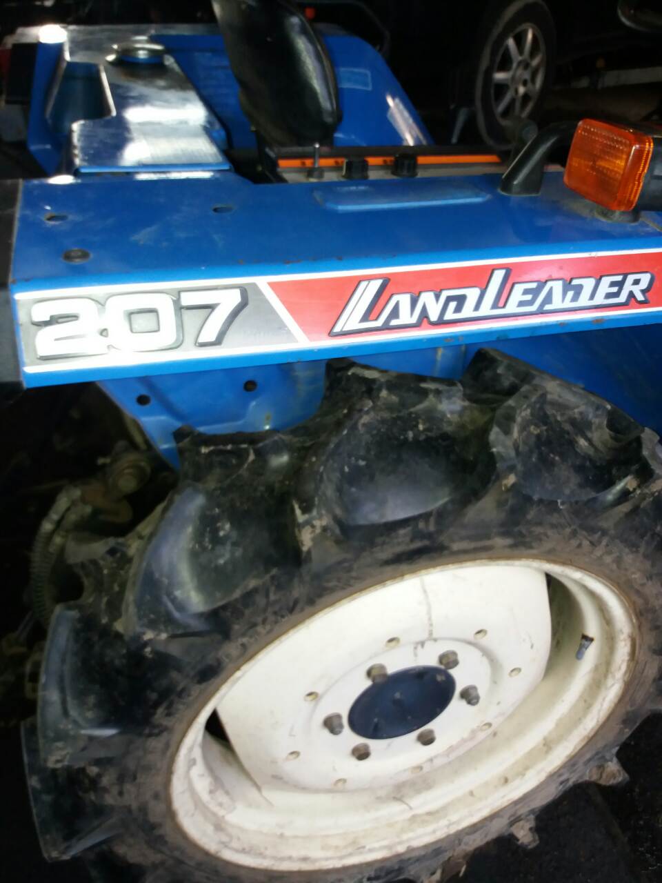

Hello everyone,
I'm quite new to this whole tractor business and, therefore, not too educated about their engines, specially the old ones. I have an Iseki Landleader 207 (TA207) tractor with an E3AG1 Engine (1.429L 3cyl diesel), which has 3 bent connecting rods due to a recent accident.

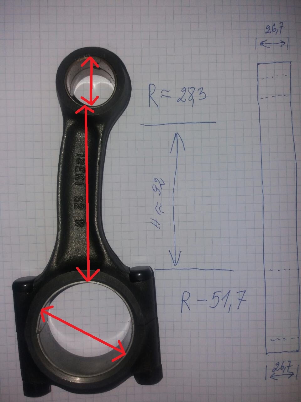

So far, my luck trying to find replacement connecting rods has been vague :thumbdown: . Therefore, I come here asking you all whether anyone has experience with this sort of thing?
Do connecting rods from other engines / other manufacturers fit my E3AG1 ?
Should I purchase 3 whole new rods or only 1 and give it to a professional workshop as an example to straighten out the bent ones? Or can I simply find the original blueprints and measurements of the engine parts?
Would a connecting rod from, let's say, a similar 1.5 litre engine fit my engine?
Any ideas where should I continue my search?
Anything helps! If you need any other details, ask away!
I'm not a native English speaker, so pardon for any mistakes.
Here are the approximate measurements of the connecting rod (this one is in best shape) : forumas.jpg

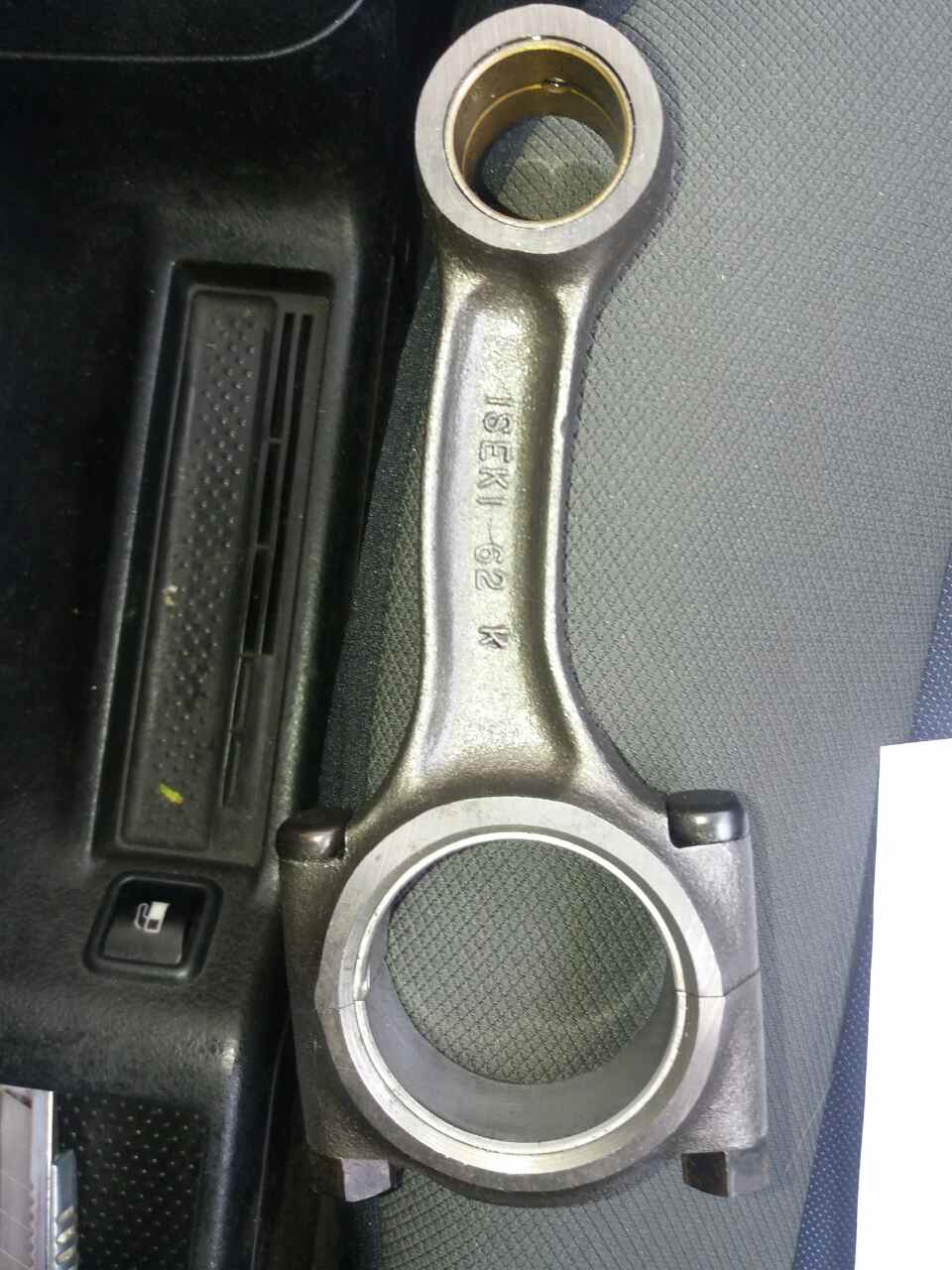

I had one bent rod in a KE70 engine that was found upon rebuilding. I ended up bending it back in a large shop press and it seems to be working fine. Not necessarily a "best-practices" approach and you won't get it perfect but something to consider especially when replacements are apparently hard to source and you should be able to get close enough. However, the rod I had was only about half as bent as the one you have shown. I was worried the bearing ends of the rod would deform upon re-bending as this is what was pressed against but I didn't observe any. If you try this you might want to put the piston pin in just to help prevent the issue.

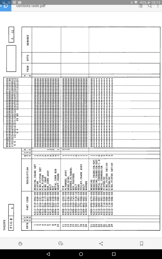

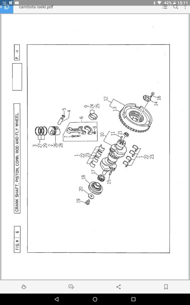

Here is the original file of the iseki TA 525 which has a motor equal to yours, you can go to an Iseki dealer and ask the number 6
