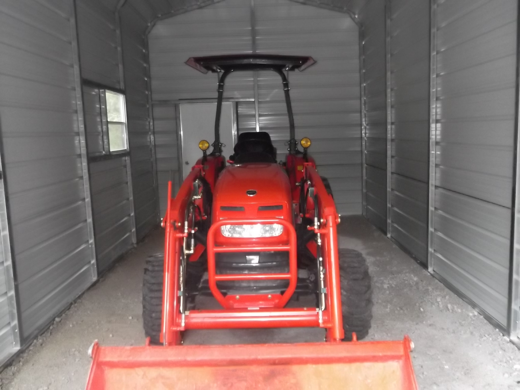

I am just glad that I now have a building that has a 9 ft door so that my ROPS/Canopy stays up all the time. In the previous building and previous tractor, I put down the ROPS to put it away, and put it up when it came out. Yes it was tiresome at times, to keep doing that, but I live on very hilly ground, and while I have never turned a tractor, over, I do have brains enough to know it is possible to do..
I have seen plenty of pictures of others here that have done just that. And for every picture posted, of a turned over tractor, I bet there are 10 that are too embarrassed to post a picture like that.
So now I have my ROPS, and my steel/insulated canopy, And it is ready to go the second I drive it out of the door. The canopy is not as good as a cab, but it is one heck of a lot better than the sun cooking your brains and body. As for what others do, They can do as they please as far as I am concerned. :)
