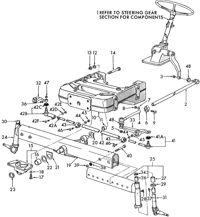

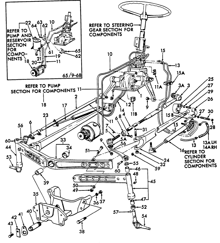

As has been mentioned.. the axle style is the clencher.
I'm attaching a pic of the 2 styles being talked about. it would be helpfull if the original poster would refer to the 2 pics to see if he is looking at the axle with radius rods or not.

Is the front end setup on the right too weak for a loader? I believe that is the one on the front of my "new to me" 4000 but was hoping to put a loader on it. Mainly for movng 20 rounds a year and scooping a little dirt.
/ Is Ford 4000 strong enough? #13
the one on the right is the old style light duty radius rod setup started in 1939 and carried thru 75 on 4000 su and under. the regular post 65 ag 4000 has the left axle.
still many fords have loaders using the lighter duty axle. it's not as ideal.. but it works..
