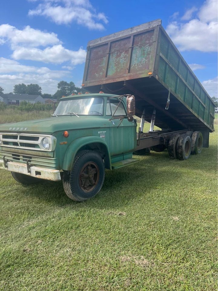

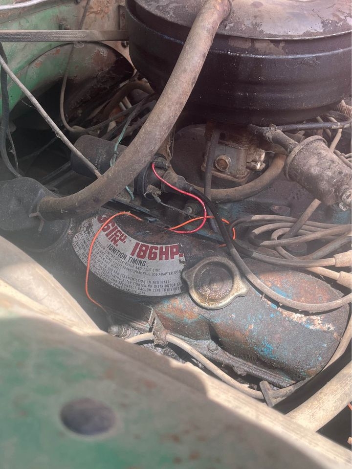

I just ran across this truck on FB Marketplace.
Look at this tandem axle dump truck. Pretty big, huh? Probably carries 15+ tons, right?
Here’s what powered this truck back in the early 70’s.
A 186 Horsepower gas engine.
Now I don’t mind extra power in a truck, but this tandem axle dump truck, still running today and available for sale, managed to get the job done with 186 gasoline-powered horsepower.
Who on earth needs 400+ horsepower and 1,000+ ft lbs of torque In a pickup truck?
When the power ratings began to exceed 300HP/800TQ, it became really obvious this is all bragging rights.
I can tow 18 tons with my 360HP/850TQ Ram. Nobody needs 400+HP.
Nobody
Nobody
Nobody
Nobody
Hey, with the right gearing I could pull that truck with my riding mower.
But just like that truck when it was on the road, you sure as heck did not want to be behind it going down the road.
We had those trucks when I worked on an AF Base back in the mid-'70's. I don't know why the military had to pay for ordinance. All they had to do was drop those trucks on the enemy. Same thing...bombs.
