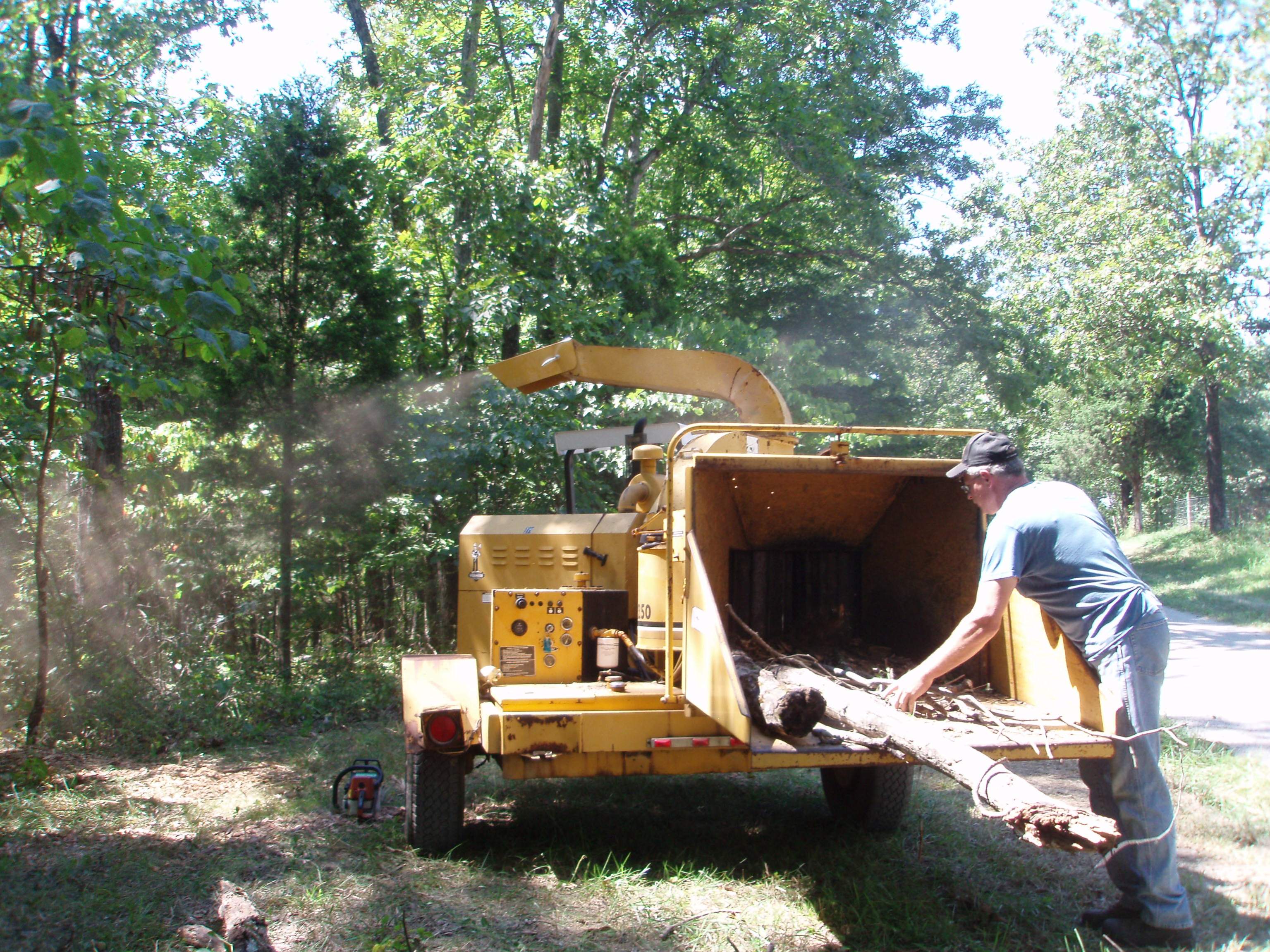

This is what I use , will keep two people busy feeding it .

Notice that he is standing to the side of the feed hopper. The hydraulic feed rollers sometimes violently whip material around as it goes into the machine. Standing to the side minimizes the chance of getting whacked, plus he can quickly push the reverse bar with his right.
I can't tell if he has safety glasses on, I assume so. I also wear hearing protection, a hard hat and gloves.
