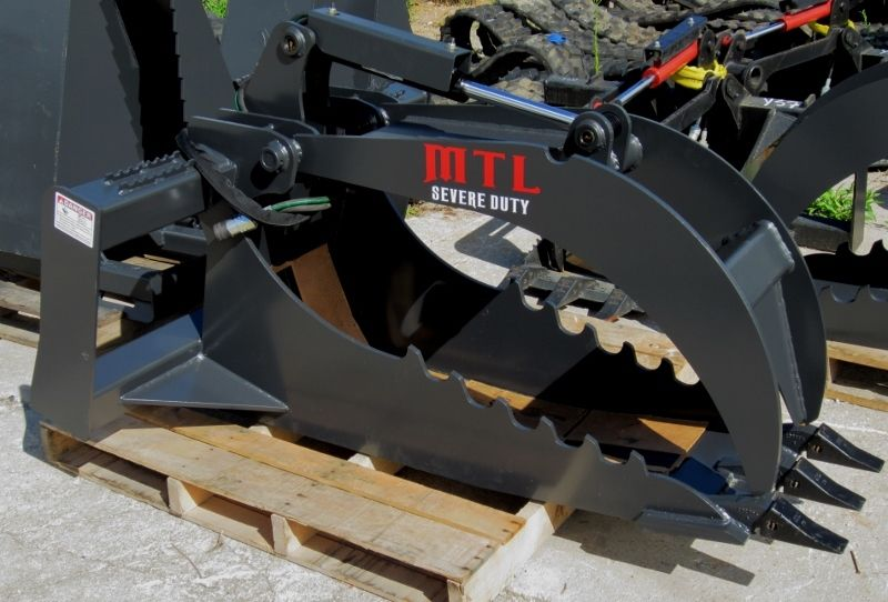

Hey y'all. I'm getting my list of must have attachments together and I'm trying to not have a stump bucket and a grapple. My place is a fire managed pine stand so there is less brush and more stumps but obviously still some brush. The question is, am I asking too much of a stump bucket grapple to clear and stack brush on the slash pile?

I’m sure it would pick up a dead fall tree trunk fine but brush tends to get broken up in a lot of pieces. It’s going to be junk for raking up and moving little pieces.

Xfaxman - are those stump bucket grapples designed for subcompact tractors or a unit like your Bobcat V417? Those might put a healthy strain on the subcompact FEL and hydraulics. Just asking.....
/ Is A Stump Bucket Grapple A Capable Brush Handler? #7
I find my root rake is handy when used as a dozer to push libs into a pile and grab the whole pile in one shot. Stump buckets are narrow and would be better at grabbing onsies-twosies i.e. grab "a" log or grap "a" root ball. A root bucket grapple wouldn't work for me and what I do.

Mossy... What I did because I needed a grapple to move brush and limbs to the burn pile, is I added a grapple to the top of one of my FEL buckets, the upper section only. I did it so it's removable via 2 pins so it I want it off. it's an easy matter to remove it. Works very well for sequestering brush and limbs in the bucket.

Do a 'Goggle' search for add on grapples and they will come up. I've had mine for at least 7 years now and I believe I paid less than 500 bucks for it, delivery included. Like I said, I have it on one of my FEL buckets (I own more than one bucket) mounted on the top with a set of pi9ns so it's quickly removeable and you could weld ears on your pallet forks and mount one as well.
I fabbed up 4 ears drilled them for pins and welded them to the top of the bucket. Real easy modification.
You will need a 3rd function and hydraulic fittings out front to operate it however. Being the frugal person I am, I just ran a pair of hoses under the floor to the rear remotes and use the remotes to actuate the grapple. I have 3 sets of remotes on my tractors so no big deal. I did make it so I could remove the FEL and leave the hoses intact with a set of hydraulic fittings that break the hoses at the loader frame.

You can clear up a lot with a simple set of add on forks for your bucket. The add on grapple just helps you keep material from falling off while transporting material.
A dedicated grapple has the advantage of your being able to see through the gaps in the tines to see what's going on with what you are trying to move. You can't see through a tractor bucket.
There are different types of grapples and tooth configurations that have advantages and disadvantages to each style--clam shell vs long bottom, for example.
The issue with raking using the FEL is the potential for damaging loader cylinder rods, especially if they are fully extended when raking. IMO, a grapple is most safely used for moving already loose material--not trying to rake or push it loose using the FEL. The leeway for safety probably increases with the size of tractor, but I guess the temptation to go too far may increase as well.
If you are raking up pine straw, then I'd go with a rear rake on the three point hitch. It's possible to rake up some smaller sticks as well, but it's possible to break rear rake tines if they get hung on a stump or rock. The disadvantage of the rear rake is the material tends to bunch up and/or roll off making it harder to move it over a longer distance than using a grapple or bucket.
