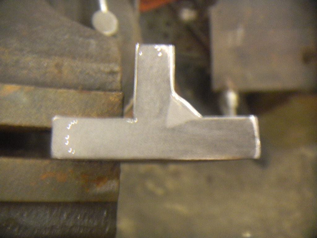

The mig is easer to pick up but I would learn on stick 6010 and 7018 both dig deeper then mig.
/ Interested in learning how to weld #25
Depends on who's running the Mig! ;)

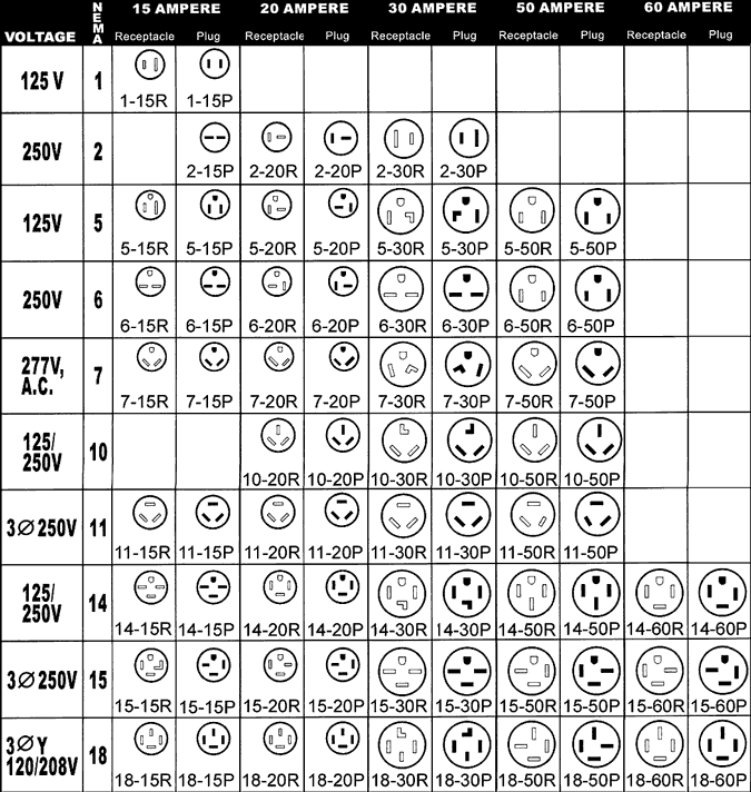

I've had a Miller Thunderbolt AC/DC stick welder for decades. They are old school and heavy but reliable and cheap. Around here they are on Craigslist all the time for $200 - $250 and can probably be bought for less. Good way to get started without using much money. As someone else pointed out, you will want a lot of clamps and jigs, good set up will save a lot of frustration.
Both my welders (Thunderbolt stick and Miller 211 MIG) use a NEMA 6-50P connector. 50 amps. See chart.
