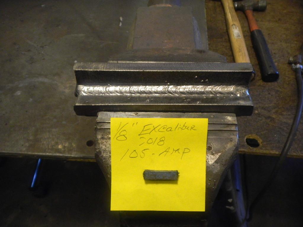

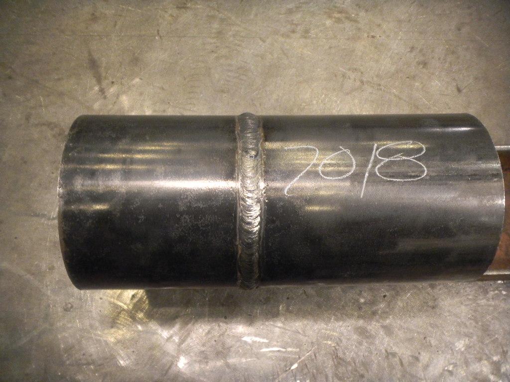

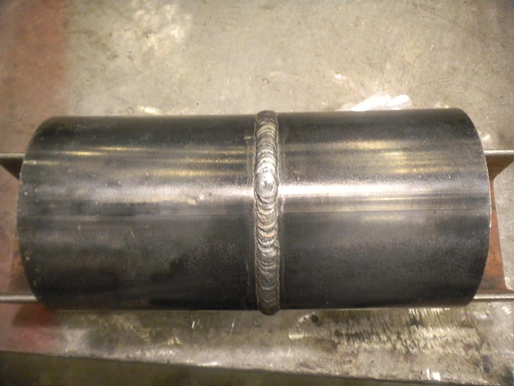

If you decide to go with a SMAW / stick welder. I switched welders with my brother-n-law, I have his Everlast PowerArc 200ST. This is a very impressive welder:cool:. You can contact Mark with Everlast to see what kind of deal he can make you.

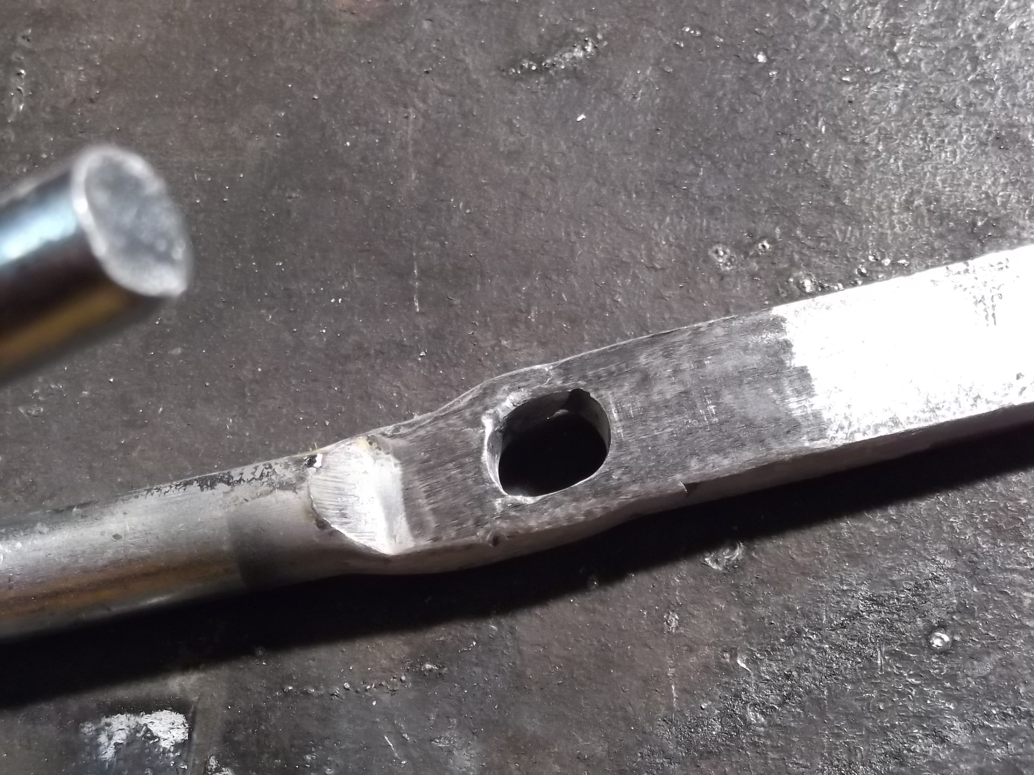

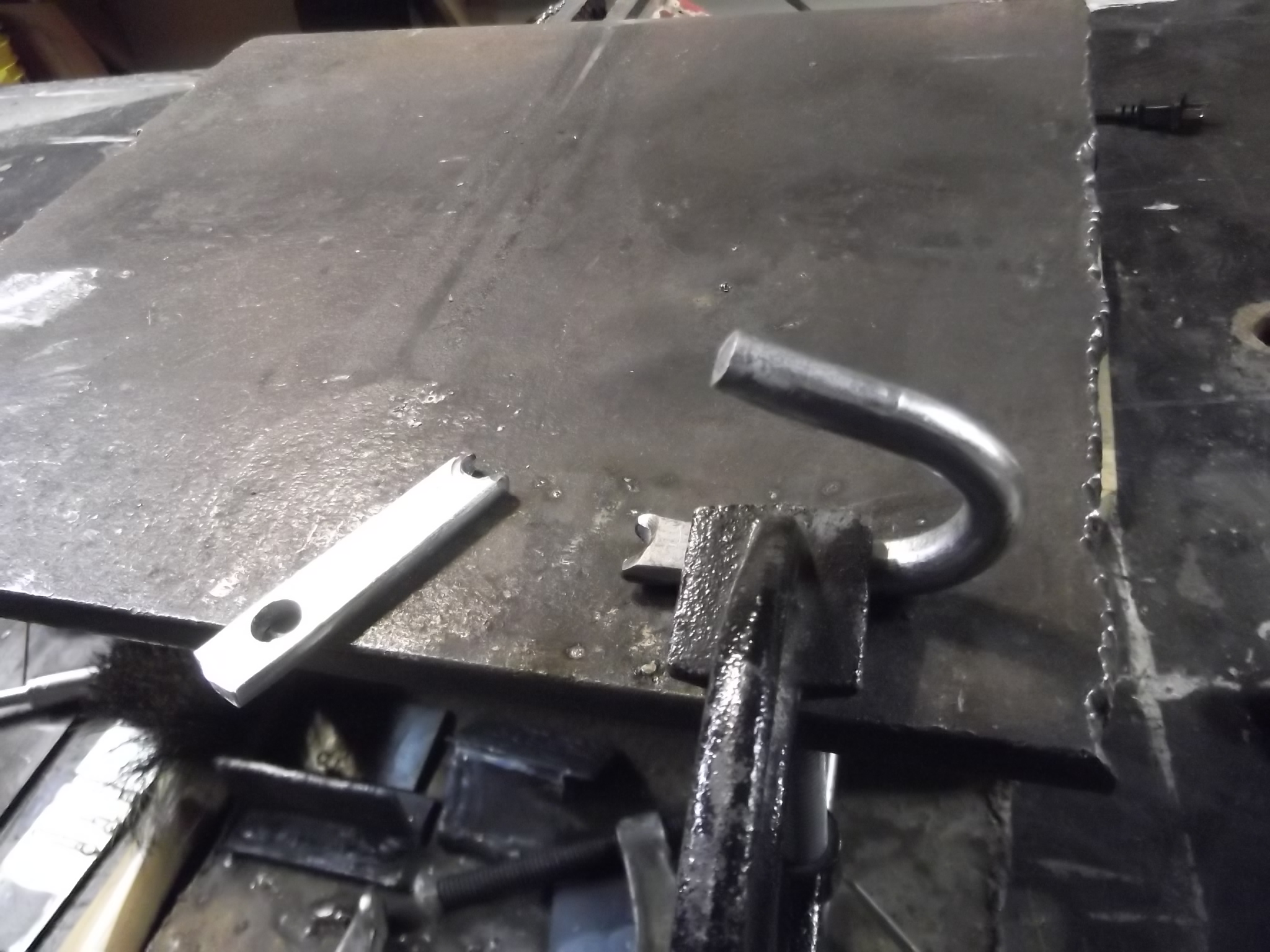

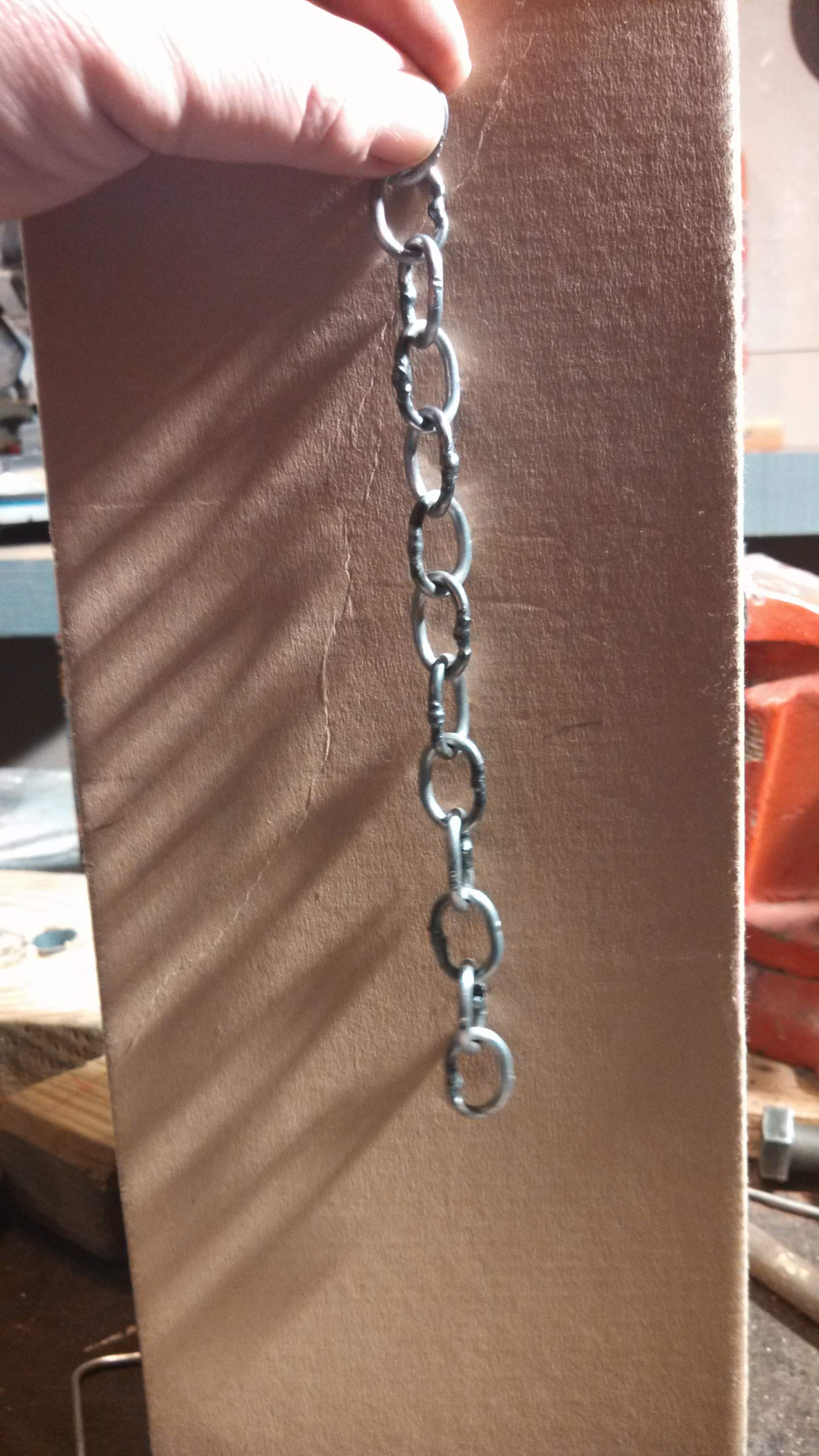

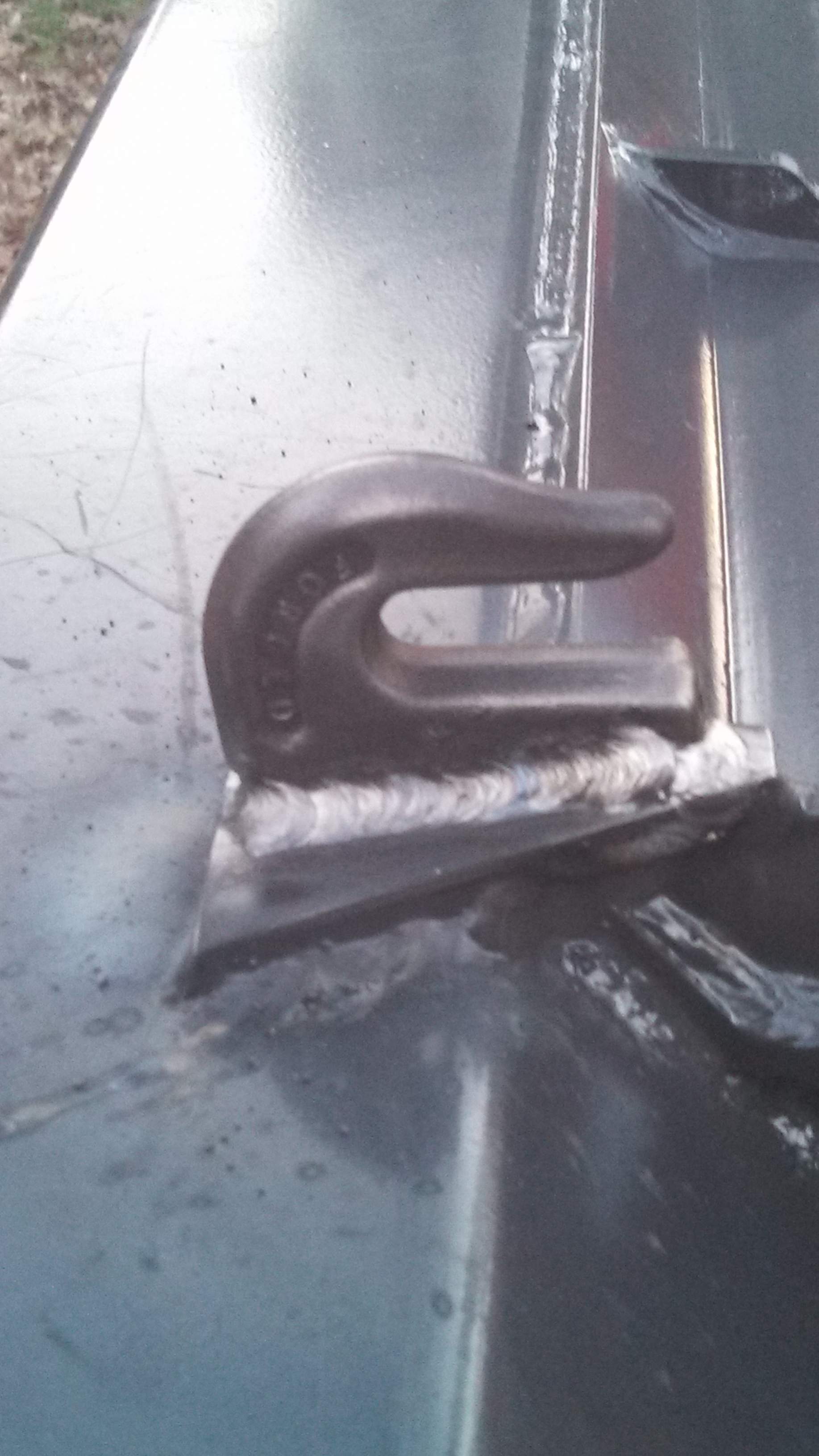

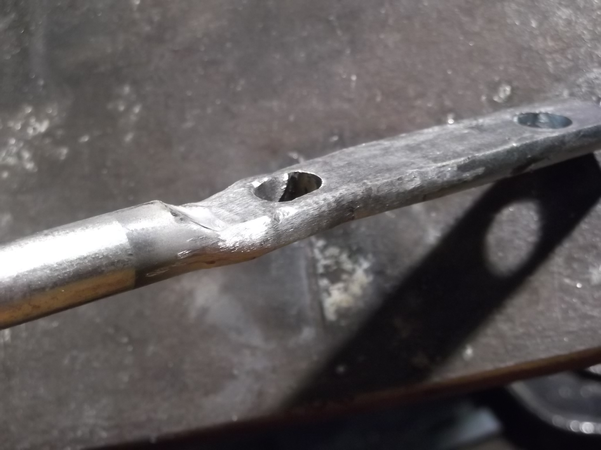

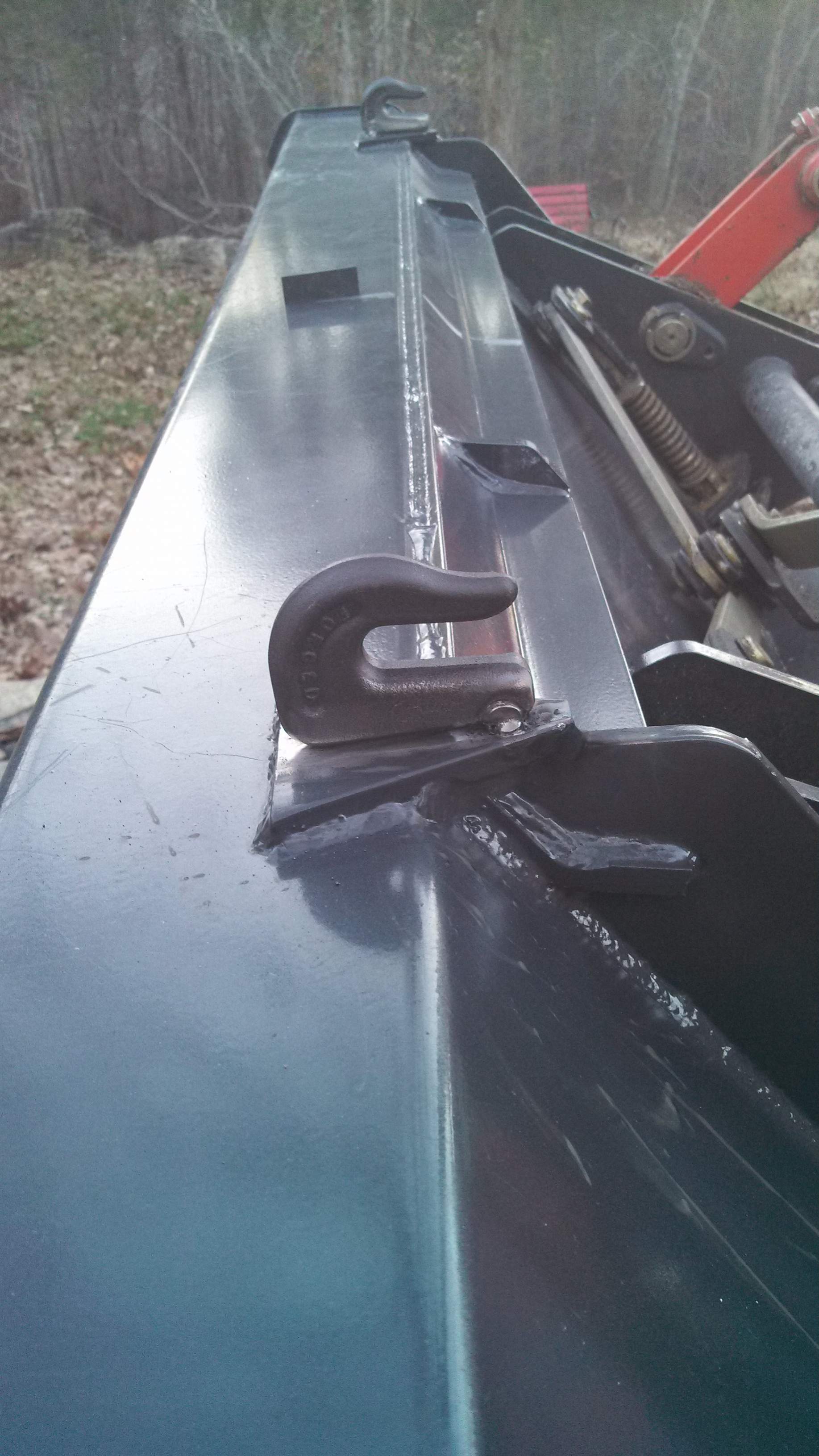

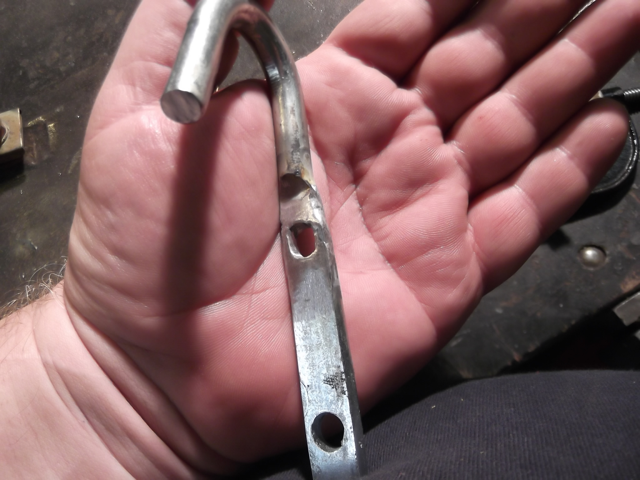

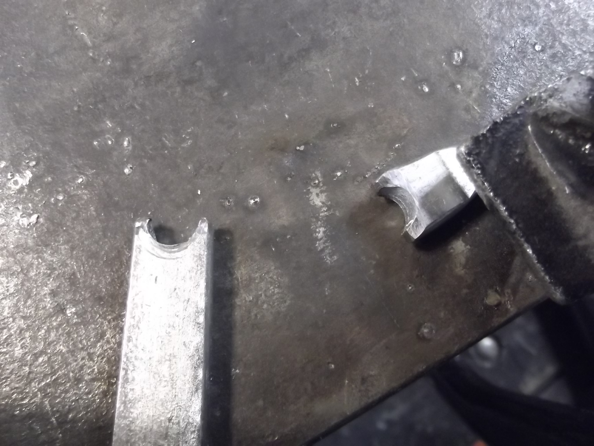

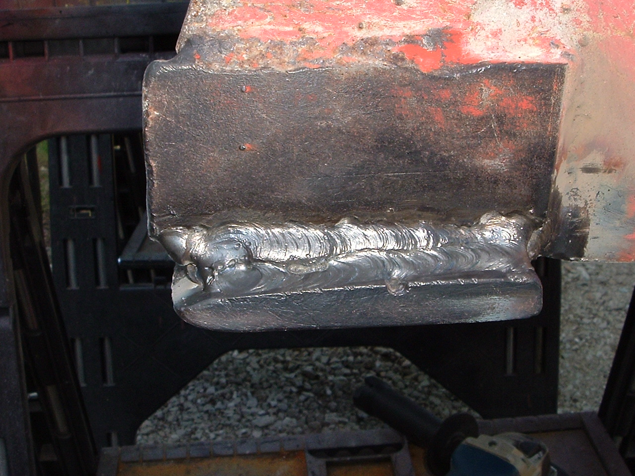

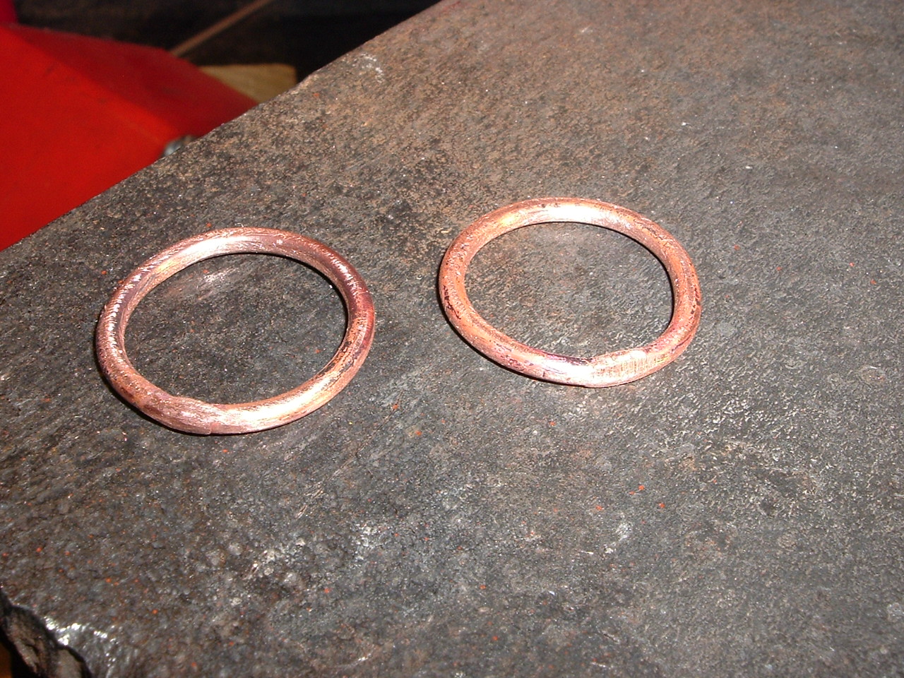

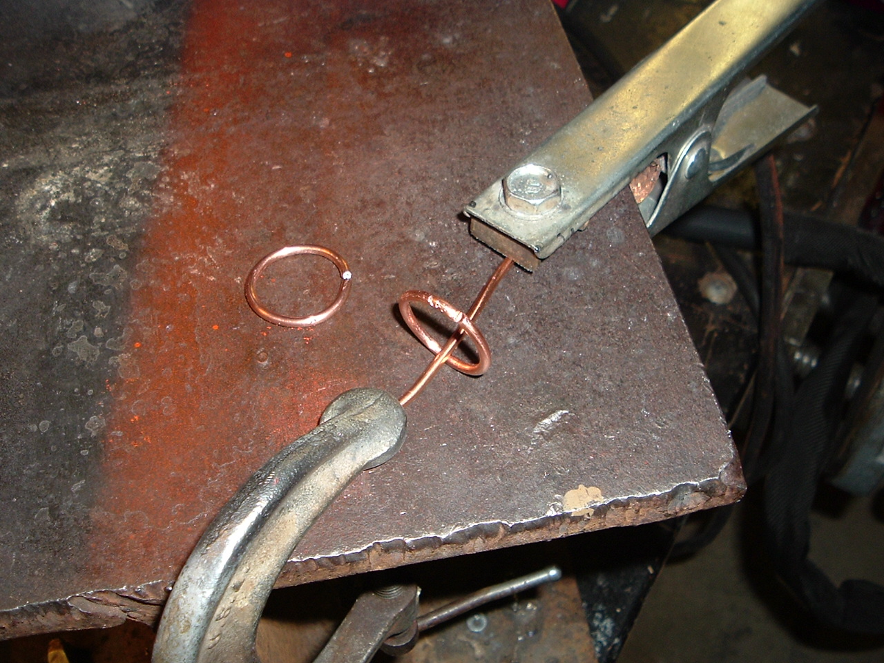

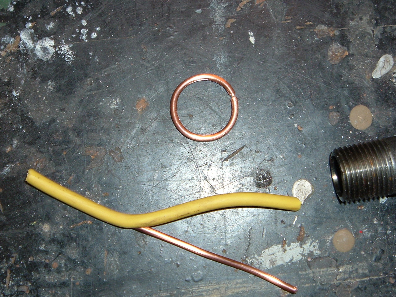

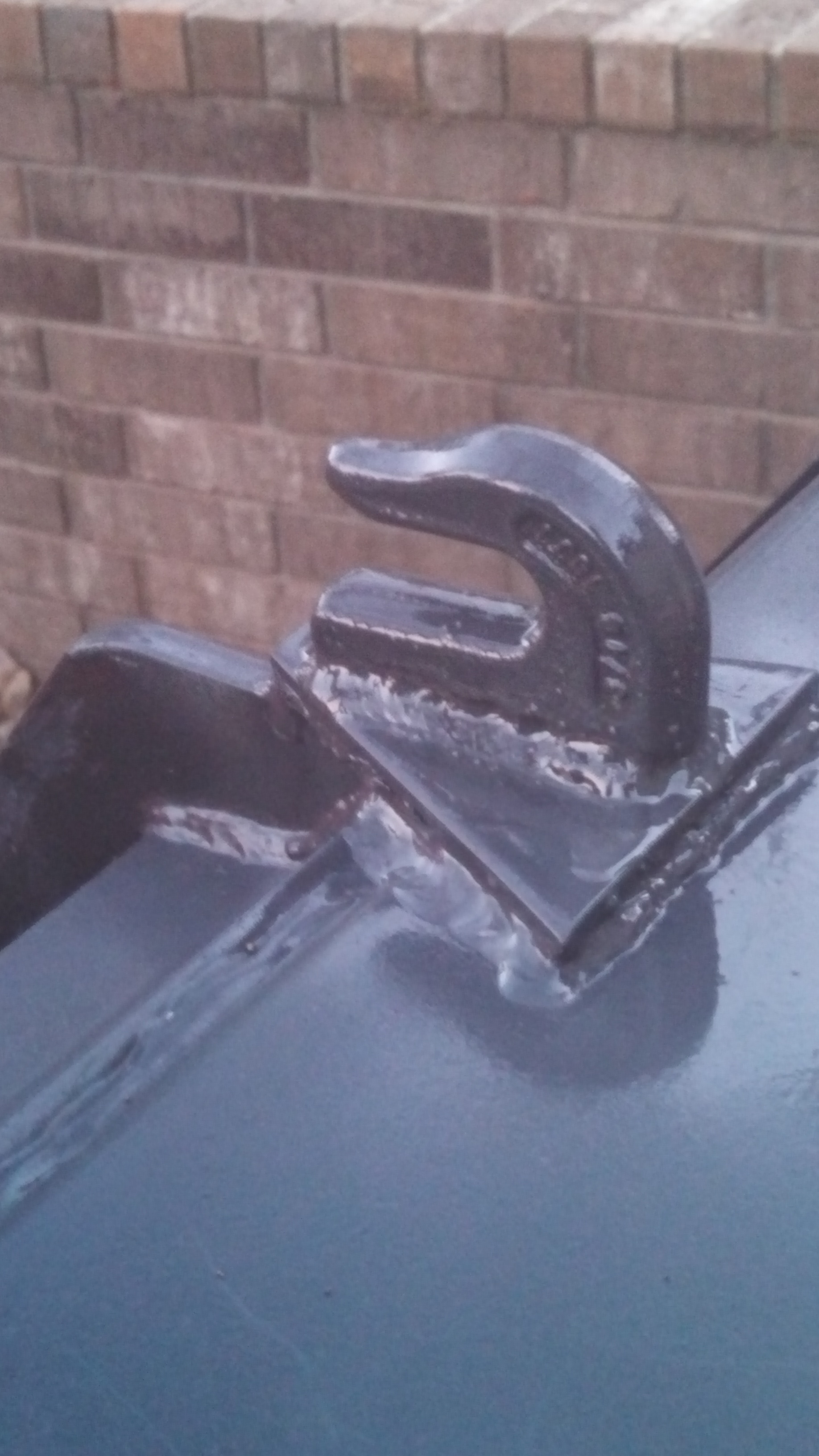

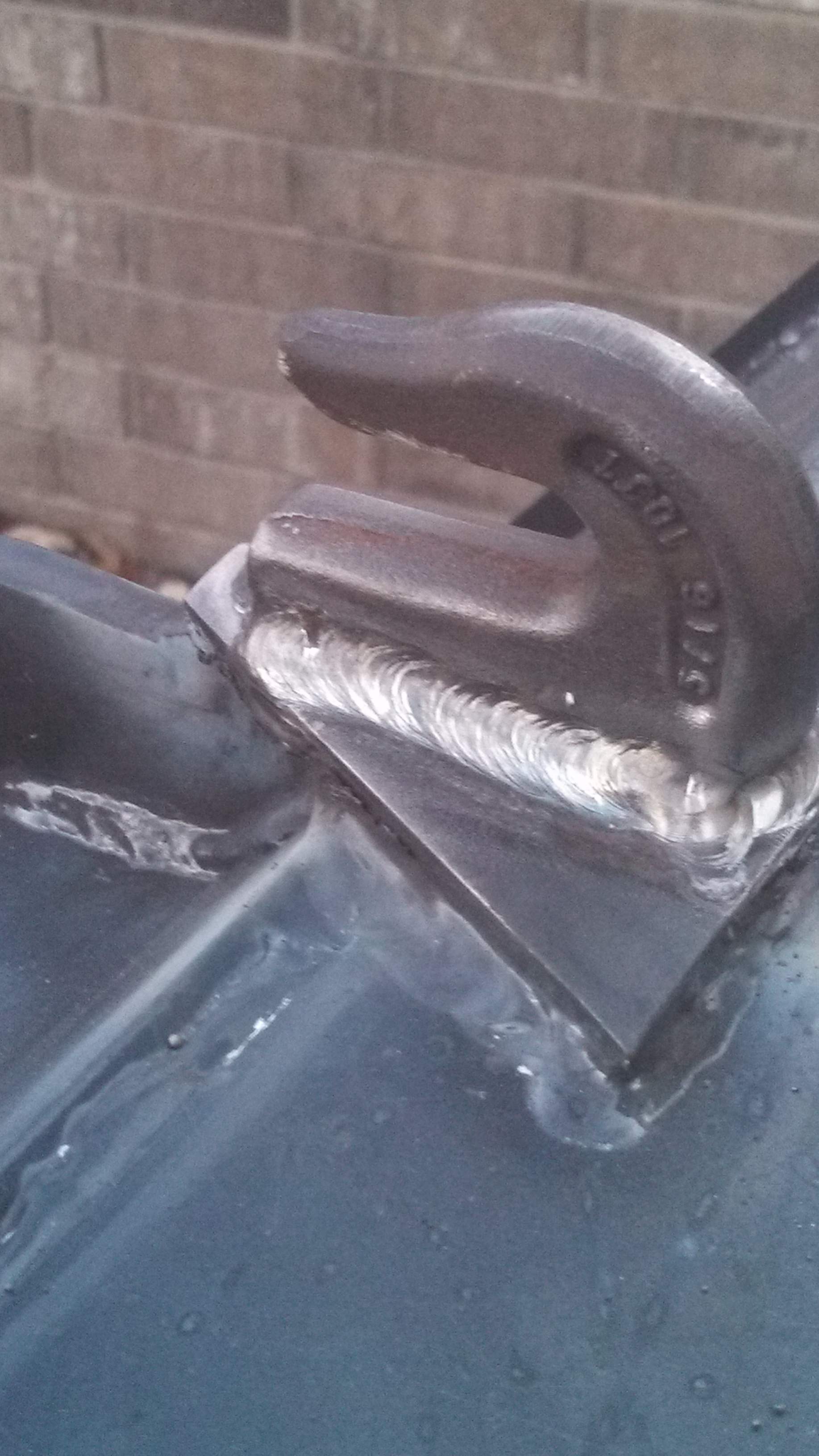

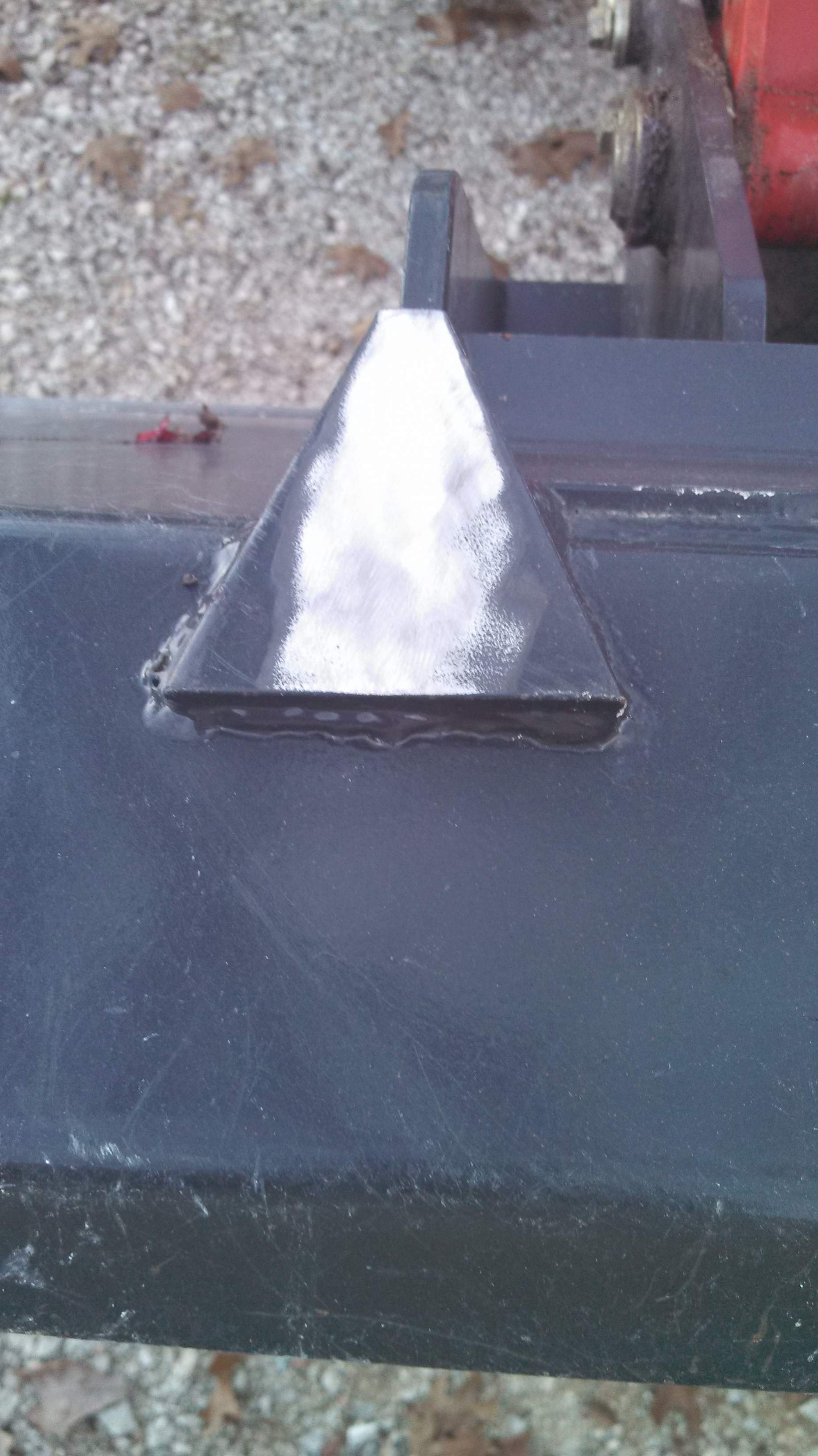

One nice thing about a good 230 volt DC stick welder is you can get into TIG welding pretty cheap by just adding a regulator on an argon cylinder and a simple 17V TIG torch. About $100 add on if you rent your argon bottle from a local source. With TIG you can do all of those small delicate repairs that stick welding is not very good for. But with stick you can make good solid welds on thicker material.
MIG is faster to learn, and faster welds than TIG. Mig is probably the most expensive. Stick is harder to learn, very cheap to operate, very flexible, and makes good strong welds on thick materials. TIG is very precise and will allow welding exotic materials, is probably the hardest to learn. But you can do it.. IF I can do it you can do it. Some pix below show TIG welding copper crush washers, repairing a broken steel hanger hook, and stick welding on bucket hooks, and repairing a cracked Kubota bucket cutting edge. So a combination of very delicate TIG welding and big repair/fabrication jobs using the stick process. All from the same little green Everlast 160 amp DC welder.

If you decide to go with a SMAW / stick welder. I switched welders with my brother-n-law, I have his Everlast PowerArc 200ST. This is a very impressive welder:cool:. You can contact Mark with Everlast to see what kind of deal he can make you. POWERARC 200ST - Stick Welders | Everlast Generators
I was in same position several years ago. I bought a Miller 211, and the little Everlast 200. While the MIG is great for fabrication and easier to use, the Everlast is what I use the most for farm implement repairs and for the money, is hard to beat. I have access to a nice Miller Bobcat 250, but the Everlast is my go to welder when something breaks.
