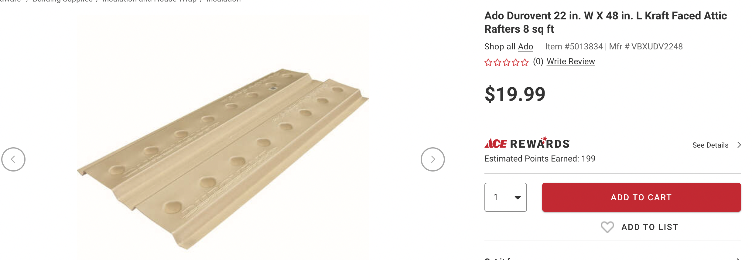

Gotcha Eddie, thanks for that. But I am talking about what they call rafter vents. They are 22x48" long and they get stapled under the decking to allow that air to move all the way from the soffit to the ridge vent. They look like this
It is $20 for a pack of 10, so it is not gonna break the bank. I need about 80 of them.
Just trying to see if people think it is necessary.
@KennyG This is a 25x28 garage built with trusses. I do not want to put a ceiling on it I would rather keep it open.

I'm talking about the same thing. They work great to keep insulation out of the soffit vent so the cooler air can enter the attic space. I've never stapled them in, they are sized just right so they squeeze in between the rafters and stay tight.
If you are going to staple fiberglass bats to your rafters, there will still be plenty of air that gets in through the ridges on the R panels on the metal roofing.
Or do you have a standing seam roof with wood decking? In that case, the condensation that you want to dry out from the air flow will be under the metal, and on top of the wood decking. There should be a layer of something waterproof on top of the decking so the condensation wont destroy the wood decking.
Either way, the baffles really wont offer very much to improving air flow, and I wouldn't install them on my buildings.
Hawk, go on and staple them. It's a cheap insurance there will be air flow. Fiberglass batts do not perform well when packed tight. I used that exact system on a rafted 22' vaulted ceiling w/ 5/8" drywall. Customer has had 0 complaints years later.
Good luck.
