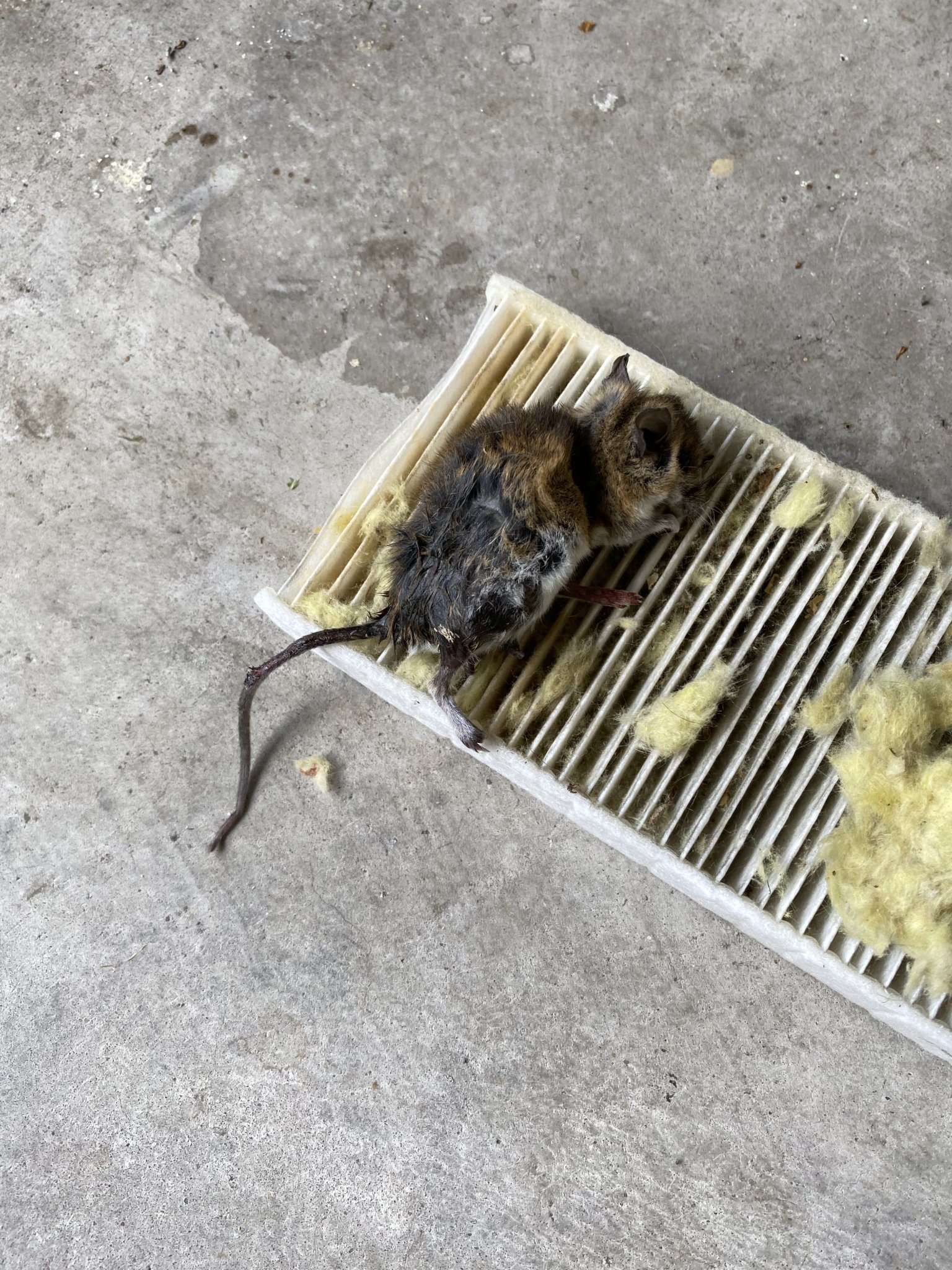

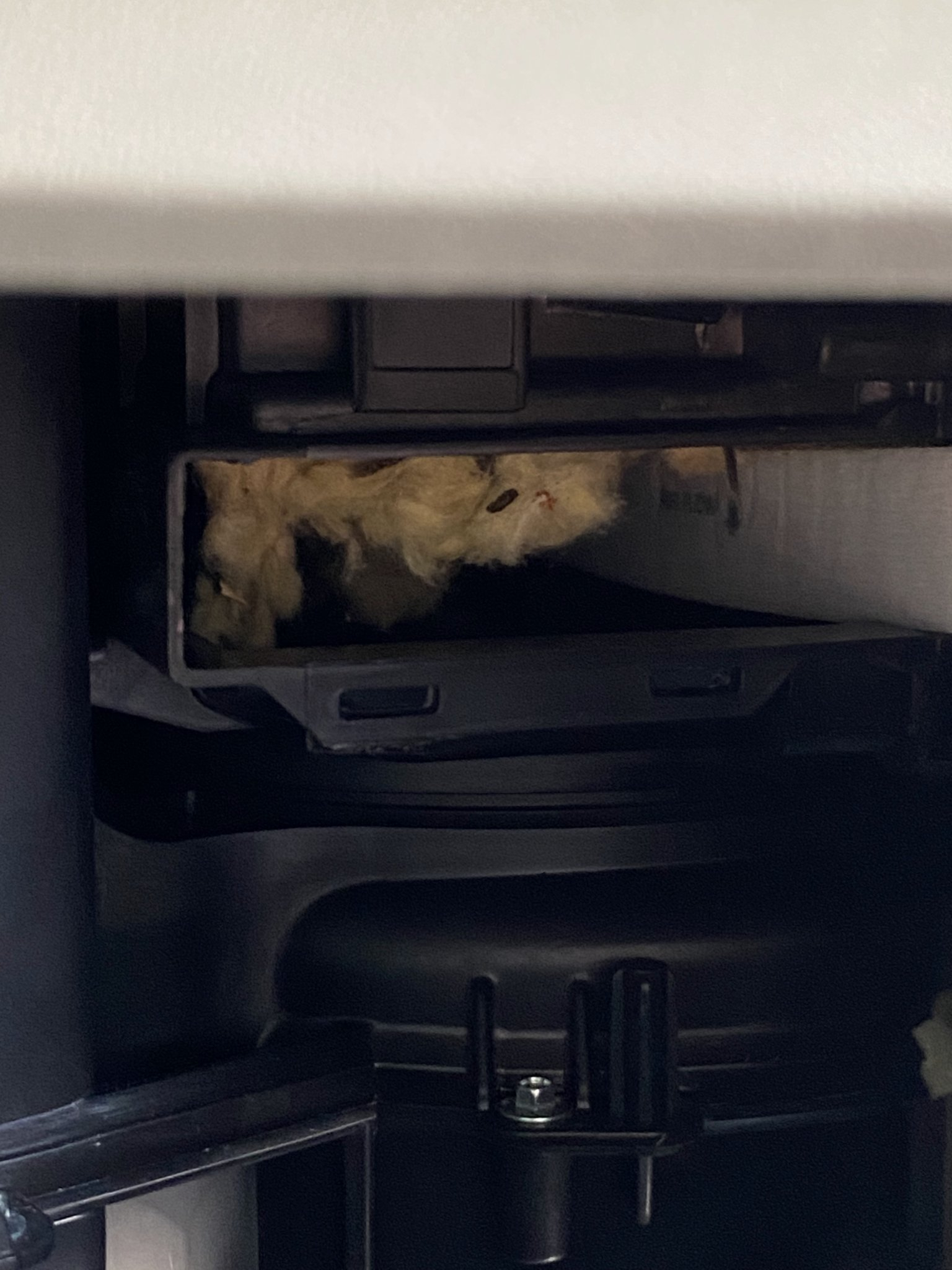

Just had this problem over the summer. I have a Nissan Frontier and a mouse got in the heater box at the cabin air filter compartment and died. Fortunate to be able to get it out put the smell lingered for weeks. Even changed the filters 4-5 times...

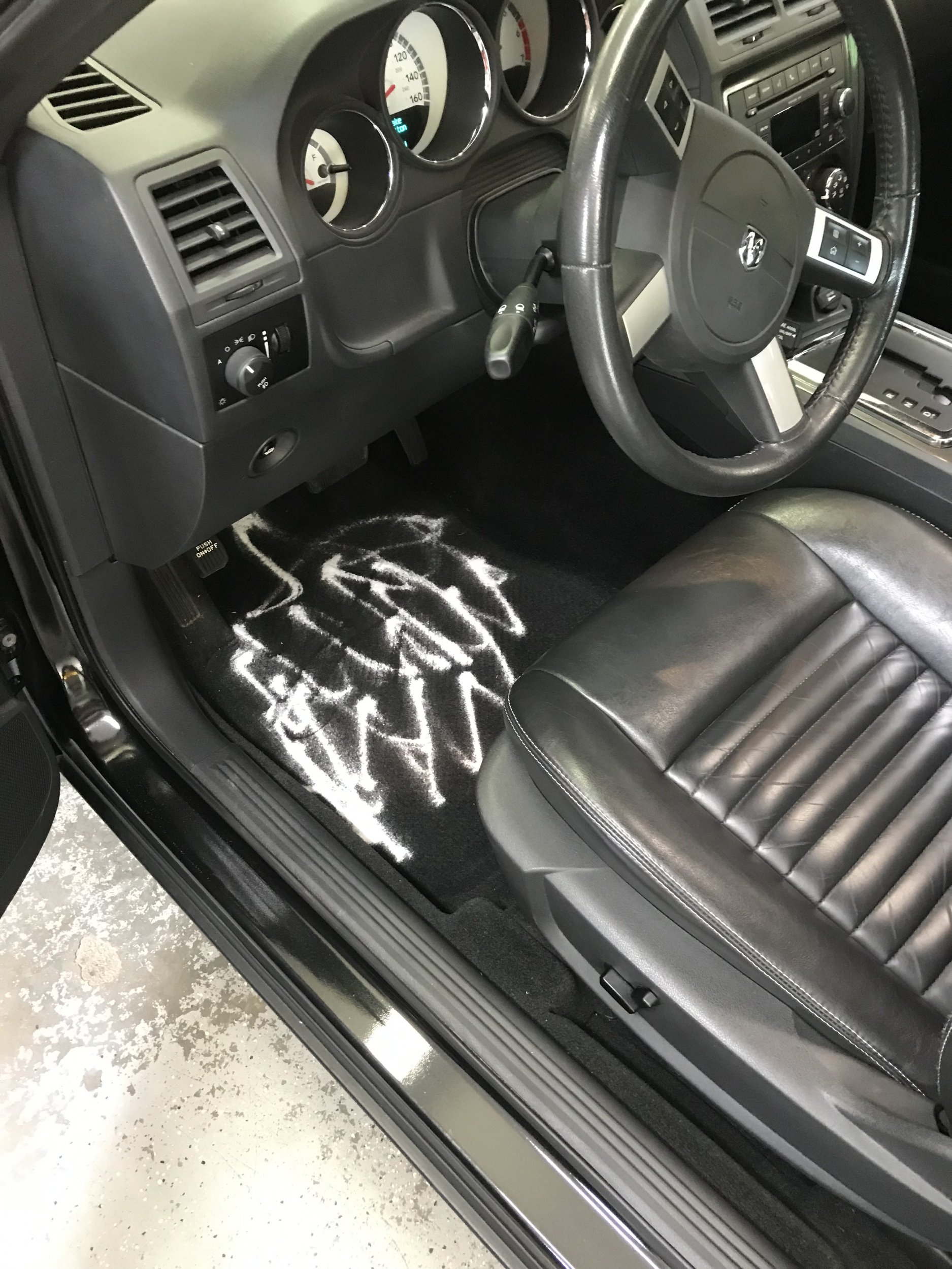

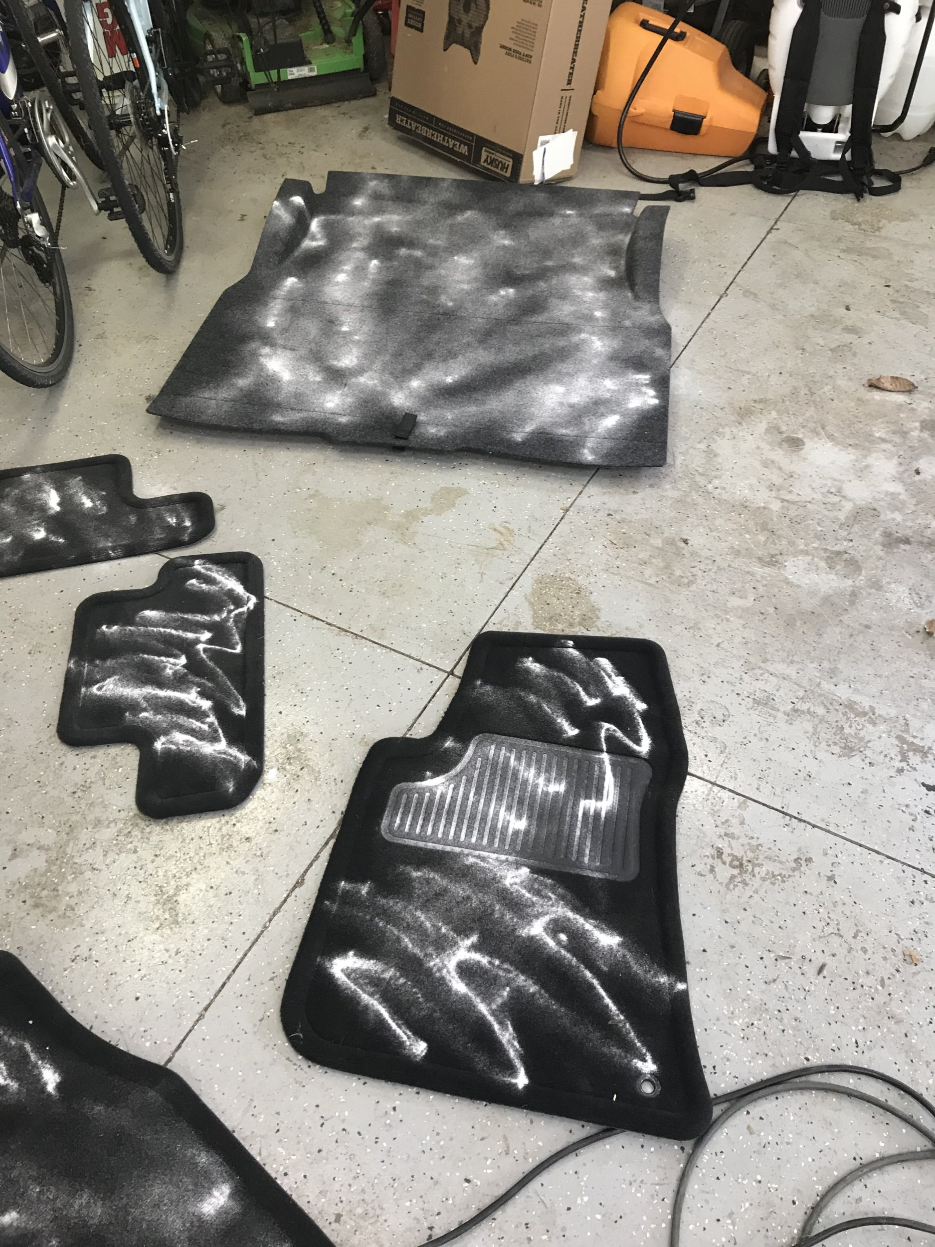

I have a 2010 Challenger that has about 22,000 miles on it so it doesn’t get driven a lot. I left some hamburger and steaks in the trunk that got partly hidden by detailing supplies, this was in August 3 years ago. Left in for a week. The attached photos show all the powdered carpet cleaner I dumped all over the place and left on it for several days. The bag never leaked, it was just a bad odor. This helped but not enough, I tried lots of things, it always got better but was still there. I don’t drive it during the winter and someone suggested coffee. I spread out a large can on a cookie sheet and left it in the truck all winter. I thought this helped the most. There is just a lot of things in a vehicle that hold smells.
