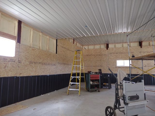

I used steel roofing panels for my shop build (before electric - exposed conduit, or door openers went in though). You can order them to the exact length for your trusses - with a 3 or 4 inch overlap, if needed (I ordered 8' 4") I used a drywall lift to hoist 'em up.

What guage of roofing pannels and how did you attach them?

I used "standard" steel roofing panels, 29 ga. for both the ceiling and 36" wainscoating. I used the regular 1.5" roofing screws - 2 per truss on the ceiling. No sag and plenty strong. I bought it all from Menard's - a big mid-western chain.
