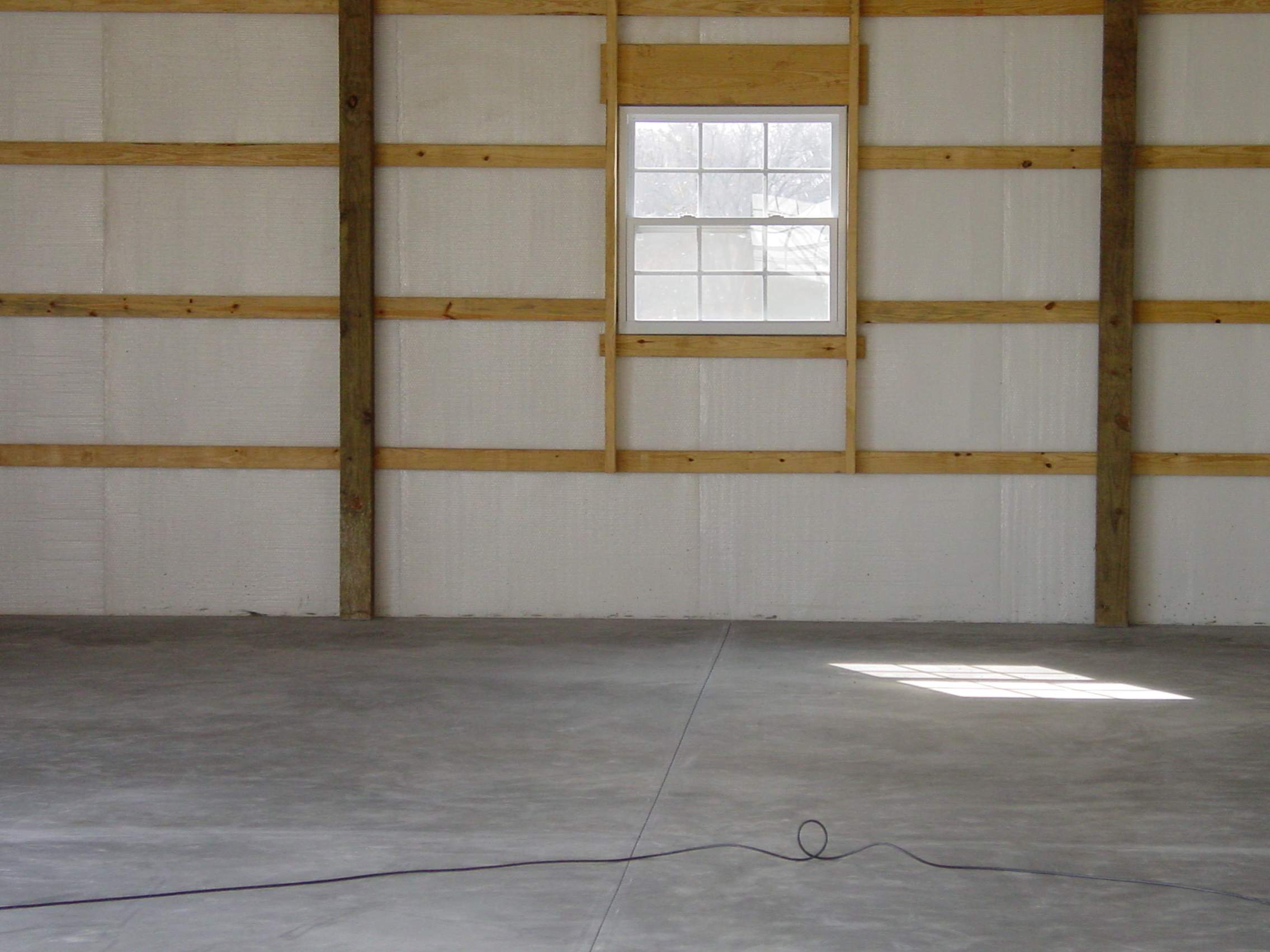

Here's some pics of bubble wrap installed on my 30X60 shop/garage. Shiny side is out with white side in. Obviously, easy to install when building new, but can be done on existing pole barns....just more time needed to install.
I had it installed on the walls and roof. The walls are 12' high and a vented ridge cap runs the entire lengh of the building. The guys used a nailer firing button staples to attach the wrap to the purlins.
Some benefits:
1) Cost was reasonable for that size of building.
2) The reflective white side made for good lighting.
3) No invasive drafts.
4) And the best part....Temperature control works great.
Inside temps are about 10-15 degrees warmer than outside
at any given time before heat. I use a portable kerosene
heater rated at 125,000 btu to get to comfortable in the
shop, usually about 55-60 degrees. Takes about 20 min.
Last week the temps in Missouri dropped to about 1 degree. The thermometer showed 19 degrees in the building. Fired up the heater and was comfortable in about 20 minutes. So far, I've been impressed! We'll see what happens in warm weather.

Don't let the cleanliness fool you...that pic was taken just after I sealed the concrete and the building was still empty! Now, its starting to look like a garage/workshop.
And...Missouri weather, you're right, it can change fast. I've seen the temps drop as much as 30 degrees in an afternoon! Mike.002.jpg

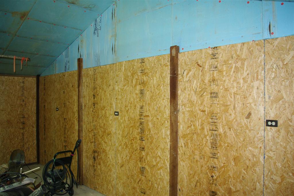

Well, 8 months after the last post in this thread I finally got the insulation installed. On the walls I put the insulation against the purlins and placed OSB over that. Nailed the insulation against the purlins in the attic. Would like to paint over the blue insulation if I can find a paint that will stick. Re-wired and placed an outlet 4.5 feet high every 8 feet on the perimeter. (can't have enough outlets). Even had enough to insert in the metal overhead door. Installed a window in the front also. Now comes lighting, cabinets, workbench, etc.

Thanks for the update, you are way ahead of me. I'm still in the wanting to do it stage!!!
How would you rate the difference in there compared to before you insulated it?
What thickness of foam did you use?
Eddie
   / Insulate/Upgrade Existing Pole Barn/Shop
#39
Eddie:
there is a noticeable difference in the summer temperature inside.
Even with everything closed up it is much cooler. I also resealed and painted the tin roof with the silver paint. That probably helps too. The insulation is 1.5" thick.
