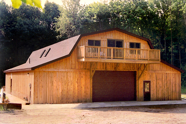

/ Pole Barn Loft Framing #13

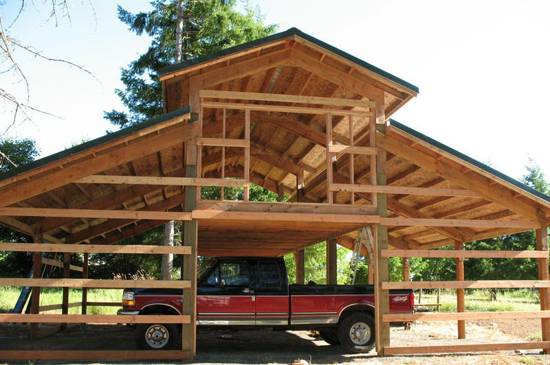

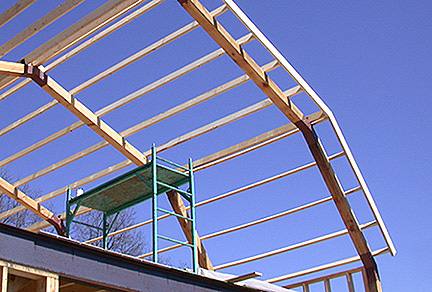

Just some pictures to think about.
#15
Also been thinking perhaps a monitor style barn would be easier to incorporate into, maybe not.
Does anyone know of a good source for pole barn building plans that would take some of this guess work out?
These plans look nice but I know nothing about the company and dont know if they are engineered or not.
Monitor Style
Gable Style

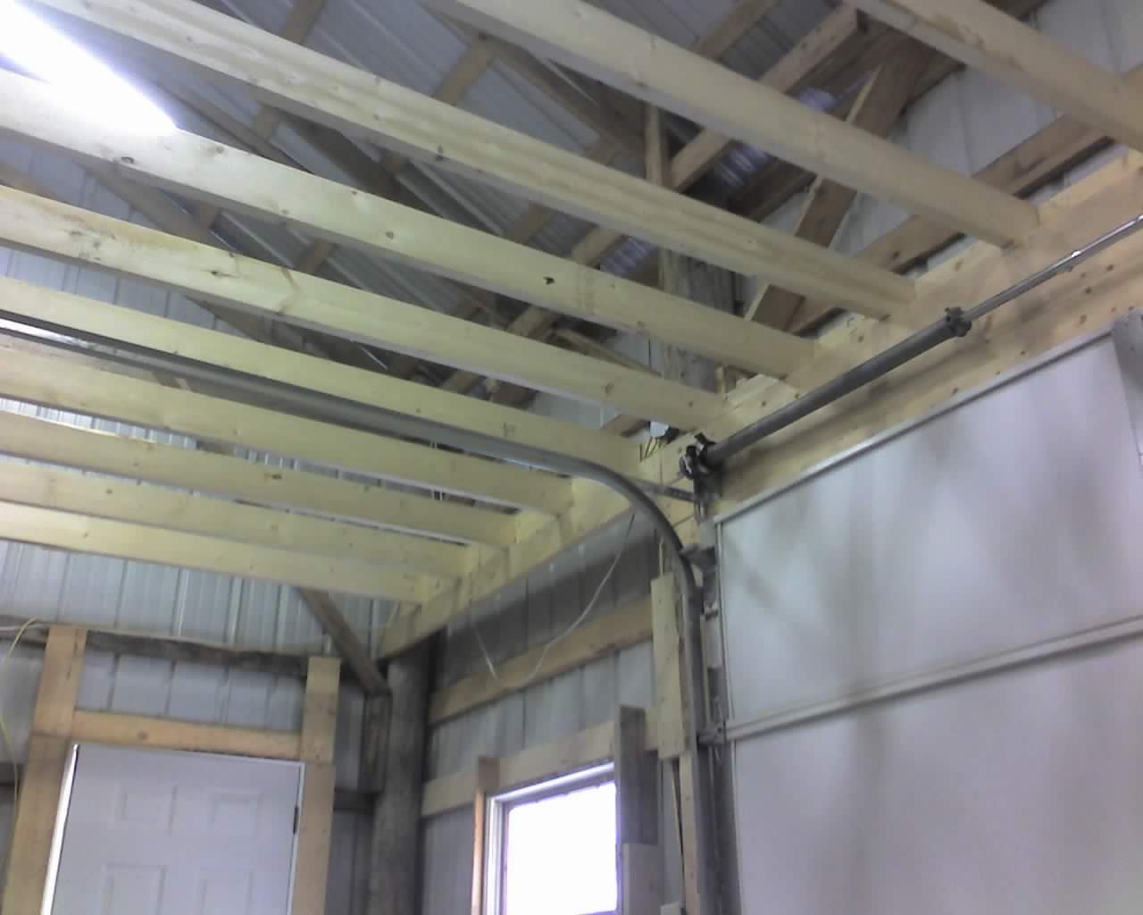

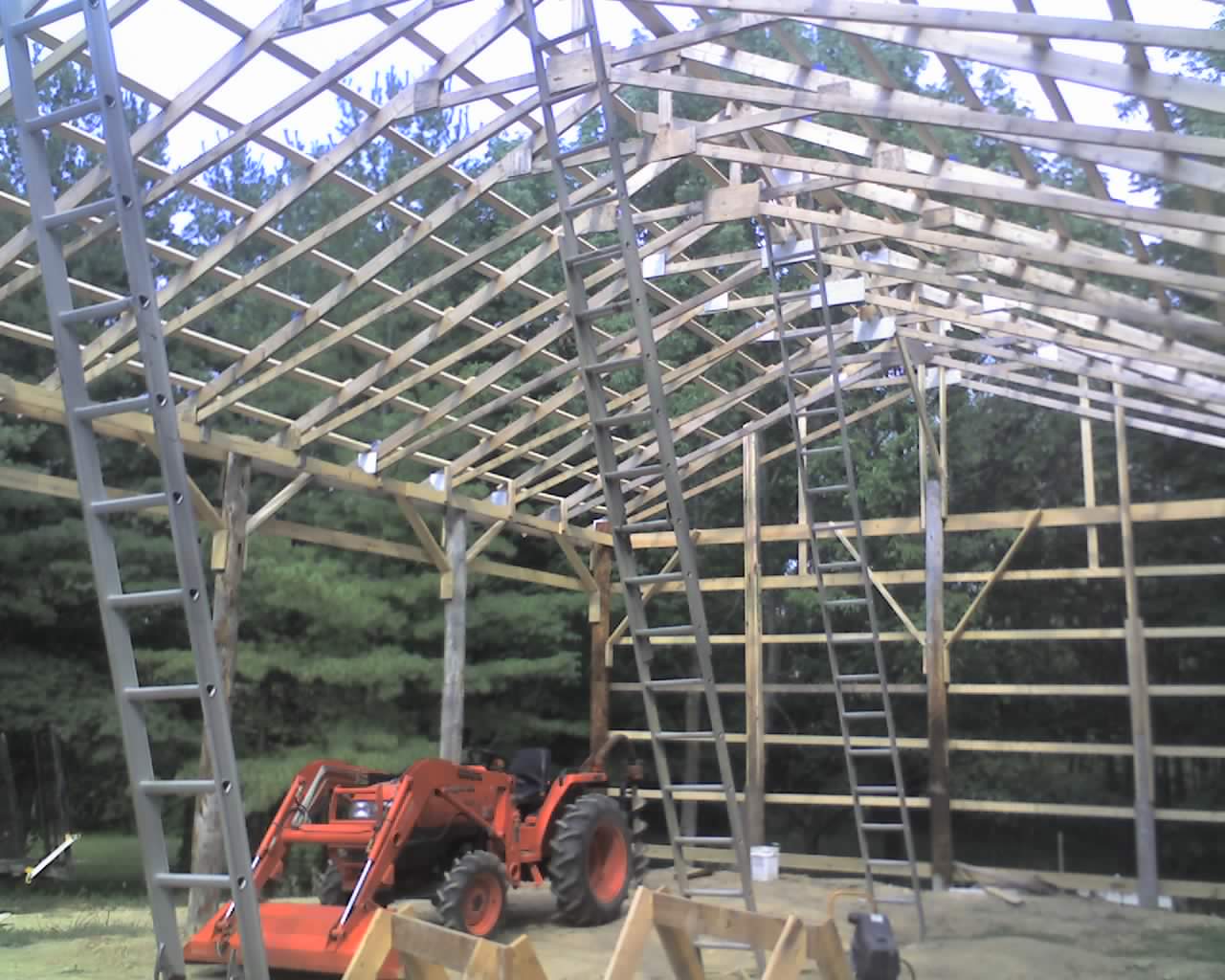

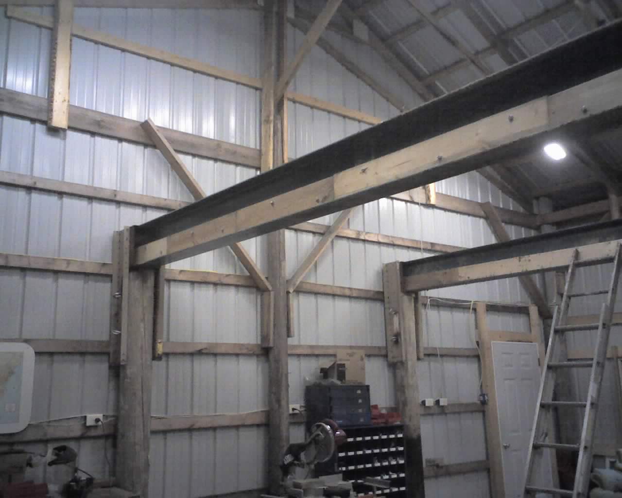

/ Pole Barn Loft Framing #16

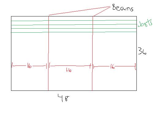

If I am reading your post correctally, You are planning on a 2x12 ledger board around the perimeter of the building on the long walls (48' walls) and plan on spanning the 36' length with floor joists???
If you do this, regular dimensional lumber will NOT span the 36' without posts/support underneath. Which means you won't have an open 36 x 48 area underneath. You will have to have posts/beams on the under side. Even engineered lumber/floor trusses are going to have a hard time clear-spanning the 36' length and would be really expensive. Even a 2x12 SYP with only a 30PSF live load spaced 12" appart would only be able to span 20'.
If it were me, and you want to maintain an open lower level, get yourself 2 36' I-beams and place them 16' appart. Then use 2x10's or 2x12's between them @ 16" centers. See attached.

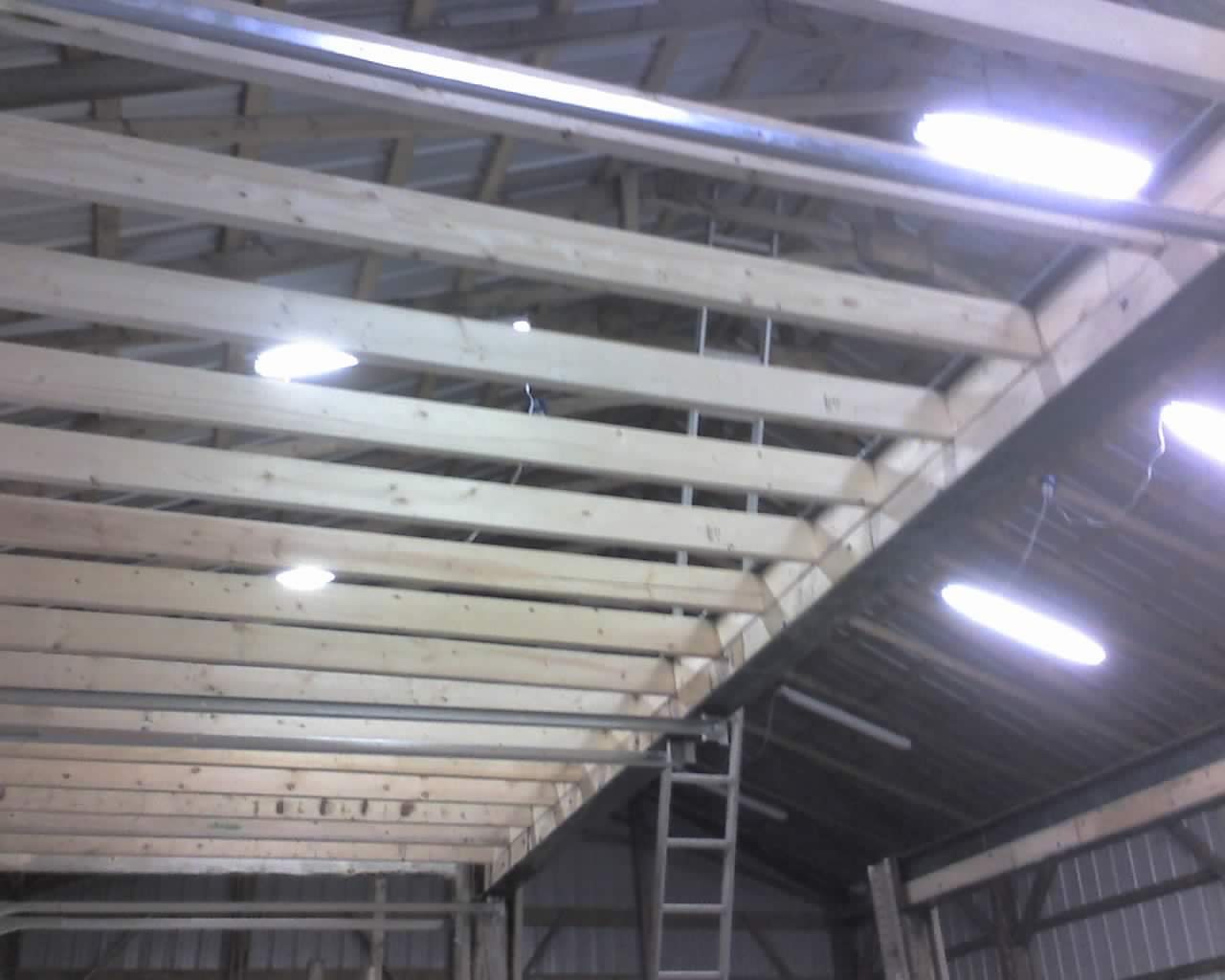

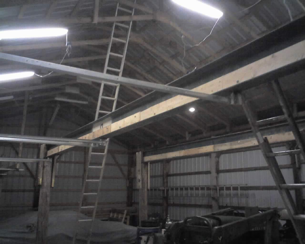

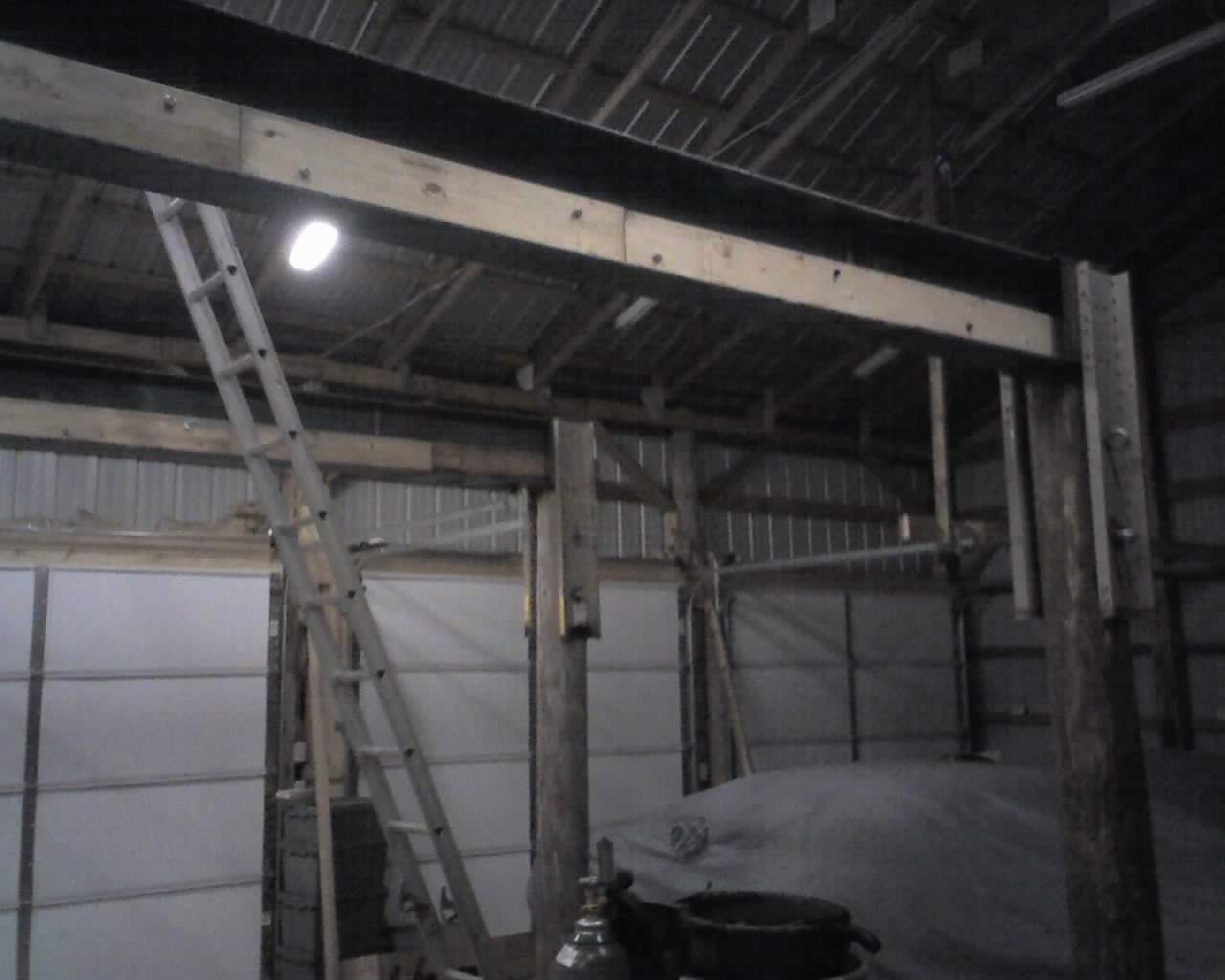

I have also attached a few pics of how I did a 30x30 loft in my 30x50 barn just to give you some ideas. I used scissor trusses as well but they were built by me.

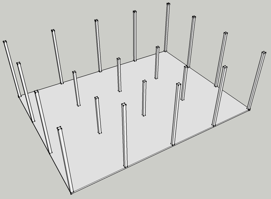

#17
I guess I'm not making myself clear.
There will be four rows of posts running 48' so basically I will run 4 2x12x48 headers there will be floor joists between them spanning 12' only. The inside of the building will have posts every 12'.
/ Pole Barn Loft Framing #18
I think some of use were getting confused and thought you wanted to run 36' without supports beside the side walls. With 12' spans you should be fine. How tall do plan on the side walls being? Head room in the loft would seem to be where you will have a problem.
MarkV
/ Pole Barn Loft Framing #19
OK, I missed the part about the two rows of posts down the middle of the building.
OOOPS.
Eddie
