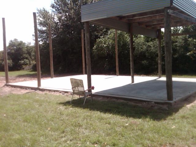

Hi everyone,
I've been reading many posts here regarding pole barns and proceedures, etc. I have some questions that I haven't been able to wrap my head around the answer. So, I would like to post them since everyone here has great opinions and ideas.
Background:
There were existing poles in place when I bought the place (12x24 on 12'pole spacing). They have the tin wrap in the pic. So I had a slab poured around the existing poles and had some new ones placed. It's ~24x36. The use of this building is intended as a garage/shop. The roof was going to be shed type with a 1:12pitch, but now I would like to make the building a little better. So, that went from a basic bldg to being insulated and possibly a room on top. So, here are my questions:
If I trim the poles level and put attic trusses up, how much overhang can I have (trying to make the attic/room as tall as I can) and do they have to be placed 2' OC? Or... is the 24' span just not big enough to make a stand up room (like a sleeping loft)?
If I wrap the bldg with moisture barrier, where does the moisture barrier go? and should I just side it with osb too? Girt/wrap/metal? wrap/girt/metal? Or... can I just put insulation (like that foam board stuff) on the inside of the girt after walls are up and be done with it?
Thanks for helping I've been at a loss with steps.

Lots of unknowns for a real good answer but: here's a link to various truss types. A full gambrel will give you the most space short of going to a full second story. Question is; will your posts support the weight of added structure & intended occupancy? Do the posts sit on solid footings? what kind of wind load/bracing will you need?
Overhang is obtainable but must be designed into truss application. Trusses rely on a specific geometry & can fail slowly or catastrophically if incorrectly installed. Most triuss companies will provide a design for your aplication.
Moisture barrier is primarily to keep the normal room moisture from penetrating to & saturatung the insulation/framing. Moisture trapped in the wall causes loss of insulating factor & rot. Rigit foam (vs fiberglass)won't absorb enough moisture to substantually lower heat transfer but can still trap moisture in contact with structural wood. MikeD74T
MikeD74T
Ditto--also, there are about a million other qutions--type of roofing, what is the room for? YOur are insulating, will there be power and HVAC?
All of this is important because it is goign to add weight to that sleeping loft and if the basic structure is not correct, it wll all come down--either slowly or quickly.
Can I ask if you have done any type of projety like this before? I am all for figureing it out as you go, but you might need some on site advice.

One other thing, just looking at the span tables for floor joists, for the 12ft span, you will need either 2 x 8 (12 inches on center: 12 OC) or 2 x 10 24 oc). Those will be some heafty rafters.

I hear what you are saying.
Trusses will work or the material list you have.
How tall are the poles? I am asking because I thought you mentioned you wanted a low slopw roof--1/12 pitch, which may affect how much room you would have in the attic.
It is was my building, I would put radiant barrier OSC sheathing on first (then your felt paper, purlins, etc). Three reasons:
1. Wind shear/structural benefit
2. Radiant barrier/insulation benefits (it does make a difference here in TX)
3. Support the roofing felt over time--the wind moving between the metal and the purlins is going to cause that felt to start "flapping" and moving over time and it would drive me nuts when I was in there working. :confused2:
For the sides, I would definitely sheath it and use the house wrap, then what ever siding you want (metal, hardi plank, vinyl, etc).
For insulation, that can always be added later. Unless you want to do foam sheets on the outside, you do the insulation from the "inside" of the building only after you have created a weather tight skin on the outide.
