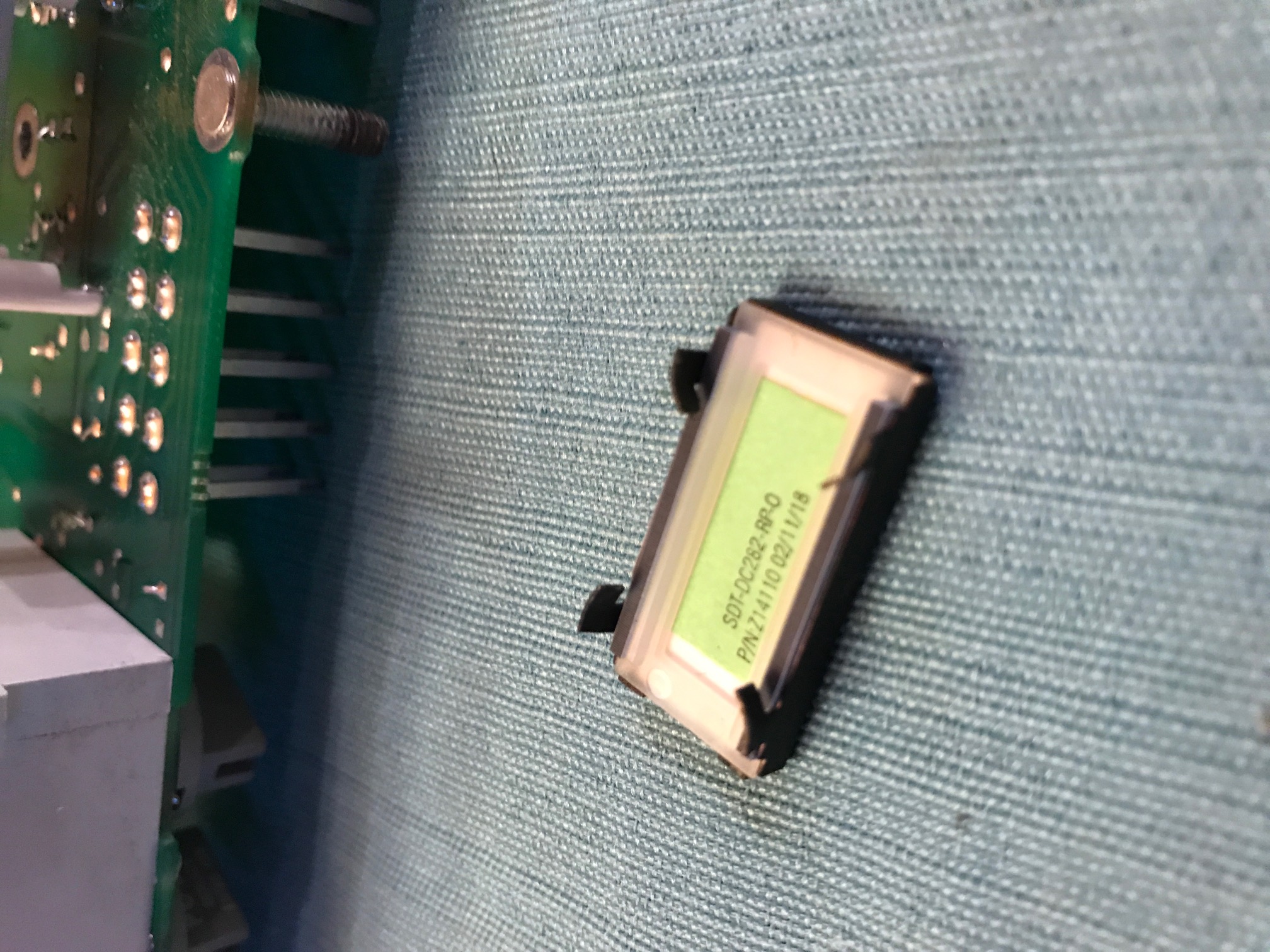

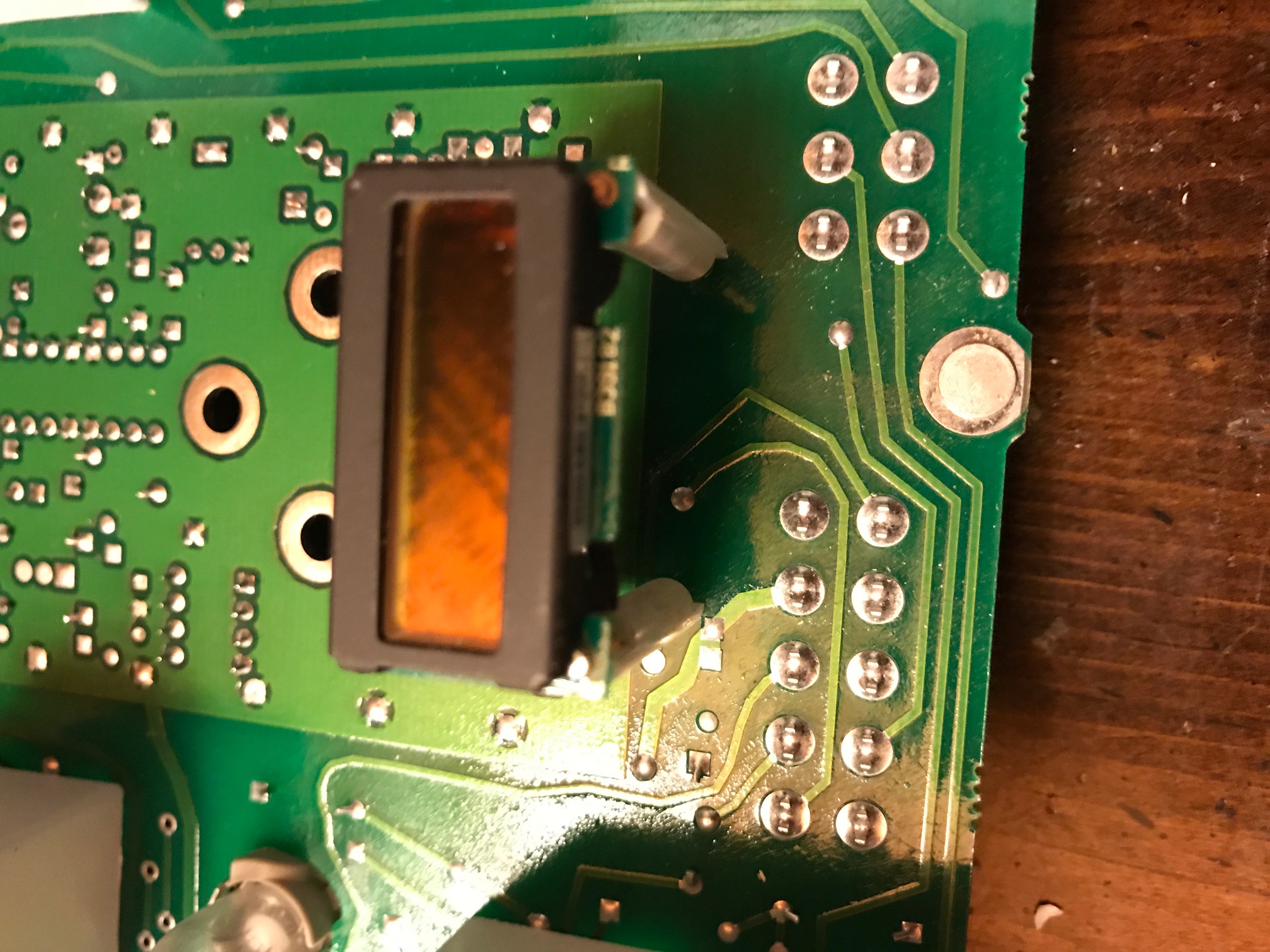

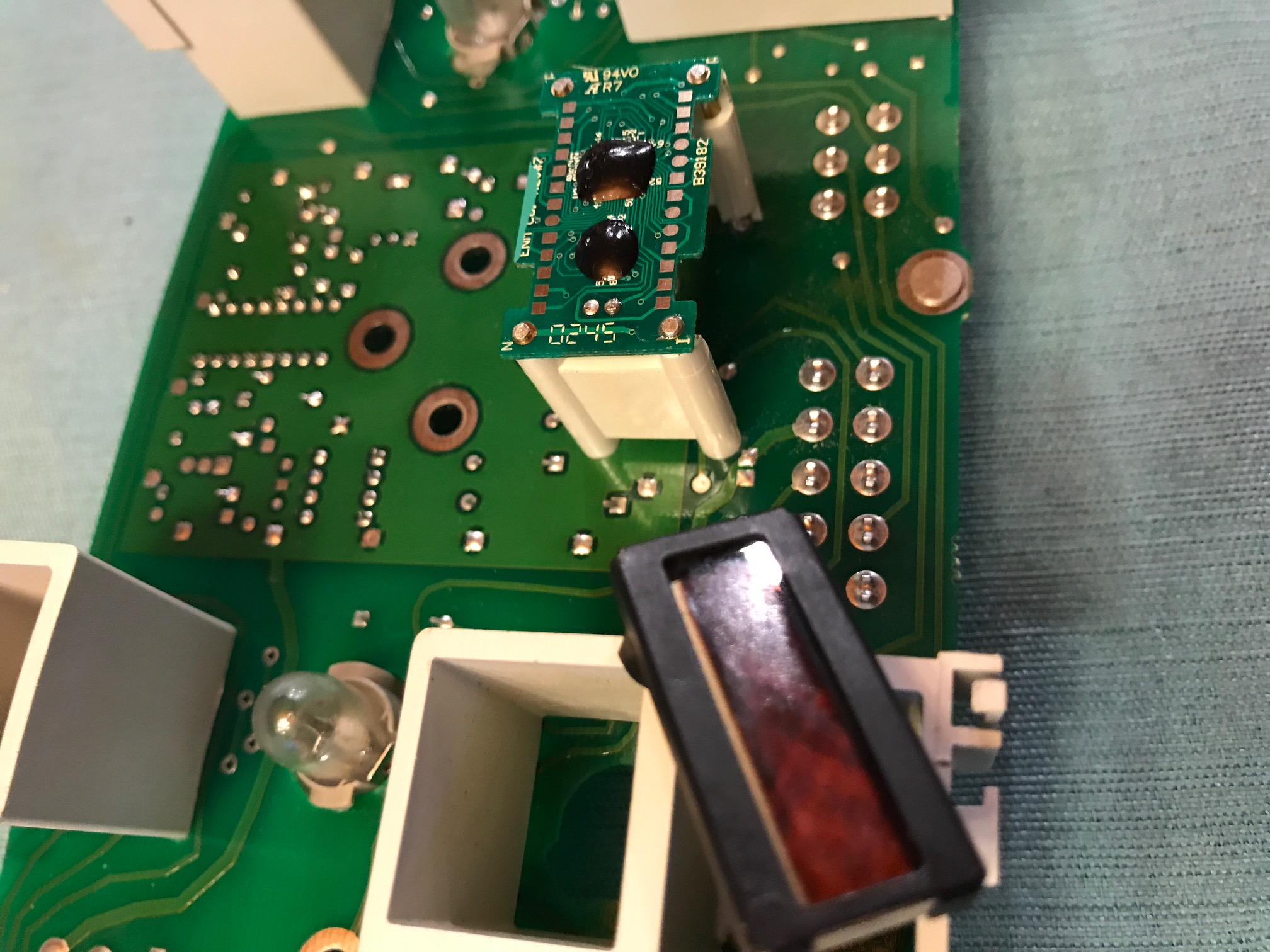

OK, this is almost embarrassing how easily it can be repaired. The hour meter is an off the shelf componant that is used all ovr. The display is held on with tabs. No soldering at all.
It's probably connected with what is called zebra strip. It's made of alternating layers of conductive and non conductive rubber strips that is squeezed between two lines of contacts one on the board and the other on the back of the glass LCD so alignment between the two is critical. Usually there is some sort of mechanical alignment aid in the design of the parts.

Thanks! With that in mind, my son and I tried another tack at getting it. We were able to get a proper display! While it won't go back together permanently; we were able to get the exact number of hours. I have two possibilities for replacing the hour meter set to that number! I have one clocking up (slowly) and will see if the programmable one will be a direct fit. One, or the other, will have it good as new.,

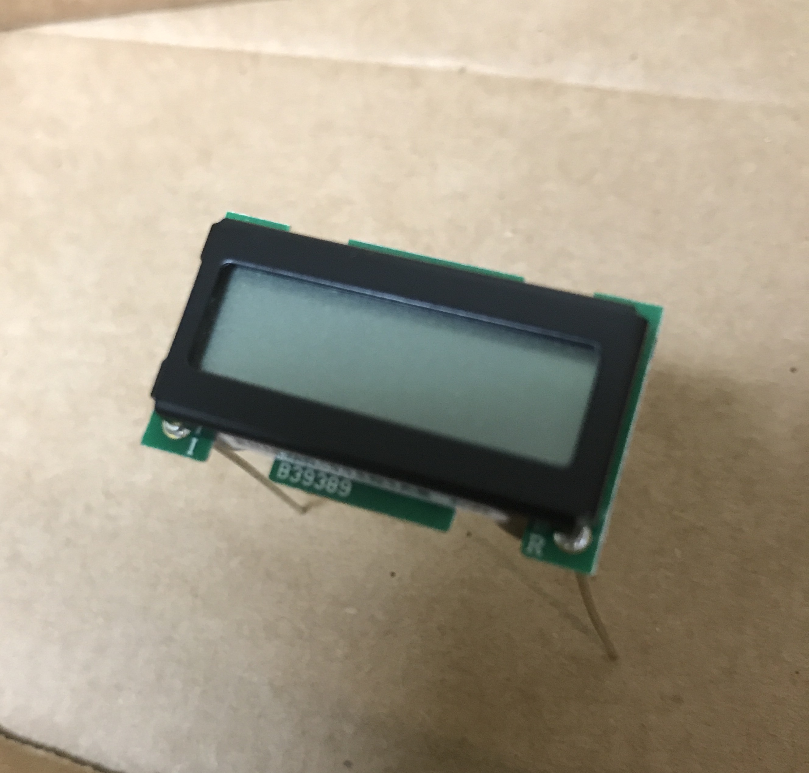

We were able to read the old hourmeter using a new LCD; just couldn't get it to stay put. So, I ended up connecting a new meter to a 12v battery and just let it run. Slowly, but surely, it got the right hours!

I think he ended up hooking his new hour meter to a battery for a month or two until it hit the 700 hours.

Exactly! As I already PM'd, I couldn't get a reliable connection swapping a new LCD panel on the old module, so we hooked a new module to a battery and let it clock up. My buddy who is a Helicopter tech told me they've attached drill motors to mechanical ones to run them up. It happens.
I did not know that strip had a name. I have had them fail in numerous devices. They need just enough
mechanically-applied pressure to get a good contact.
