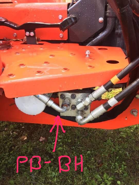

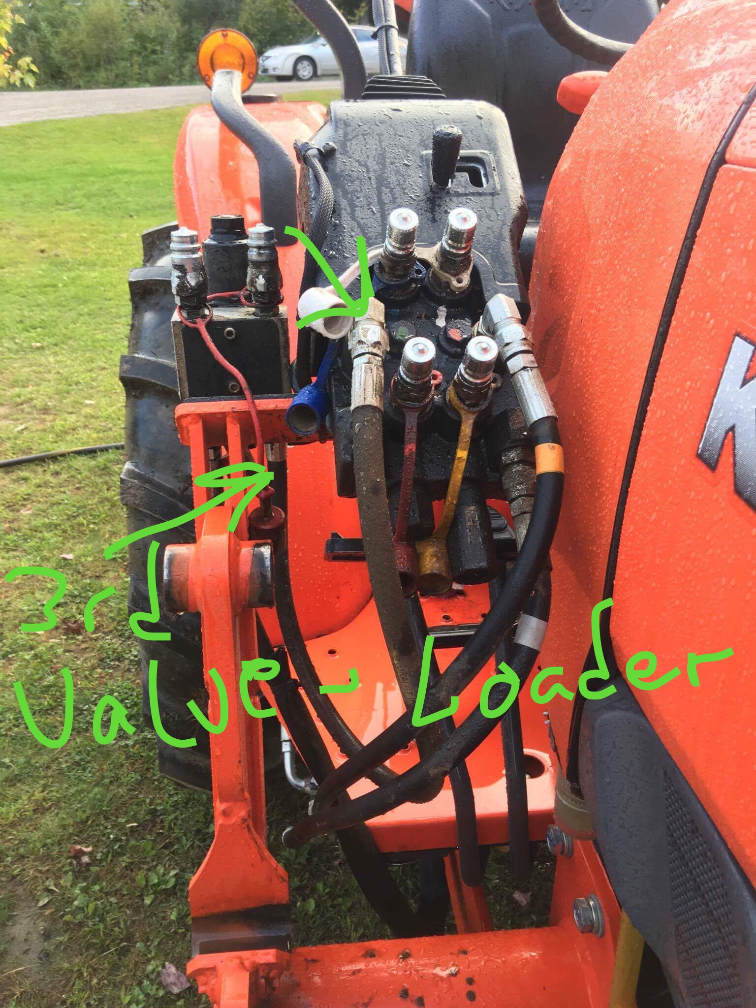

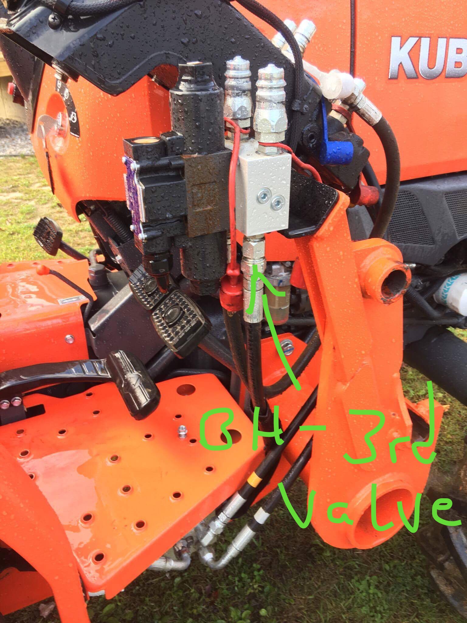

So here's some pics of my hydraulic circuit. Power beyond goes straight out to the backhoe and loops back under the right side floor pan and then connects to the third function valve. From the third function valve, flow comes It and goes directly into the loader valve. Pretty straight forward as long as you have the correct hoses.
View attachment 522453View attachment 522454View attachment 522455
I greatly appreciate those pics!! Thank you very much! Really helps me to understand what is going on.
Thank you for taking the time to do this for me! (0:

This helped me so much. I have been trying to figure this out for 2 days. My Kubota dealer didn't really know for sure how to do this without adding some tees. You really need to make a youtube video of this because there is practically nothing on the web on how to connect a third function if you have a back hoe on the tractor. Again thanks
