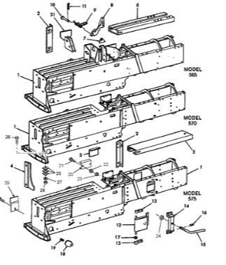

   / Inline vs Traditional small Square Balers? #76
The only way to get banana shaped bales is to tighten one side down and leave the other loose the same way you do on a traditional baler. It has the same flakes as all other square balers do.
Please explain if the bale compression apparatus is applying pressure to "the center(top & bottom) of the forming bale" and the cranks attach into springs how this affects a banana shaped bale? I was taught that banana shaped bales are caused by the size of windrow,ground speed,which area of PU hay is fed into on baler & how the feeder fingers are adjusted IE both sides of bale need correct amount of hay. I agree number of flakes per bale is the same for all brands determined by ground speed,windrow size and baler strokes per minute.
   / Inline vs Traditional small Square Balers? #77
If you don't set the tension evenly on the bale with the hand cranks, you're not applying pressure to the top center of the bale. There are also side shims that I guess could fall out or be left out that might contribute to one side being loose.
   / Inline vs Traditional small Square Balers? #78
Ok explain how if both upper(parts key #6) & lower(parts key #5) channels in bale case are pivoting on each extreme side how more pressure can me applied on one or the other side of channel with just spring tension? I randomly picked a NH small sq baler schematic but all brands are similar in channel attachment.
