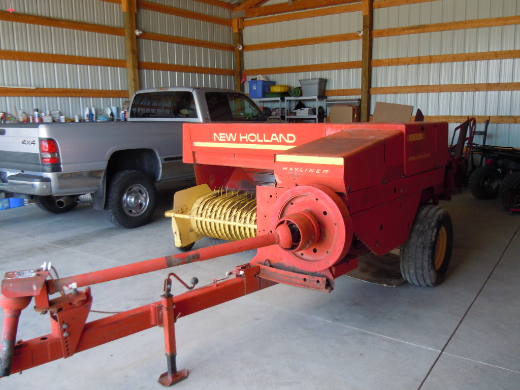

I have a NH 316 baler. I think it's around a 1984 model not sure though. Paid $4000 bucks for it. All I have done is put new twine knives on it and grease every time I bale. It might miss 1 out of 150 bales, usually because I am going to fast. If I go slower it bales perfect every time.
