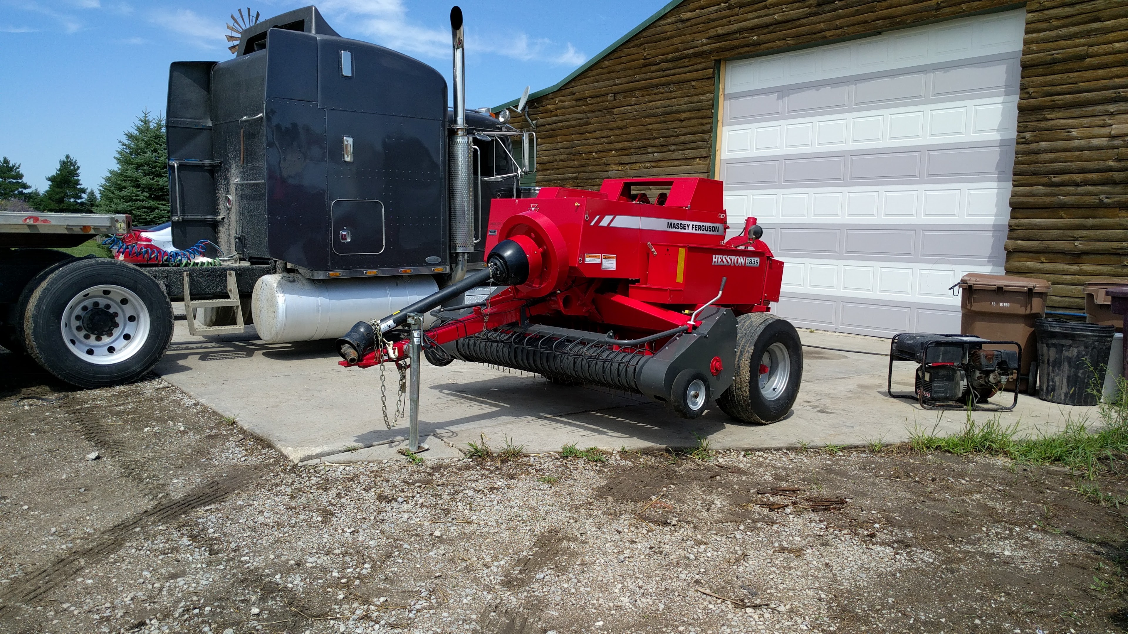

An update here, months later...
After fighting the right side knotter for several days on my NH273 (new billhook, new wiper, new pinion gears, adjusted twine fingers, new twine holders etc...) I finally got it to tie properly but I wasted the better part of 2 days working on it. I decided it was time to look for something new.
As fate would have it, a 2015 massey 1839 baler with 2500 bales through it was posted for sale the day before, for a very good price. I went to look at it and brought it home. Very impressed with how fast it bales, and impressed with the bales themselves.
Not exactly sure if I will try to get my farmhand accumulator running with it or not. It's setup to run from a baler-mounted flywheel pump now which i obviously won't be able to use on the new baler. I might try just connecting the accumulator up to a remote on the tractor and seeing if i have enough flow to run it.

/ inline baler vs 'conventional' baler.... #20
Matt, you'll love that 1839 i know. Bricks at speed that's what it'll spew
