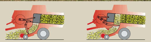

   / Inline vs Traditional small Square Balers?
Here is a cartoon from the Massey/Hesston site.
One would have to expect good right-left symmetry of the bales, assuming one is picking up the windrow in the middle of the baler. However, one might be concerned with top/bottom assymetry. I.E. what happens to the bale when you pick it up.
I think some of the hay that Mom had problems with got an extra day or two of drying, but still, when the neighbor came down with an 20 or 30 year old IH, it did much better.
