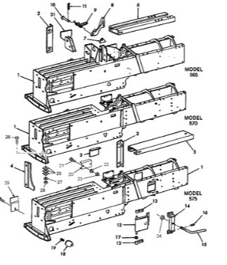

I've had an inline Hesston sq baler for about 15 years now. Never had any trouble out of it. The only way to get banana shaped bales is to tighten one side down and leave the other loose the same way you do on a traditional baler. It has the same flakes as all other square balers do.
Some of the inline sq balers are a little smaller size. The only thing this means is you have to lower your baling speed or make your windrow smaller, but getting the right size windrow for your baler is to do no matter kind of baler you are running.
The benefits to a twine tie square bale is, it's much easier on the fingers when picking them up in the field. The downsides are the little strands of twine sometimes left on top of the bale after the knot is cut and every once in a while you'll have a bale break if you have it adjusted too tight.
   / Inline vs Traditional small Square Balers? #76
Please explain if the bale compression apparatus is applying pressure to "the center(top & bottom) of the forming bale" and the cranks attach into springs how this affects a banana shaped bale? I was taught that banana shaped bales are caused by the size of windrow,ground speed,which area of PU hay is fed into on baler & how the feeder fingers are adjusted IE both sides of bale need correct amount of hay. I agree number of flakes per bale is the same for all brands determined by ground speed,windrow size and baler strokes per minute.
   / Inline vs Traditional small Square Balers? #77
If you don't set the tension evenly on the bale with the hand cranks, you're not applying pressure to the top center of the bale. There are also side shims that I guess could fall out or be left out that might contribute to one side being loose.
   / Inline vs Traditional small Square Balers? #78
Ok explain how if both upper(parts key #6) & lower(parts key #5) channels in bale case are pivoting on each extreme side how more pressure can me applied on one or the other side of channel with just spring tension? I randomly picked a NH small sq baler schematic but all brands are similar in channel attachment.
