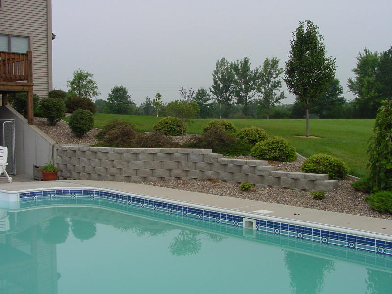

/ Inground Pool - Help Please #24
Here are some pics I took tonight that may show the situation a little better. They do not quite do justice to the degree of slope involved, but it varies from 1.5 feet to about 3 feet depending on where in the yard you are. The grass is a little thin in these shots as I had the yard torn up to run services out to my new barn. It's just starting to come back decent.

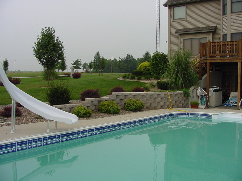

/ Inground Pool - Help Please #25
Here is 2nd pic. Hope this helps in some way! Good luck.
