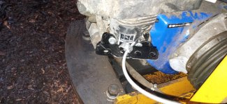

Looks like Cam at TheGarageConnection on Utube is selling a kit to help protect the wheel motors. I suggested he may want to add plates to also protect the hoses and fittings.

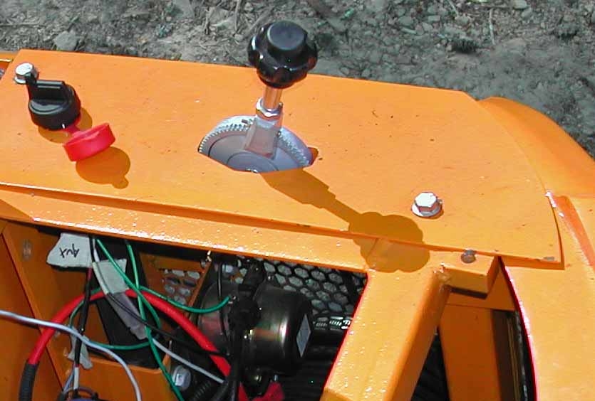

I want to talk about the engine throttle control and choke control, and how to improve them. I have just re-routed my choke control cable, which I show here soon.
Most of the one ton-ish minis come with this engine speed control lever, a relic of the 1-cylinder diesel engines that normally come with these machines. It has a long stroke, and was used to regulate the fuel flow, and turn off the engine mechanically.
On my XN08, the speed control was mounted on the right side of the house, beside the seat (photo). I adapted it to the DuroMax (LCT) engine I bought and installed.
On the Ouke machines, the lever is installed on the same plate that the seat is mounted to. When you open the seat to access the fuel tank, the throttle cable binds cuz it has to go up with the seat. Photo is the bottom side of that lever. Ugh.

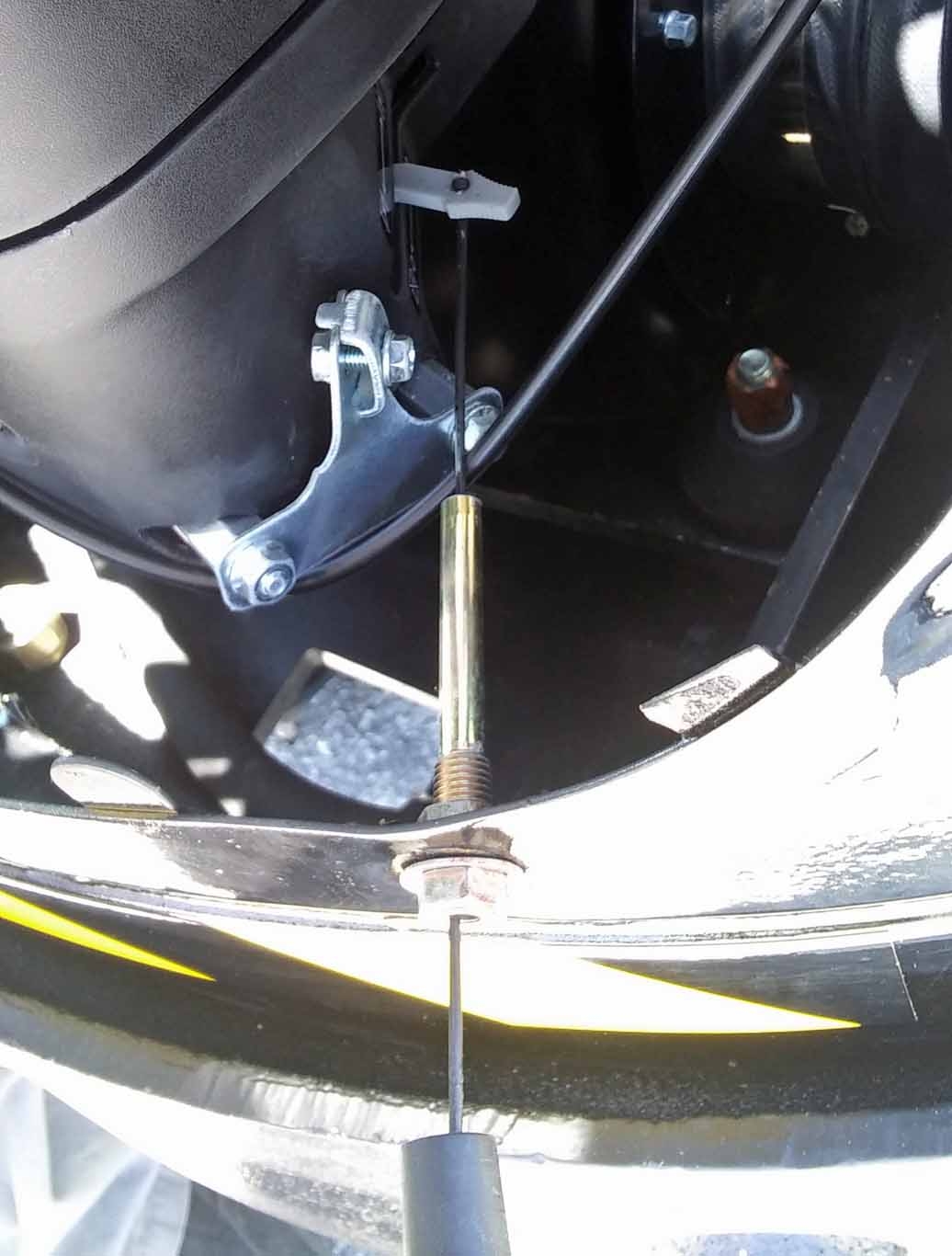

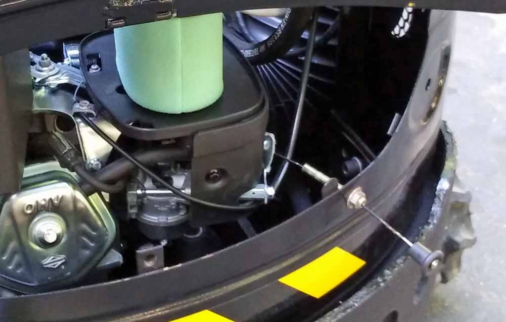

Here is the Ouke machine showing inside the house. The throttle cable needs more slack, even after I re-routed it above the choke cable.
The choke cable is a solid wire that goes thru a drilled hole in the choke lever on the carb, and exits the back panel of the house. On my machine, I did it a similar way, but my rear panel is one piece, so the choke needs to be disconnected when I remove the panel.
Both of these rear panel choke controls work OK. I just moved mine to the front house panel.

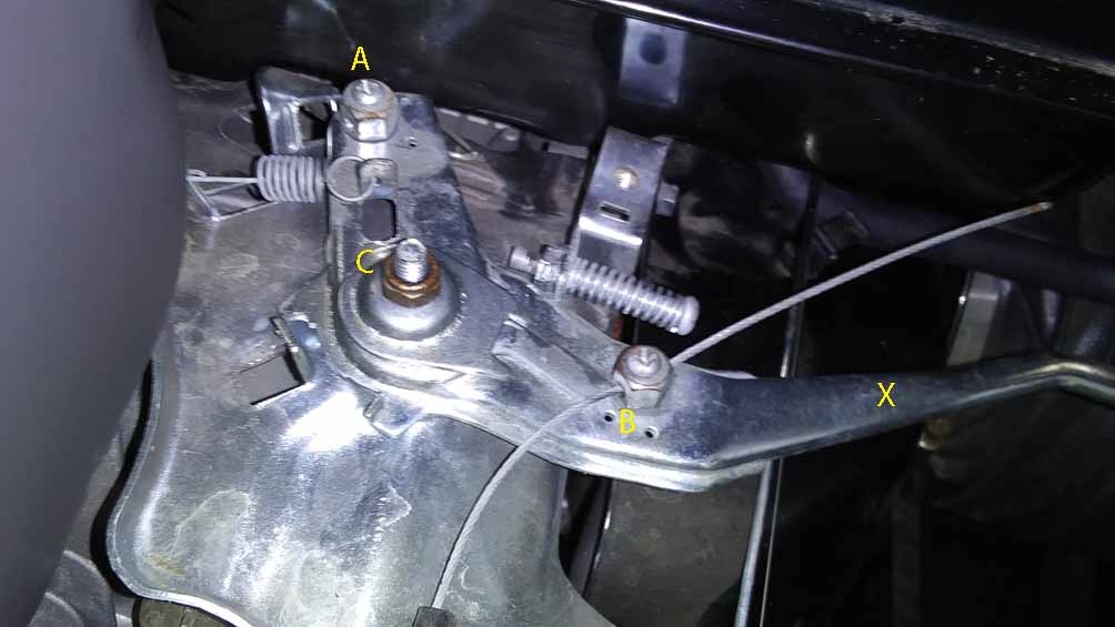

There are 2 problems with the throttle control that immediately becomes apparent: it is a cable, so it pulls well, but does not push well. That means good control depends on a good spring return to idle.
The second bad thing is that if you use one or the other of the 2 default cable connections on the throttle lever, the cable only moves an inch or so between idle and WOT.
This photo is a new Briggs throttle, which is very similar to other 420 thumper engines, whether Honda or Chonda. A and B are the 2 cable clamps that come from the factory. C is the main pivot shaft.
The Ouke machines attached the cable at B. I used A for my Duromax. If you drill a hole at X, and relocate the clamp from B to X, the lever has a longer stroke will work much better. The clamp at B should be used to install a 2nd throttle return spring, which I have done on the Duromax.
Also the main pivot, C, has a friction clamp that should be disabled as shown. It should also be disassembled and greased.
I saw a Utube vid of a guy who relocated his throttle cable like this and he enjoys much more control over engine speed. What first was 4 clicks of the control lever is now a dozen or more.

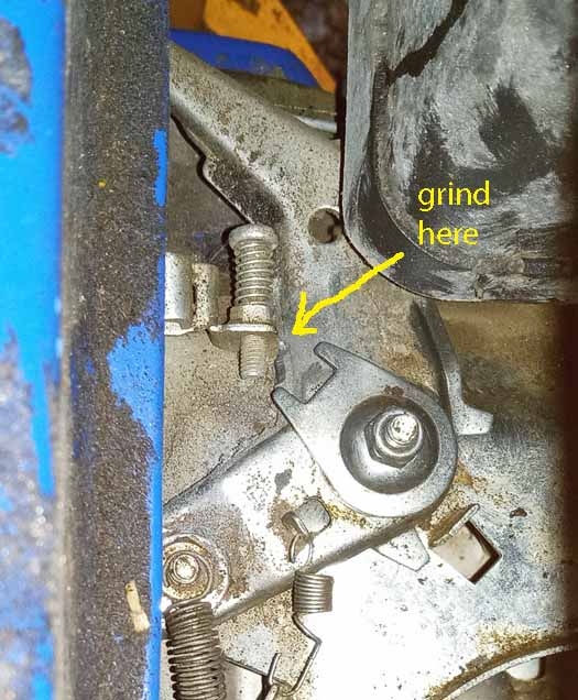

Finally, to allow the engine to idle at lower RPM, I removed my throttle lever and ground a bit of metal away where the lever hits the WOT stop (photo).

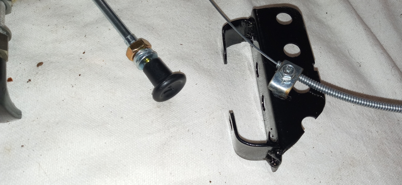

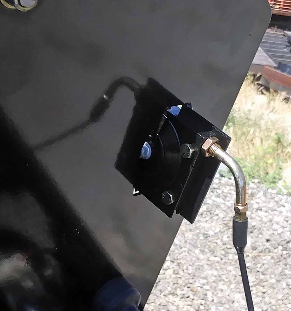

...and finally the choke control:
I purchased a new generic choke control "cable" of the solid wire type seen on mowers ($10). This type is very superior for push-pull control. These newer thumpers are set up very lean and they are very sensitive to having a fully closed choke in order to start.
Briggs supplies a choke cable housing clamp bracket that goes on the end of the carb studs. I don't like it since it does not align well with the choke lever on the carb. So I made one (photo), which works well.
My new choke control is on the front housing panel, which is more convenient, and not on a horizontal surface. Many Chinese minis put the choke knob on the top of the house, which will eventually fail due to the entry of water.
Suggestion to TheGarageConnection: put together a complete replacement throttle kit that makes these improvements.

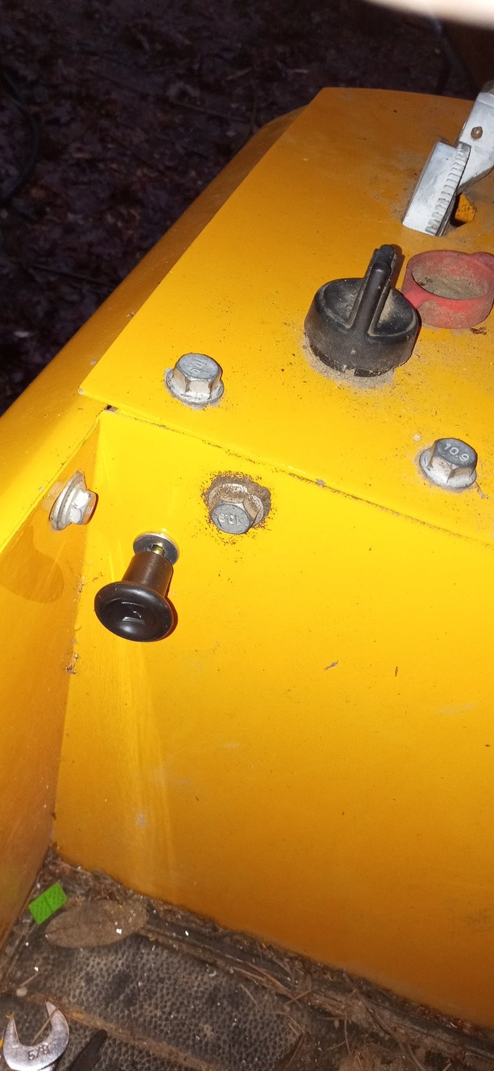

Interesting. The very first thing I did with our Typhon copycat when we got it to was relocate the choke from the front housing panel back up to horizontal next to the ignition switch.
We have the full glass cab on ours and because of the way the cab fits, there is NO way to remove the floor access panel under your feet without first removing the front panel under the seat... which the choke was attached to. Having the choke on it just made it far too difficult to remove that panel first.
The change had to be made so we could leave the cab on for all basic maintenance and only lift it off for serious repairs. The cab also makes removing the rear engine cover and rear side panels impossible while the cab is on. So the oval exhaust grill on the back and the interior foot and under seat panels are all you can take off easily. It's enough for easy oil changes.
However I can see the advantage to having the choke there if you don't have a cab.
