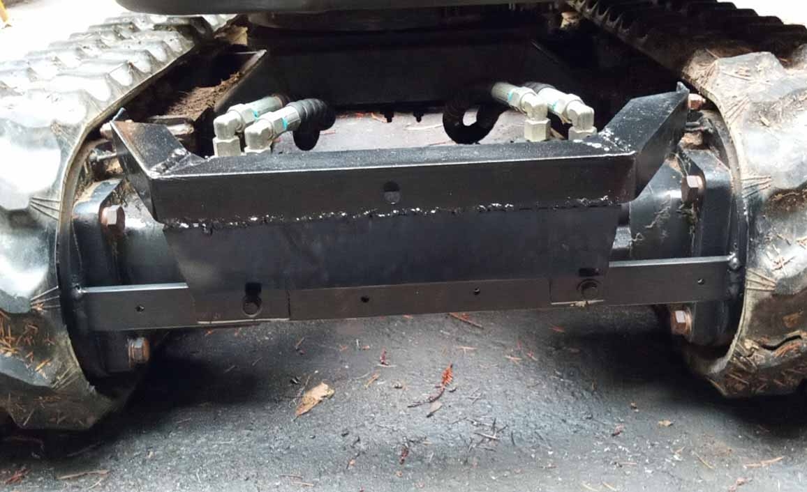

I just added some more protection to my nearly 6yo XN08 mini-X.
Mostly, I was adding protection from bending the wheel motor supports. Photos on the internet (FB) of bent frame "tails" are concerning. My guess is those users have upped their system RV pressure above the 2400-2500psi recommendations. Mine is measured at 2400psi, and I have stalled the motors a few times when small rocks get under the tracks.
There seems to be a newer style of frame tails that has steel plate wrapped around the mounting plate. I also have seen some pix of the earlier style with a reinforcement bar added. Photo is a Loongsheen 06 from 5 years ago. So this problem is known.
Now, I am working on the blade cylinder, where I just replaced a damaged hose.

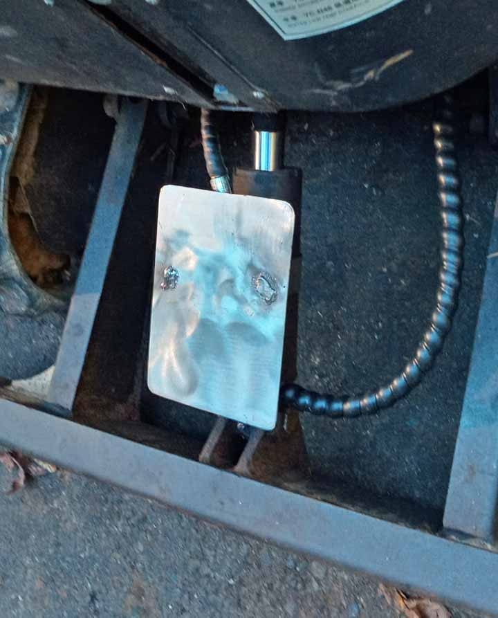

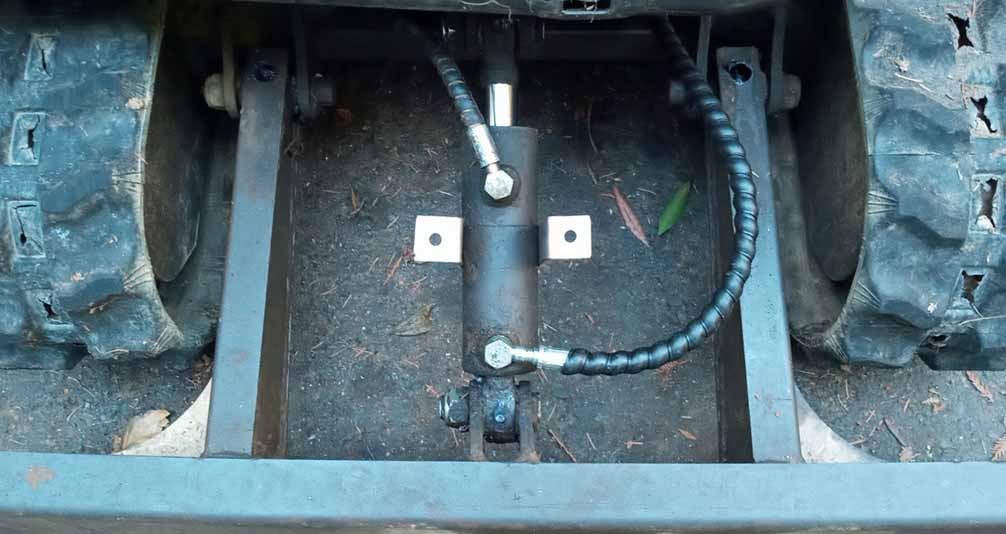

More hose and fitting protection. This time for the blade cylinder.
Naturally, I waited until I damaged a hose before I did this modification. It is nearly impossible to avoid getting dirt and rocks in this sensitive location.
I used some stainless steel plate that I had. You can't see the standoff block between the cylinder and the plate. I love stainless.
I will probably rotate the lower hose on the banjo fitting so that it is more protected.

   / Importing and modifying a new mini excavator from China #1,136
The great motivator, having to fix something you've broken.
