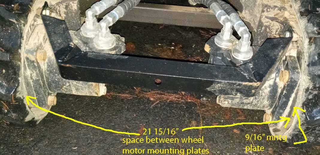

I've noticed that the newer machine have a redesigned sprocket section, it apperas to be much more robust. See attached pics. Do you think it would still be wise to add bracing accross the rear to keep the spacing.

It seems to me that there must have been numerous cases of bent frames like this, resulting in this improvement. I don't even want to operate my mini again until I reinforce these tails. I am gonna weld a plate between the tails. Perhaps other owners can report the space distance between the tails. Mine is currently 21 15/16". I hope it is not already bent.

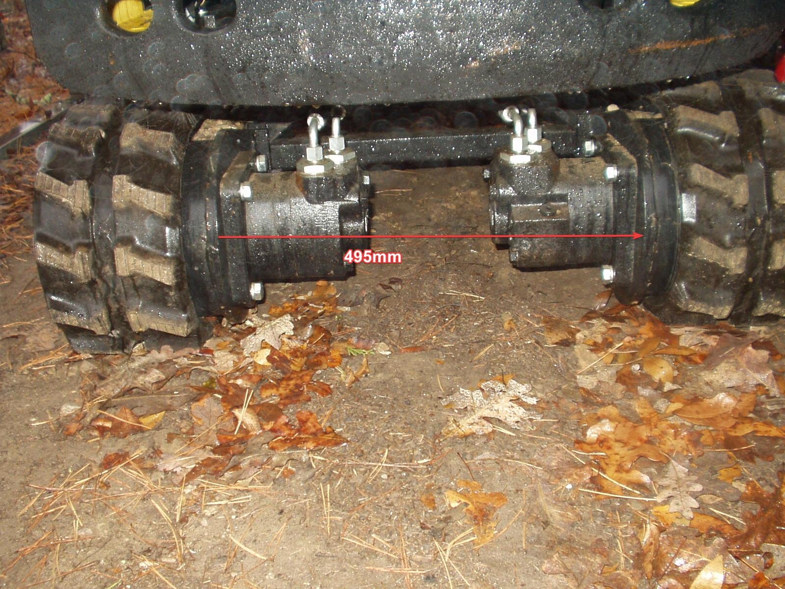

Not exactly sure where you are measuring from but my Typhon is ~19.5 inch between where the drive motors are mounted and about 6.5 inches between the motors.

It seems to me that there must have been numerous cases of bent frames like this, resulting in this improvement. I don't even want to operate my mini again until I reinforce these tails. I am gonna weld a plate between the tails. Perhaps other owners can report the space distance between the tails. Mine is currently 21 1/8". I hope it is not already bent.

Corrected my spacing above. 21 15/16" between wheel motor mounting plates. My plates are 9/16" thick. Photo attached.
19" is your motor mounting plate spacing? 6.5" between motors?

Using a metric ruler I get 495mm.
You could verify for yourself by removing the tracks and placing a straightedge on each drive sprocket and then measure the distance between the fronts of the straightedges and the rears. If they are the same (parallel) then no bend. Yes, this is probably a lot of work to remove the tracks but then you'd know for sure.
Sure, but removing/reinstalling tracks is no fun. BTDT
Everyone should check frame for straightness here if track comes off for any reason. Or take an above measurement and watch for changes.
