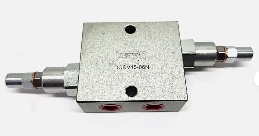

I just put it before the swivel motor, no tee needed. The old hoses in one side and 2 new hoses back out to the motor. Here is the model for the RV DCRV45-06N.
Oh, you mean a dual crossover RV. I was thinking individual shock-RVs, but they drain to the tank. Yours is a Summit DCRV45-06N, which seems to be preset at the factory to 1300psi, with a max setting of 2600. Looks like that would work, and be a simpler installation. I would probably set mine to just over system pressure (2400psi in my case).
Do you have plan to measure the pressure you get with each setting?
Those photos from Facebook of damage to the motor and ring/pinion gears make me want to put one in, too.
Yes I do plan to measure pressure at different settings. I have turned it up a bit from the setting in the video. I now get much better speed swiveling than in the video and still maintain a great deal more control when coming to a stop than I did without the valve. The photos of damaged parts certainly helped in the decision but lets be honest, we just like working on these things.

so how do these work? they use springs? and bypass into the opposing side till the springs clamp shut?

I have been planning on adding a crossover relief to my QH12 since I got it. I was surprised the motor doesn’t have some sort of port reliefs. The pics of broken bits on FB makes me more determined to make the change.
You May find best settings for the reliefs will be below system relief settings.
Well, the factory setting of 1300psi is way too low, as you found out.
I suspect that without some cushioning, it is inevitable that the ring/pinion or motor shaft/mount will get hammered to death. Maybe after 200 or 300 hours. Who knows? Maybe those posted failures were on units with way more that the 150 hours I have. Nevertheless, I want to protect from that problem.
Also, sloppy fitment between the ring/pinion gears would contribute to the hammering effect. The fitment on my machine seems to be tighter than yours and others'. And it IS built in China.
Measuring the shock-RV pressure after adjustment is not straight forward. The last time I bought a single crossover RV from Hydraforce, I was able to specify the RV at the factory to the 2000psi I needed. How do you propose to measure your new pressure setting?
Maybe, but if you set the shock-RVs to lower than system pressure, you will not be able to utilize full system pressure when the valve is actuated.
