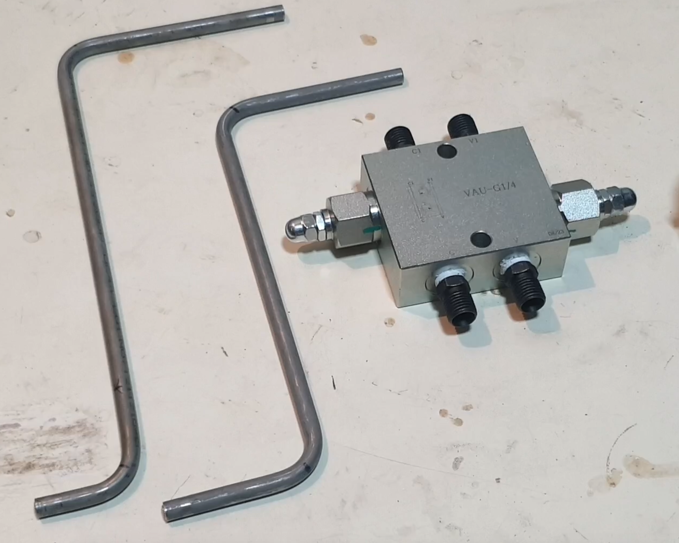

It seems to me that the only way to test the shock-RV settings accurately is to TEE in a gauge at the IN port on the valve stack (or pump OUT) and operate the house motor to relief. This needs to be done after adjusting the main RV up to or above the target setting of the cushion valves.
My target setting would be 2500psi for both shock-RVs, so I would start with the system RV bumped up to 2600, then operate the house motor to see what I get. Should be about 1300psi, if I use the Summit valve above. Then adjust and repeat until I get 2500psi. Same for the reverse rotation.
Then reset the system RV to 2400psi.

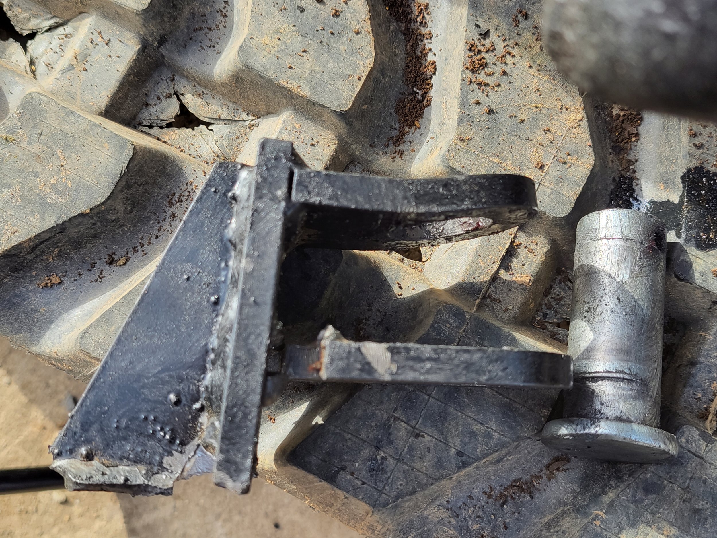

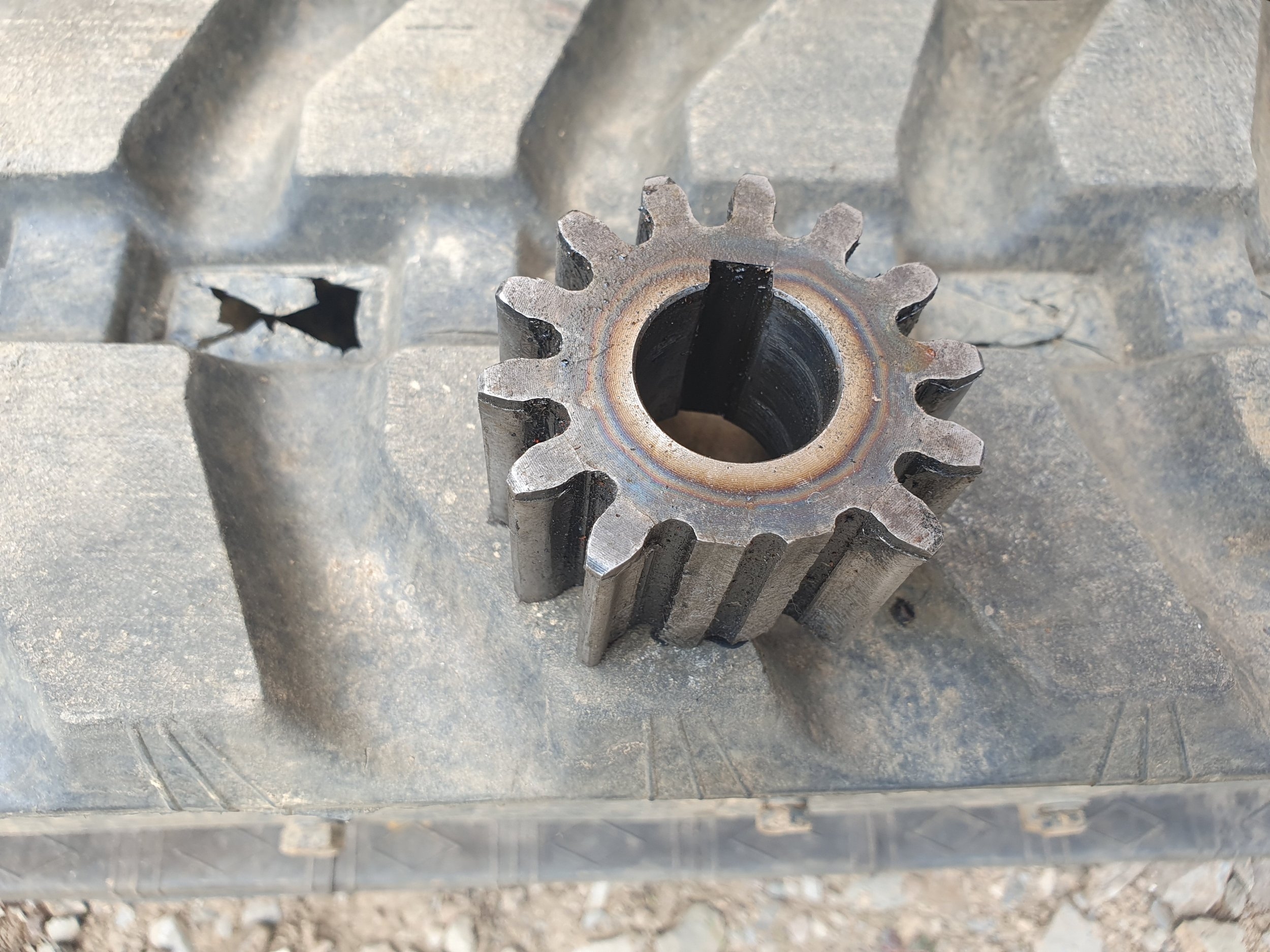

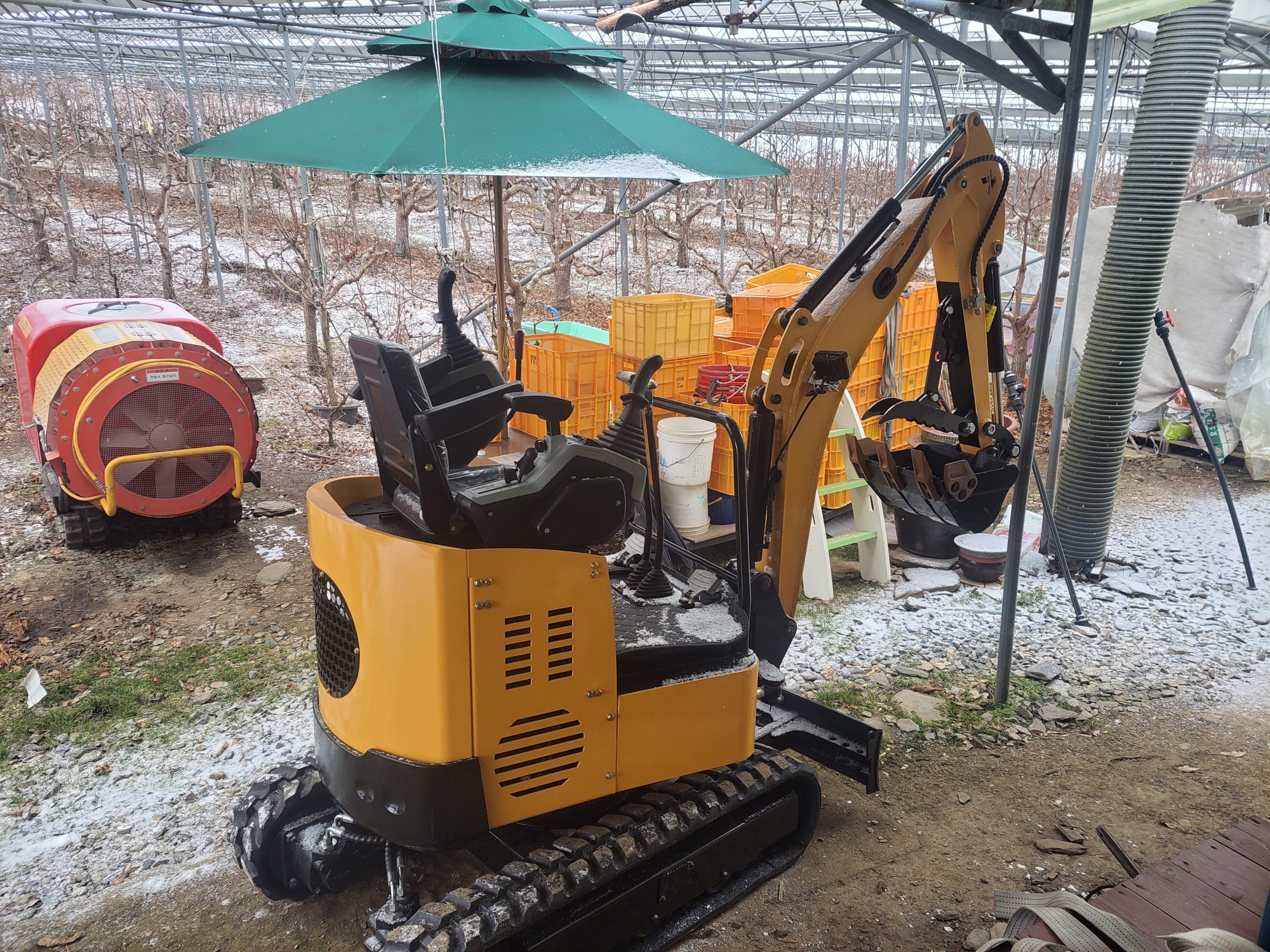

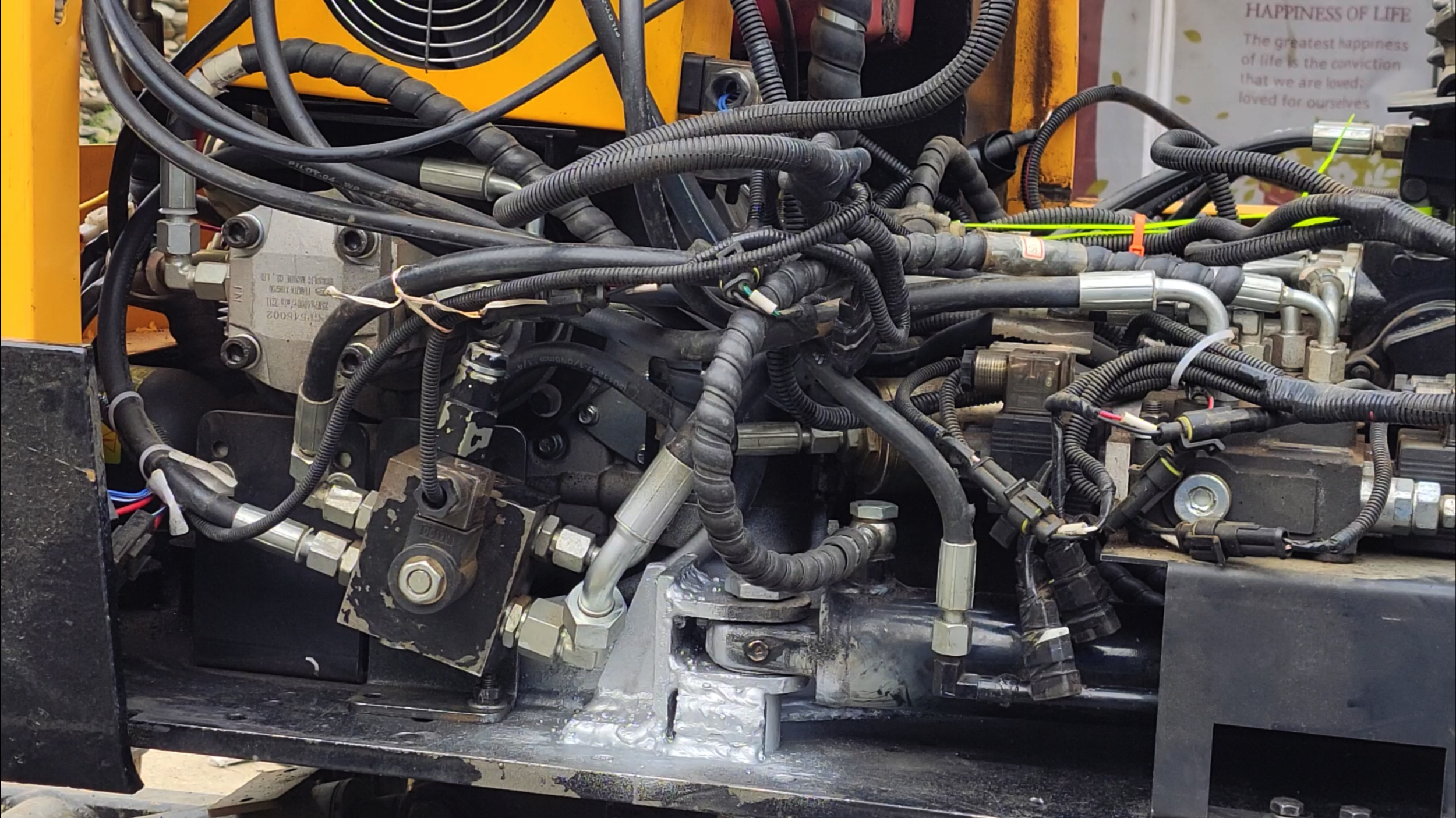

Hi, I'm new to here. I bought the Leking KV128 last year, so it's been almost a year now. Please bear with me if my English isn't perfect. I'm Korean, BTW. The model I purchased seems to have been discontinued due to too many issues. The swing pinion and boom swing bracket broke, and I had to replace the travel motor. I also installed a crossover relief valve. Now, I'm using it well.

Maybe, but if you set the shock-RVs to lower than system pressure, you will not be able to utilize full system pressure when the valve is actuated.
That is the downside of a simple system.
IME, swing tends to run at a lower pressure than system. And the cushion runs even lower. But the valving involved is far more complex than is easily available to us.
since the primary purpose is to protect the swing motor and gears, my guess is about 150 PSI below system would be a good start
Hello and welcome. Your English is much better than our Korean. I have watched all of your videos , you have been responsive and helpful. I installed a crossport relief valve on my machine after watching your video and am very pleased with the result. I made a short tutorial and posted on another forum, I gave you credit in the file. That has incouraged many others to install a relief valve on their machines to protect the moving parts. Keep up the good work.
Thanks for posting, JAMES, and welcome to TBN.
Before the pinion gear broke, was there noticeable slop between it and the ring gear? How many hours on your mini?
Since your machine came with the boom-swing option, it sure seems that that circuit needs some cushioning, too. The boom-up/boom-down could use shock RVs, too, but I do not think the jerkiness in that circuit will break anything.

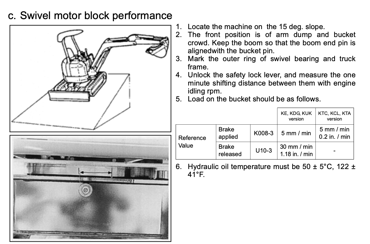

Thank you. I'm glad I could help you.
I recommend that you also perform the attached tests for your safety.
