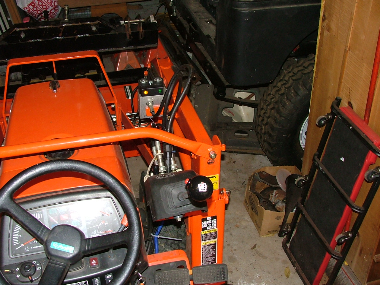

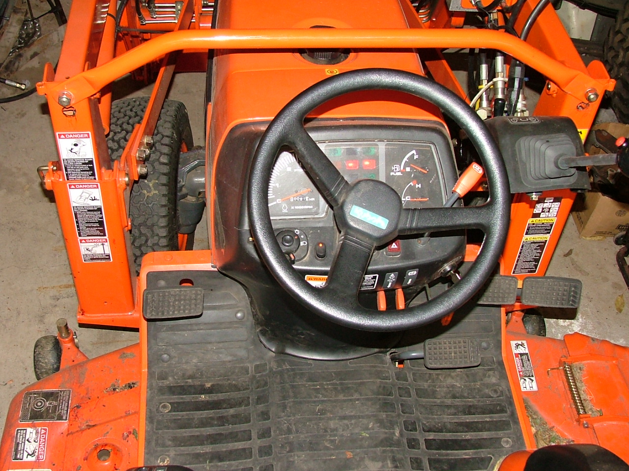

Here's what I used with my fasse valve, which is mounted on the FEL arms on my Kubota. I found a Hurst shifter knob with a thumb button, this would normally be used for a nitrous setup in a car. It was about $40.00 + shipping from Amazon but it's widely available on the net. I also installed a rocker switch in parallel on the dash for when I want it locked into the 2nd outlet. Also installed a set of pilot lights on the valve so it's easy to tell that they're working. I used a bosch relay from the switches to control the power to the solenoids. If anybody needs a schematic and I'll draw one up.

Nice setup Don!
I also forgot to mention that WR Long also has diverter kits for you FEL as well...just another option to consider.
