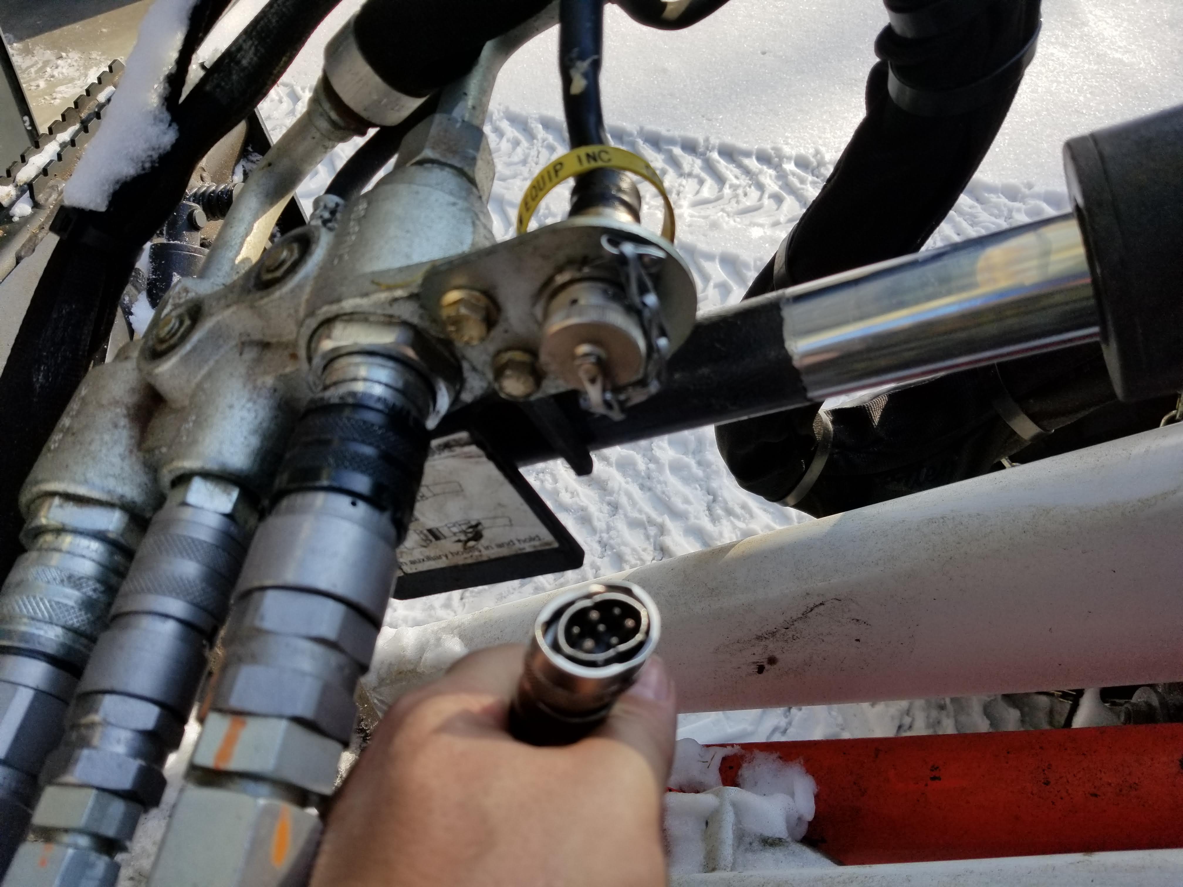

Just an FYI if one of my fellow Toolcat aficionados or Bobcatters in general pull a boner like me and crush their 7-pin connector between the SSQC and your attachment there is an alternative to the $300+ cable replacement.. Not associated with this company but I did order the connector on Monday for $98 and was in my mailbox yesterday.. 1 man band.. for people running non skid steer attachments also make harness kits and what not..

Just an FYI if one of my fellow Toolcat aficionados or Bobcatters in general pull a boner like me and crush their 7-pin connector between the SSQC and your attachment there is an alternative to the $300+ cable replacement.. Not associated with this company but I did order the connector on Monday for $98 and was in my mailbox yesterday.. 1 man band.. for people running non BOBCAT skid steer attachments also make harness kits and what not..
Yep, I bookmarked this page a long time ago: Bobcat(R) 7 Pin Adapters – Skid Steer Genius
