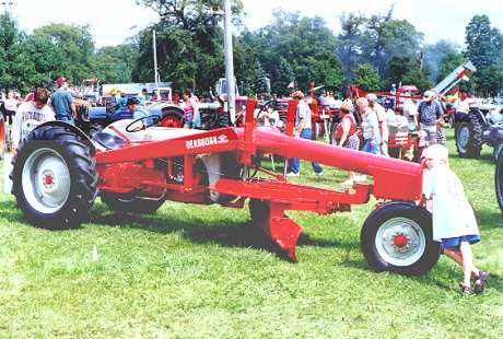

wroughtn_harv, not a skid steer, but is this something like what you had in mind? It's a Dearborn Road Maintainer on a Ford 8N.

Thanks, that maintainer is finer than a frog hair split three ways as a bud of mine would say.

The blade that was given to me is exactly like the unit you have pictured. I think they must have been siblings. The rust pattern is so close that it has to be genetic.

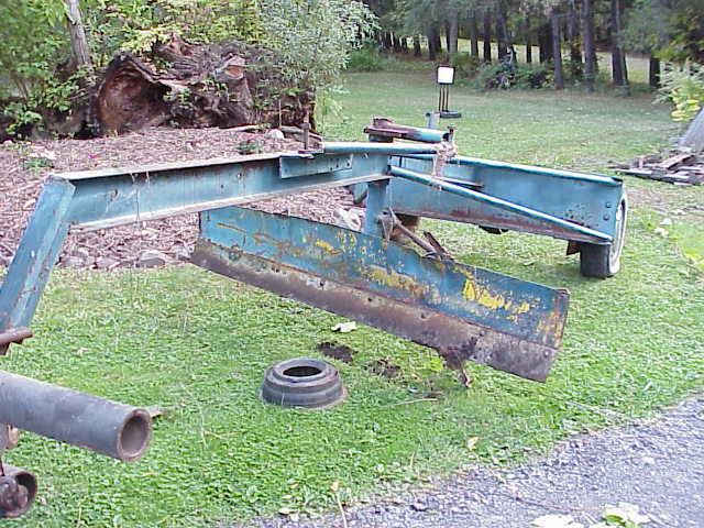

Well shoot Harv, if you didn't insist on using a skid steer for a power unit, you could just build one like this, and tow it with a tractor.
Or, you could reverse the blade, and make the wheels steerable and push it with a skid steer.

Thanks for the picture Franz. Images of rigs like that keep coming to mind when I'm trying to smooth out an area and make it level too.
