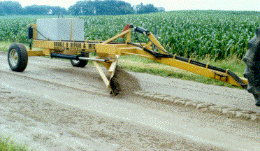

Franz,
Your grader picture is great. That's the kind of thing I would like to have to flatten my yard. Here's a picture of a commercial version that I've been pondering over.

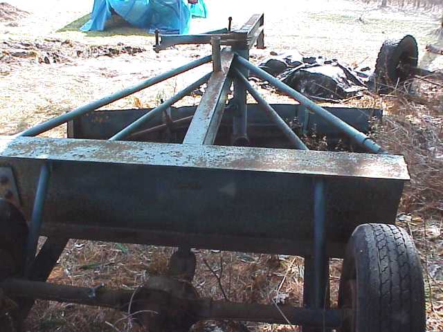

/ Idle hands......... #42
A couple things, first, you don't need downpressure at the hitch point of the grader, you need major weight at the wheel end, or you will pick the wheels off the ground QUICK. Notice the big concrete block on the commercial version.
Secondly, length is very important. Mine is 13'6" from hitch to center of wheels. The length of the machine does a lot to minimize washboarding.
A lot of what I did in building mine was governed by what was on the scrap pile, nothing on it came from anyplace else, other than the pin that keeps the rotation locked in place.
Don't get hyper about adjusting from the seat, because the only adjustment you tend to make once you are grading is up/down. My blade rotation is 6 positions, held in place by a pin, and the tilt angle on the blade is accomplished by a screw type load binder.
This machine has moved a lot of material, over 10 years, and hasn't had any modification. I can cut a swail in red clay with it, as long as the clay isn't baked out. The only modification I'd make, if I had the material, would be to add more weight at the wheel end.

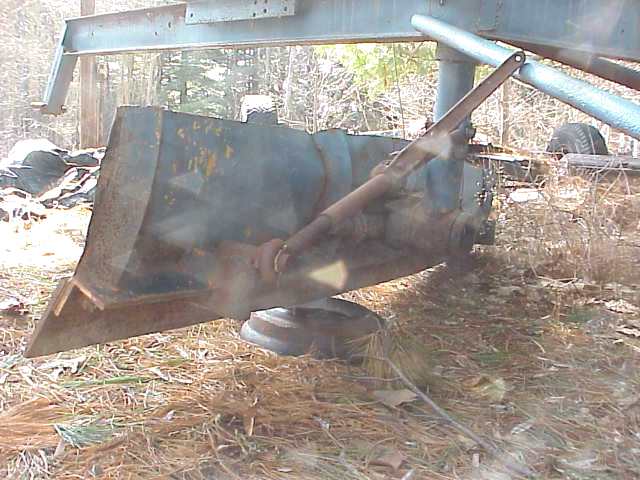

/ Idle hands......... #44
Mine pulls from a Lunette Eye (Mack U bolt) because I have a pintle hook on the back of my Yanmar. A ball hitch would work equally well, but Mack U bolts are free, and I love free.
Weight really needs to be over, or just behind the wheels, because very little weight is necessary to keep the blade down, strange as that may seem.
My blade is a 7' snowplow blade that was involved in an incident with a hydrant. I cut it so it is about 12" high.
As far as towing over the road, since I used a rear end from a Duster for the axel, I could accomplish road towing by extending the goosneck drawbar, were I inclined to take it over the road. The blade itself could be easily configured to paralell the beam.
/ Idle hands......... #45
Blade mounting and tilt mechanism.
