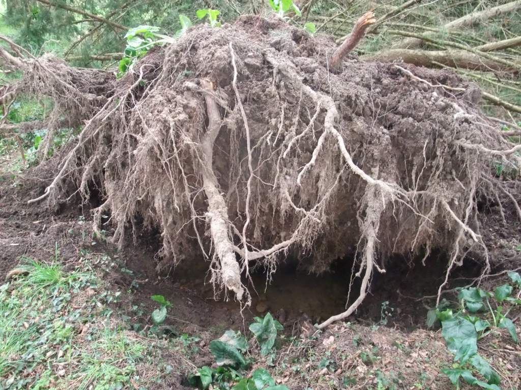

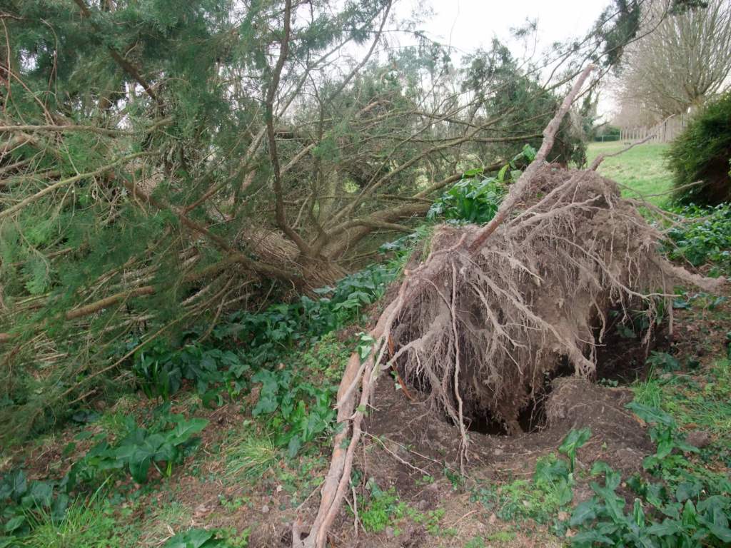

The picture I'm seeing is that of limb size on the Hemlock and the Hemlock has very little to do with this hanger but the root ball is what is supporting this cantilever.
If the tree isn't causing a danger to human or animal life I wouldn't touch it and let nature take its course. How many owls would we suspect may perch on that snag watching for rodents before it finally gives way sometime in our life.
And before we know it a seed will lodge in the root ball void to be nourished by leaf litter and another species will emerge to prevent erosion on that steep hill side just as the fallen tree did for years.
I agree, this would be the best use of that tree.
/ Ideas for felling this tree #43
If you cannot invent a suitable and reliable support for the root ball, ( trust me, it is meaningless to attempt to put dirt back in thinking it is enough of support) then I'd have to agree with 20-20. Have it done. A skidder with a 20 ton winch brings a whole different meaning to this scenario. When this type of fall occured, we'd prop up the tree (root ball) with the skidder if they were small enough to drop (4-10" dbh) we'd side cut them on both sides first (about 2" deep) and then notched and felled them. With a big tree, we never did that. If the winch couldn't pull the rest of the tree down enough to cut the crown off, we'd notch the trees as if they were going to fall side ways and then winched them over until they snapped off. With this method, it was not important to prop up the ball as no one was close enough to get hurt. With the side notching, the tree still supported the root ball. Then it was simply positioning the winch to pull it sideways. These winches were strong enough to snap a 9" tree all by themselves without any cut. The smaller skidders could snap a 6" tree. The safest way to do this job is to have the correct equipment. Some things were not meant for the homeowner , as independent as he may feel, to go up against. Use your head here until you either know your chances of getting hurt are nil if you do the job. Your chances of not getting hurt are excellent if you have it done. That's the only part you know for sure.
/ Ideas for felling this tree #44
Interesting problem.
With the apprehension of the OP I think C4 or a black powder charge applied about where the tree splits would be appropriate. It would leave two stems to come down and the separate rootball.
However based on
if I was to try and take it down with the OP's assets (pole saw, chainsaw, tractor, ropes, chains, lots of apprehension) I'd toss ropes over the stems sightly down from where it's hung in the hemlock and then slightly above. Tie those off with tension so I could cut between them with the pole saw (looks like they are only about 4" to 6" thick up there) and be sure the top pieces pulled away and didn't drop on my head and the bottom pieces didn't do anything wild. Then clean up the top pieces, let the bottom pieces stand up if they needed to, then make them small.
If the entire base is 18" across before the split then the two stems look to be be less than 8" each slightly after the split.
If I didn't have the OP's apprehension I'd tie the two stems about a foot above the split to that nearest small hemlock up high so it was bent over a bit, tight enough so when I cut the stems they would be pulled over to it. Then I'd use my 660 to slice the stems about 6" above the split.
But before you do anything have two chainsaws, so when you pinch one you can cut it out with the other.

I know how I would do it, done it plenty of times. But me trying to tell you how to is not going to me much help if something goes wrong. When I say "goes wrong" I don't mean deadly unexpected wrong but something like the tree shifts or you pinch your bar. Small things that will require you to change your plan, once you start you really can't come back here and ask for advice easily.
Are both trees hung up or just one? If just one, which one? Can you get your bar in to cut the bottom tree from the top or are they too tight? Do you feel comfortable making a plunge cut if they are too tight? If you cut the top tree first which way will it want to go when it hits the bottom tree? You said something about being steep, once you cut either tree will the butt of either tree kick up? Are you the nervous type (will the sudden movement of the root ball flopping back into it's hole cause you to react even though you expect it)?
Those are the kinds of questions I would ask myself before starting to cut them.

I took it a different way today as I woke up on the other side of the bed. I simply went out today and said I have so many issues going on with this such as the counter weight root ball, the compression, tension with the hang up, the cliff edge and areas of safey being limited.
I said to myself, what if I could at the very least remove any of those issues perhaps one at a time,so that any additonal problems can be clearly identified without compounding another problem? And err of a conservative approach?
With that in mind I placed a cableon the tree out towards the hemlock on the bottom lead, and ran the cable from the angle of the picture above. Hook up to the toyota and pulled....did not move it an inch. So I ask myself if perhaps I can tie off on the upper lead and rotate it out of the hemlock? I was able to break off the upper leader. Then with that done,I tied off one more time only further towards the top of the oak hoping for more leverage. It rolled off the hemlock...and actually pulled the toy backwards about a foot in the process.
Now I eliminated the hemlock and the main leader is much close to the ground, I just have to clear of a safety zone for cutting it off the root ball. There is no dubt in my mind the root ball is gonna flop back to where it was now. With that in mind I want to clear the area in the picture between the root ball and that dead pine stump to sever it in that area. It will be about 4' away from the ball. With that in mind, should I notch the bottom of the log about 20-40% through, then slowly make a top cut about 6 inches towards the top of the tree? That should make a hinge but I guess I need to proceed slowly an ensure the top of the cut opens? Keeping my distance at arms length in case the stump end should roll when it comes up? I do feel better with it down now,but still nervous with the rootball caterlever acting on the whole thing. The tree end will also want to spring up towards the sawman as the top is hanging off the ledge as well.
Thank you all for all your comments and suggestions on this one,I never realized I would ever have so many ideas, and hidden dangers, but it help me break it down into different dangers it posed, thereby giving me the idea to work further back and remove one or two of the dangers at a time so they would not act on one another creating a truely unforseen and deadly incident.

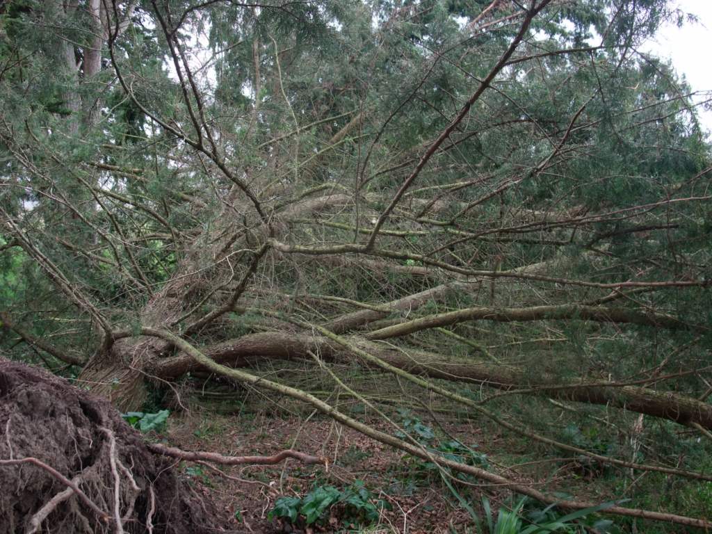

I wouldn't mess with a vertical hinge and horizontal pull unless you are 100% sure the tree is loaded/balanced symmetrically. If it's not, something pretty exciting is going to happen while you're sawing. This would be no different than using a traditional cut on a tree that wants to twist, lean, or sit on the saw while you're cutting. Best case, your saw gets stuck. Worst case, something leans or twists and then it blows up on you.
Really, the best option would be to isolate the loads before cutting, so that the saw is not tickling the tree's funny bone into failure. It could be as simple as blocking up the trunk and propping up the rootball with some timbers. You want the wood fibers to not be in tension or compression where you are cutting.
If in doubt, then I would work with gravity and use a Coos Bay cut with a traditional hinge, as if you're felling towards the ground (so the hingeline would be horizontal in this case). In that scenario, you're accepting that the fibers will be in tension and compression, you know the load bias (due to gravity) is acting perpendicular to the hinge, and you're making a cut that manages the tension and compression to prevent a shear.

Pull it down hillwith a come-along. Get behind the rootball with an axe and cut roots. It won't take much until it falls over.
If you comfortable with a saw, put a couple large rounds under the rootball so that it doesn't fall all the way back down, and then cut the trunk like any tree.

I was hanging free off the ledge with the root ball acting as a canterlever. I slowing cut the upper lead and watch for movemnet on the root ball, none. So I continued to trim the upper lead back as far as I could. I then was able to put a vee notch about 6' up from the root ball in the bottom of the lower lead about 40% through wall. This was all about waiste level or a bit lower. I then went up about 2" and make a top down cut very slowly, and keeping my distance, it started to open about 20% through. I slowed my cut and assesed the rootball to be sure it was not gonna twist or roll. It started to come up slowly and I increased my speed as it went up untill the hinged broke away.
All worked well, I kept my distance at arms length,and cleaned the work area up before working so I had lines of escape. It was very controlled and actually better than I thought it would be. Thank you all!
