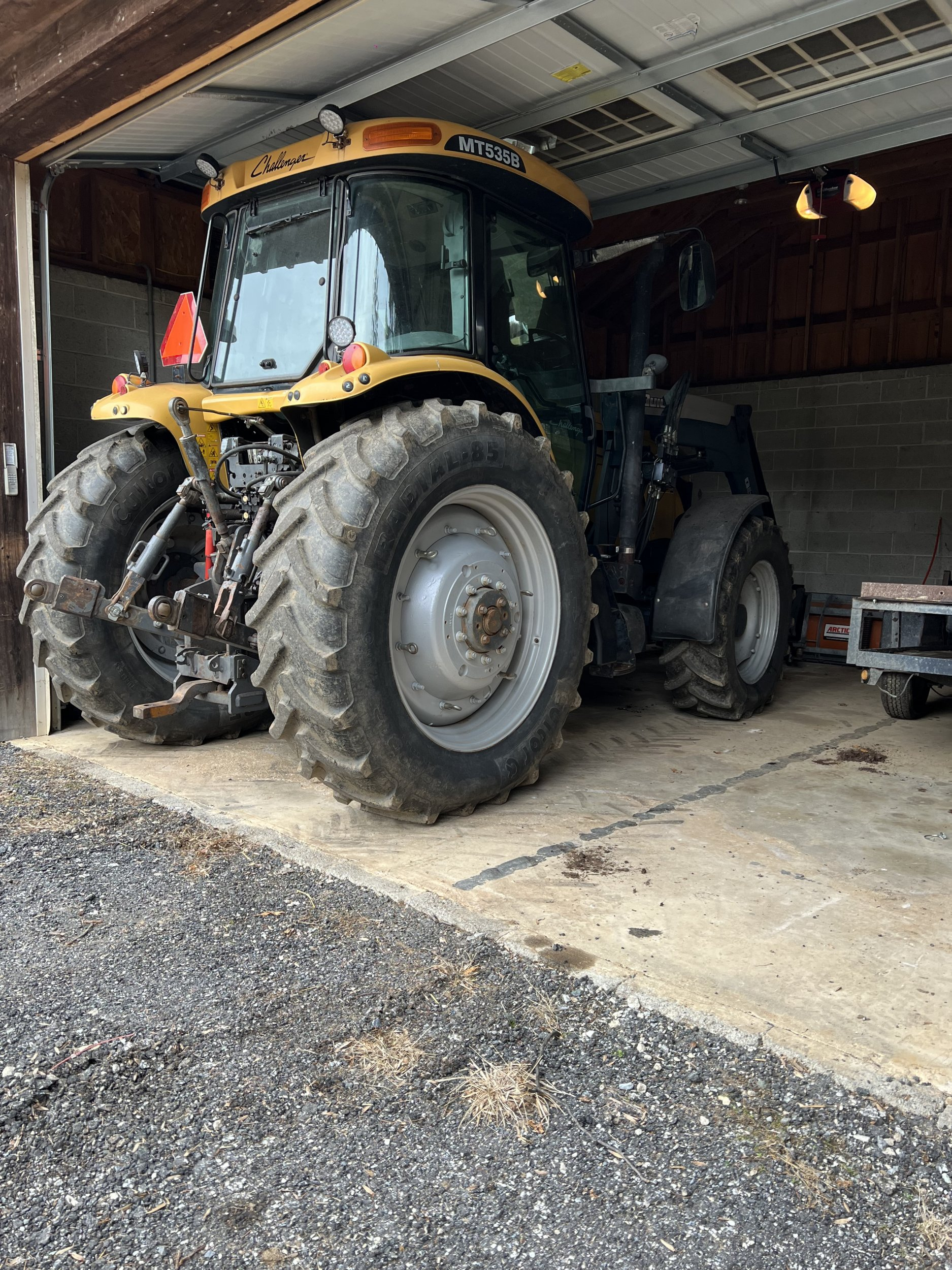

My Challenger has a typical plastic roof shell. Previous owner installed a home-brewed light bar bracket. Looks/works fine except one thing: It makes the tractor about 10’-2ā€ high. I am storing it in a barn with a 10’ door opening for snowplowing season. Figures….
I removed the strobe light from the light bar and leave light bar in place the tractor is about 9’-10ā€ high, so now it fits, but no strobe for snowplowing. If I stuck strobe directly to roof plastic, it would be about 9’11ā€ high-it’ll just squeak through.
I’d like to fasten the strobe directly to the roof plastic to lower my overall height & retain use of strobe. The strobe, normally bolted, has 2 rubber mounting discs about 3ā€ diameter. I presume they are shock absorbing and also leave an opening for the power wire.
I can’t use bolts or drill the roof.
Would large pieces of velcro stuck to the bottom of rubber discs and on top of roof plastic work? I don’t know if velcro adhesive sticks to rubber? It sticks to plastic very well. The power wire could act as a tether if it’s ripped off by a branch.
Or, what would be alternative suggestions would be better to stick directly to roof plastic? Gotta hold pretty good.
Do some research on VHB (very high bond) tape. From what I understand, once it’s on and cured (72 hrs I think) it’s forever.
