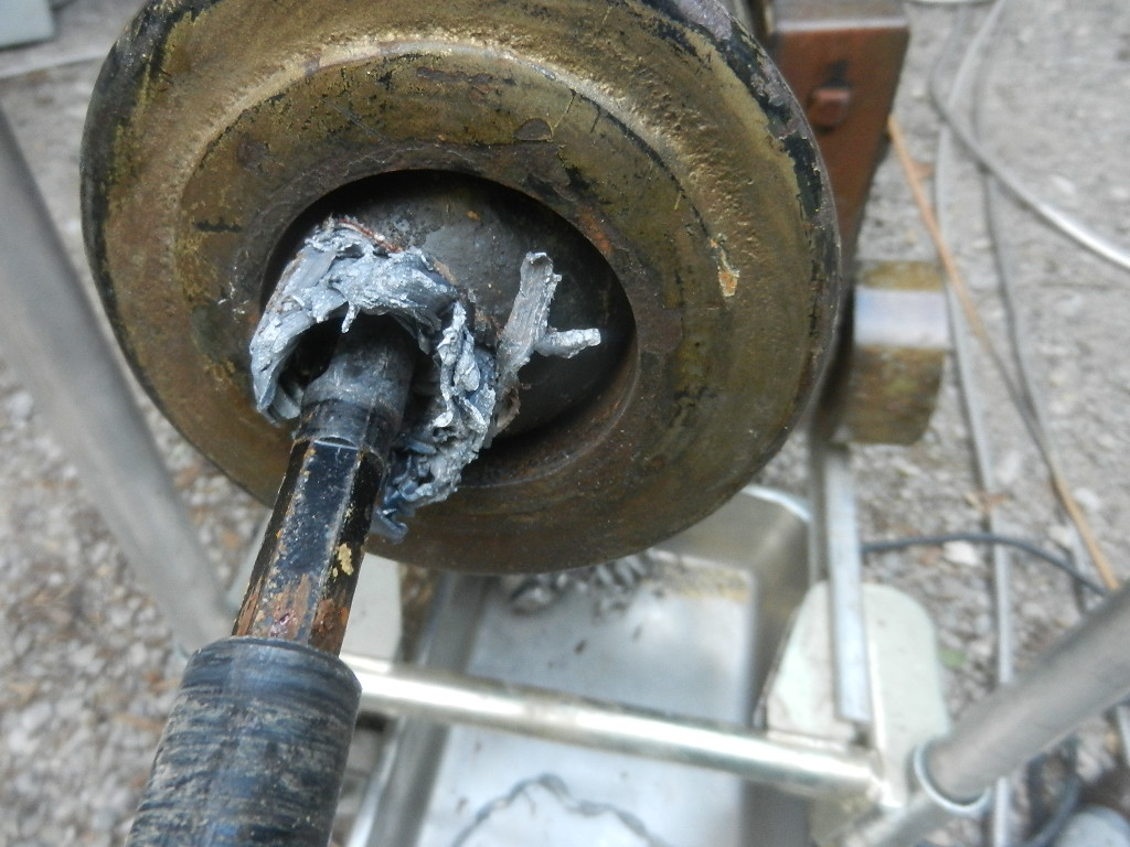

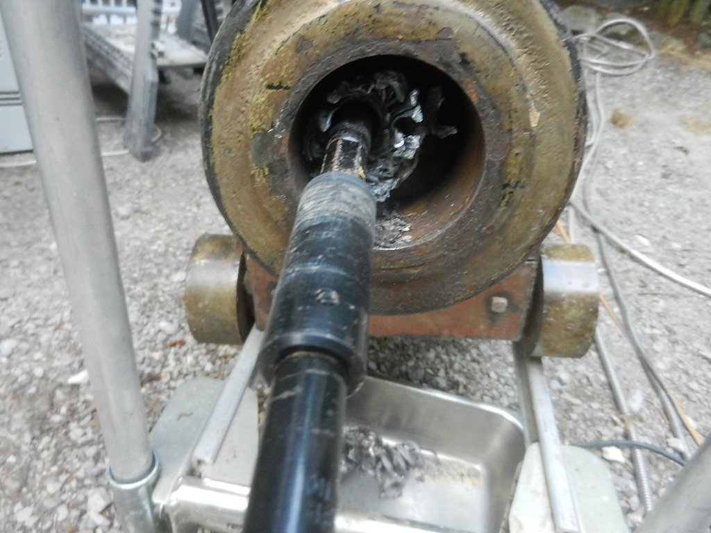

Worked on cannon a bit....and got the second ball out. On getting it out, looked down bore to see condition of what I expected to be the third ball.....and there is NO third ball, so the bore is now empty. Dirty, but empty.
I used the same wood boring bit, had same shavings, and again, the bit got stuck INSIDE the ball. I could push it through the ball (to the end of the bore) BUT, I didn't have the strength to pull it back through the opening that it drilled as the opening had deformed a bit.

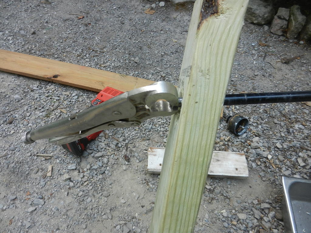

Got to thinking about a slide hammer....and I don't have one. So, I put my extension THROUGH a hole in a board I had and used board as a lever. It pulled the drill right off.
So, I took apart, clipped my vice grips onto the end and now used board as lever on the bore, and it moved. Put another board behind it to push it further away, ball moved more. Then it stopped. So thinking slide hammer, I held board against vice grips (as pictured) and used 5-pound hammer on other side to slowly drive ball out.
I am convinced that there is NO WAY this would have come out using (home tools) such as water pressure, holding cannon vertical and dropping it onto something. I'm convinced there's no way this ball, either one of them was ever going to come out WITHOUT them being destroyed or highly damaged. Once I made that decision to just get them out, I finally got traction towards my goal.
Here's my home made slide hammer.

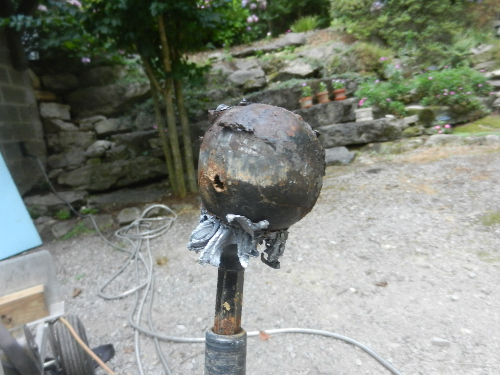

After enough pounding, here's the offender. I still don't know what that hole is for on the ball.
and here's the little bugger in all its glory. Now I've got TWO of them chewed up like this and nine other that are pristine.
