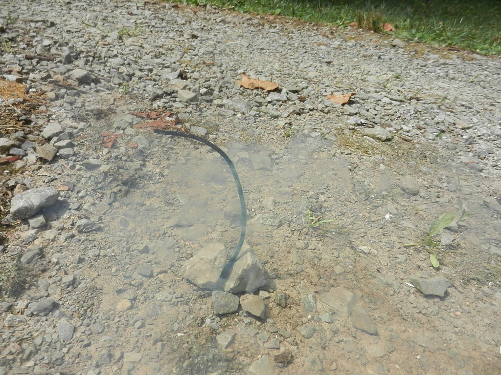

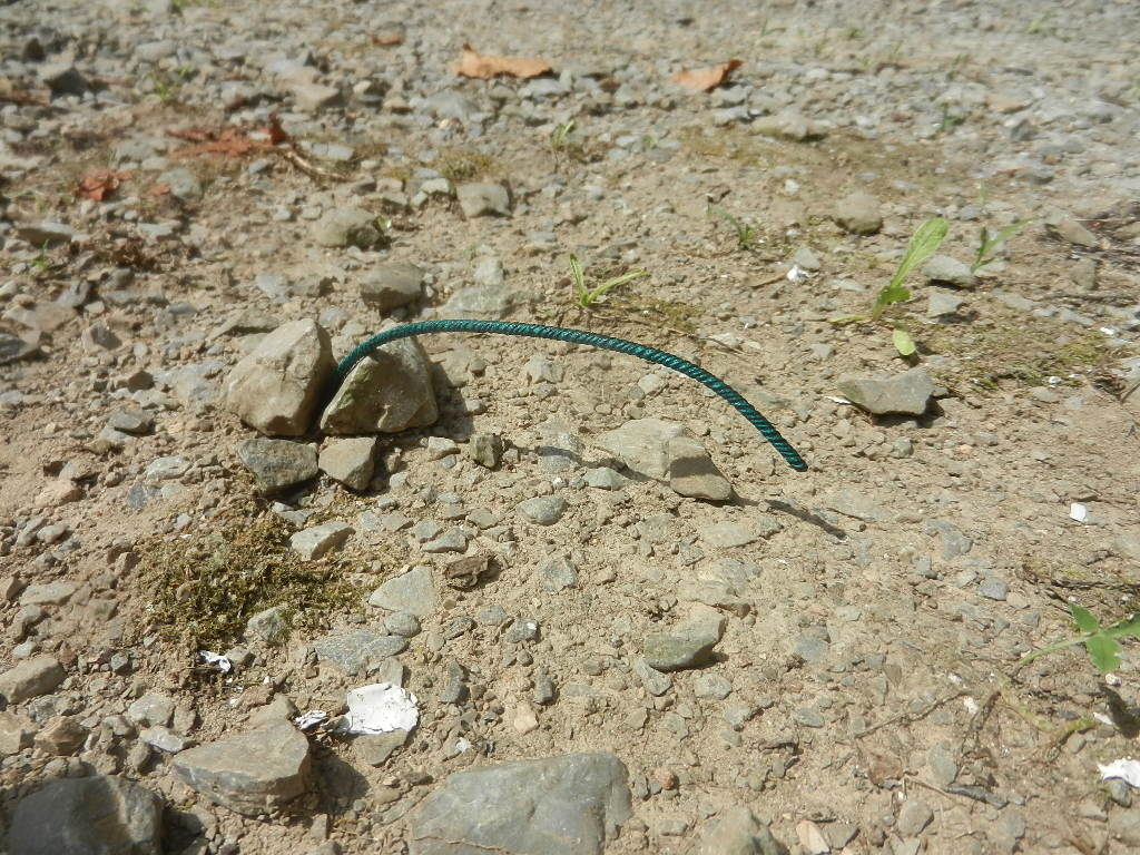

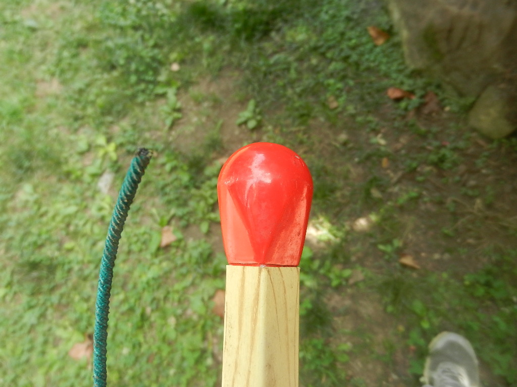

So today was time to see if fuse still works. I have no idea how old it is. To my untrained eye, fuse appears to me to be the type that would burn under water.
Set it up....and it fell over
Now I know why there's an ignition hole on the cannon.....so it will hold the fuse vertical and it doesn't fall over!!!
Set it back up....and viola, we have smoke.
So it's looking to me like I'm verrrrrry close to being able to do a small test fire (no projectiles in it other than maybe a rag)

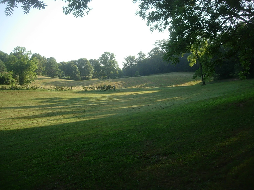

This would/will be fired in a field
As long as it's pointed in correct direction and people are far enough away, I'm not terribly worried about the location. Here is what I'd be shooting "into". Triple that distance and you are finally at the property line but then, you are at a lake on the back side of farm.
House is on the right so this is parallel to the house..... I call this my front lawn.
NOBODY living in that direction (at all) except for 4,6,8 legged creatures.
