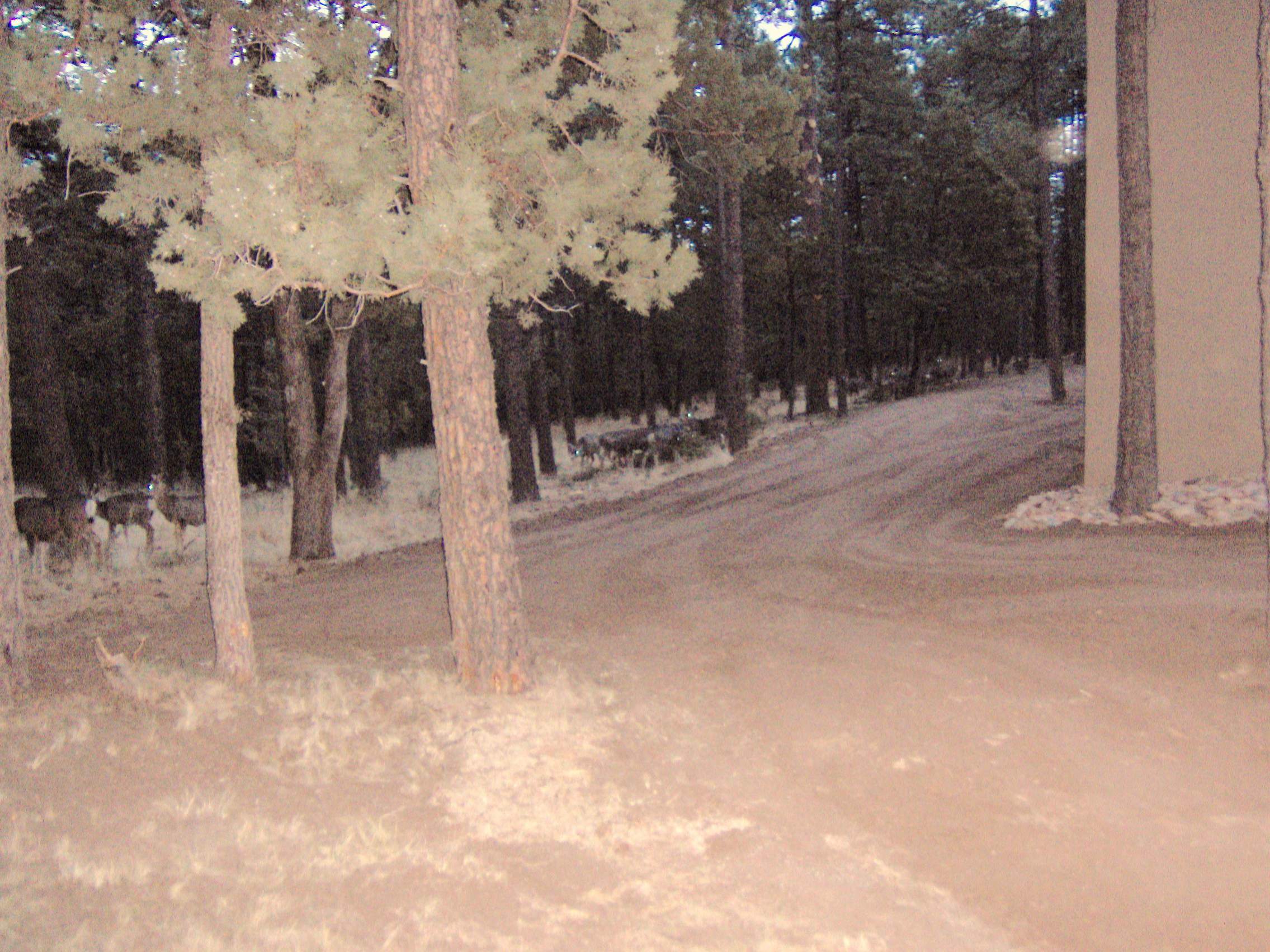

I use a landplane grader scraper to smooth out lawn areas, gets it flat without leaving it overly compacted. Then run a smaller 18" towable plastic roller filled with water to improve seed contact. Best if the ground is slightly damp too. Here's some pics showing the ground after rolling and some where the grass is up later.

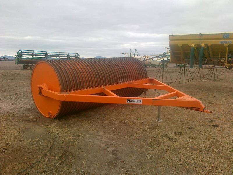

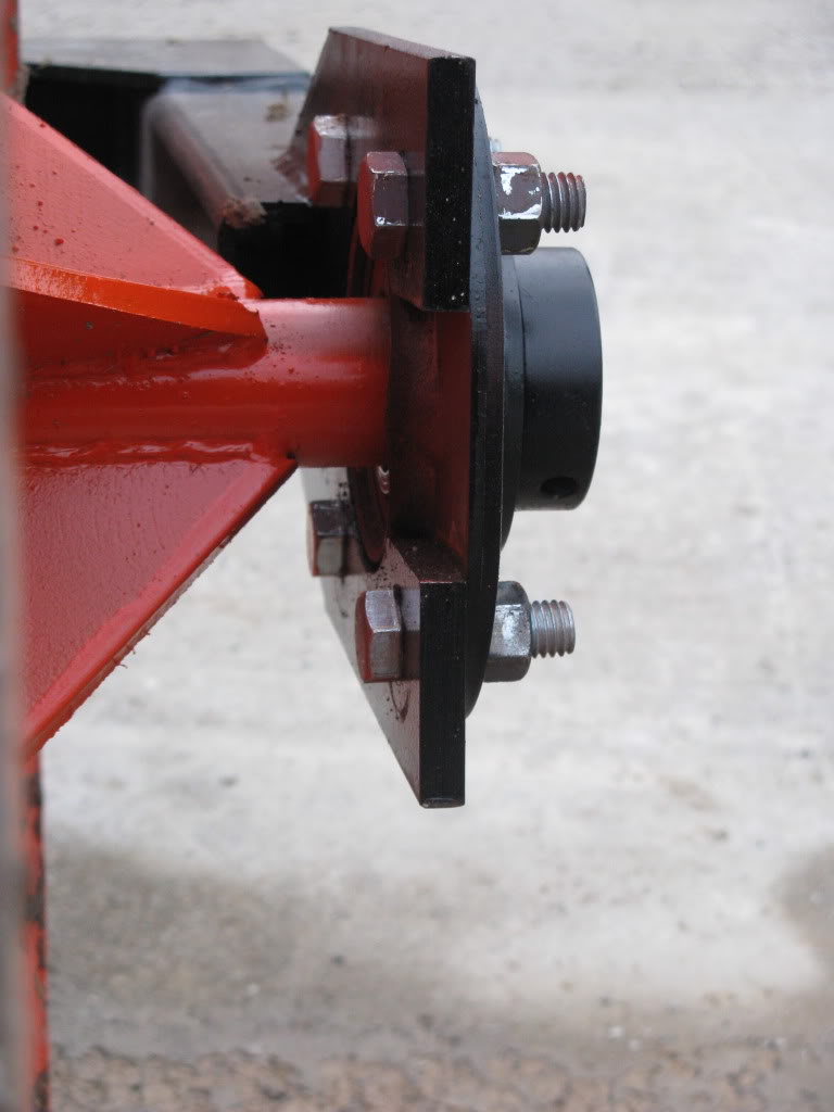

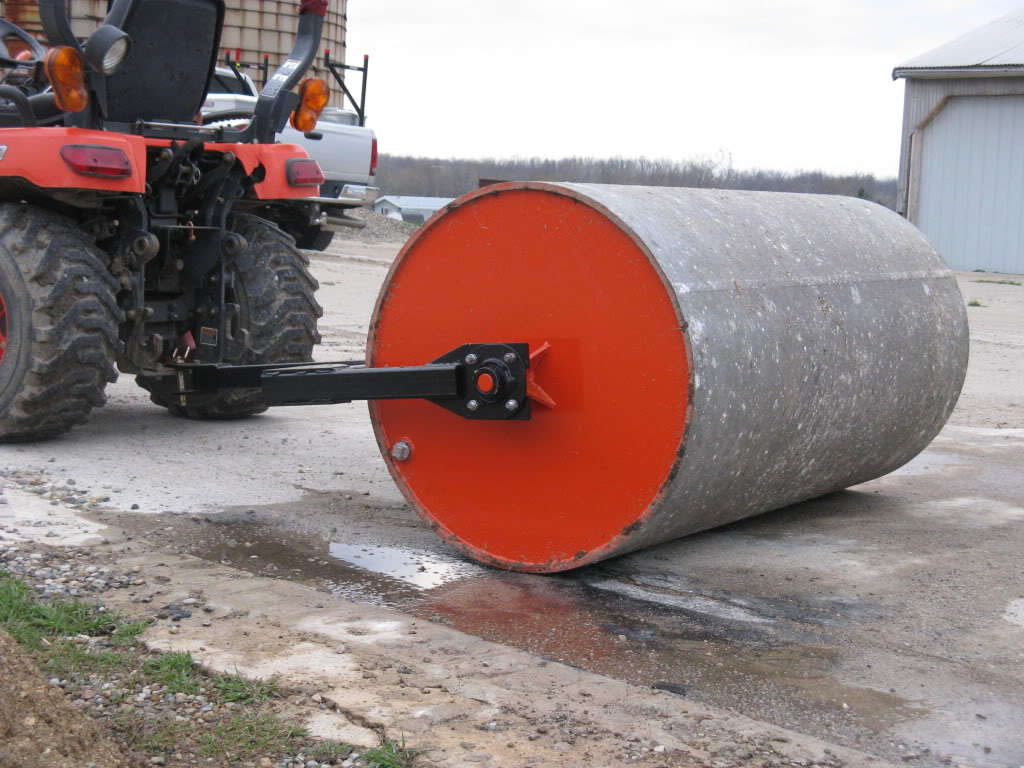

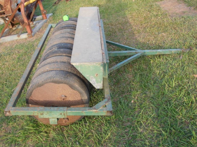

Rollers are reasonably easy to make - pipes, cylinders, tyres all can be used - below is a few we use around the farms:
- c.40" smooth steel pipe roller filled with concrete & capped
- c. 12' ribbed steel drum roller water ballasted @ c.9T/empty c.4T
- c. 6' tyre roller, tyre are low pressure filled with water, rims welded to centre tube & end capped welded to old plough discs/bearing carriers (& fitted with seed box)
For levelling lawns we built the small carry drag scraper pictured (works much like a small landplane) to take out high spots/fill hollows pulled by c 18hp Kubota/Iseki or in lighter applications a JD415 - The 120" long drawbar assists maintaining levels (& makes for easier reversing), the single hyd ram acting on the rear wheels pivots the assembly for cutting,controls dumping, spreading of material & lifts the assembly for easy unhindered transport/ there's also a old screw adjust 3pl toplink which pivots the RH wheel so the unit can easily be tilted (ideally I'd have fitted another hyd ram but my JD415 doesn't have another remote nor did I have a suitable valve laying around).
With then follow up with the tyre roller which suitable "flex's/bags" with the water filled tyres so no ridges are left by the implement.

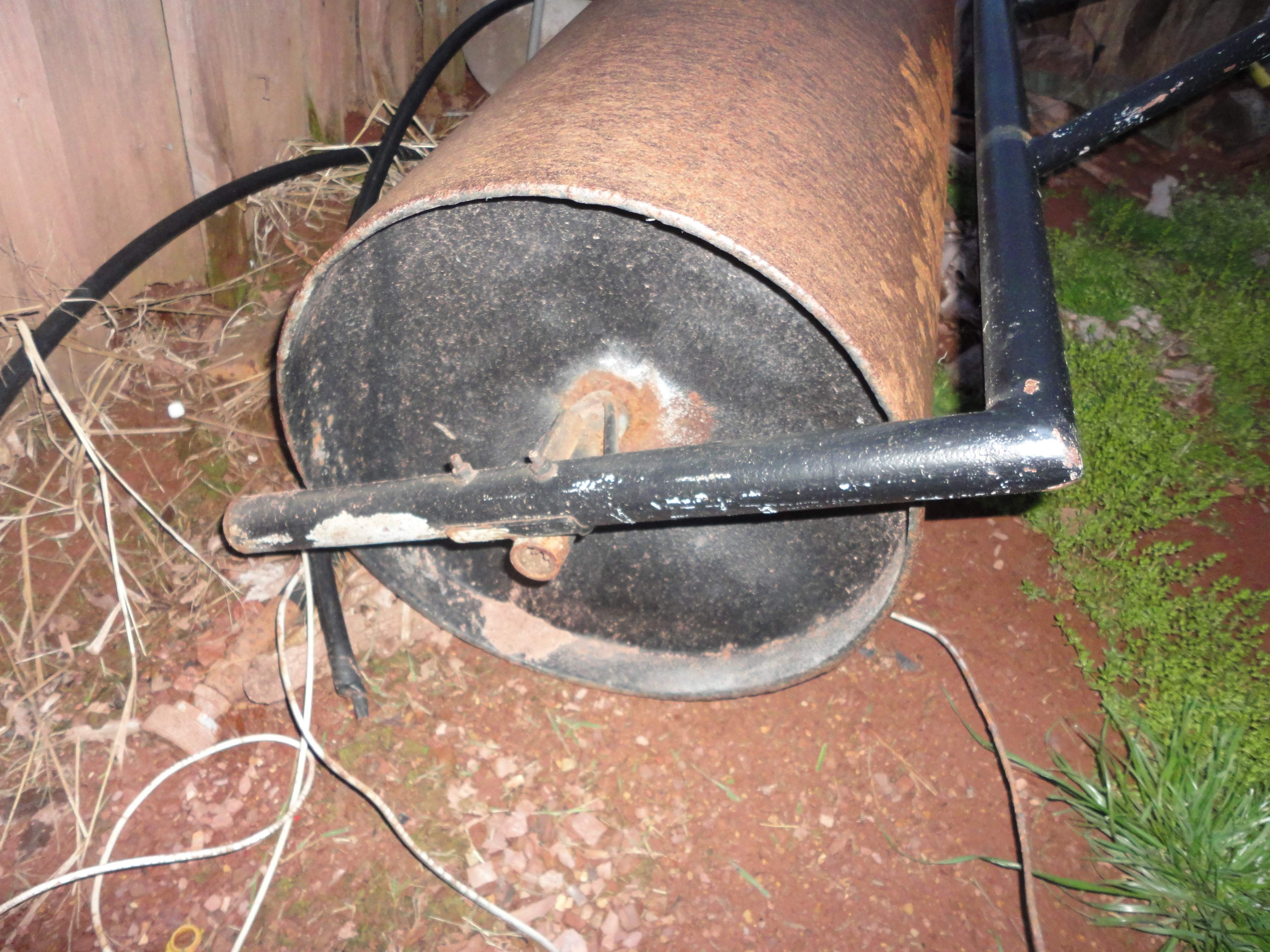

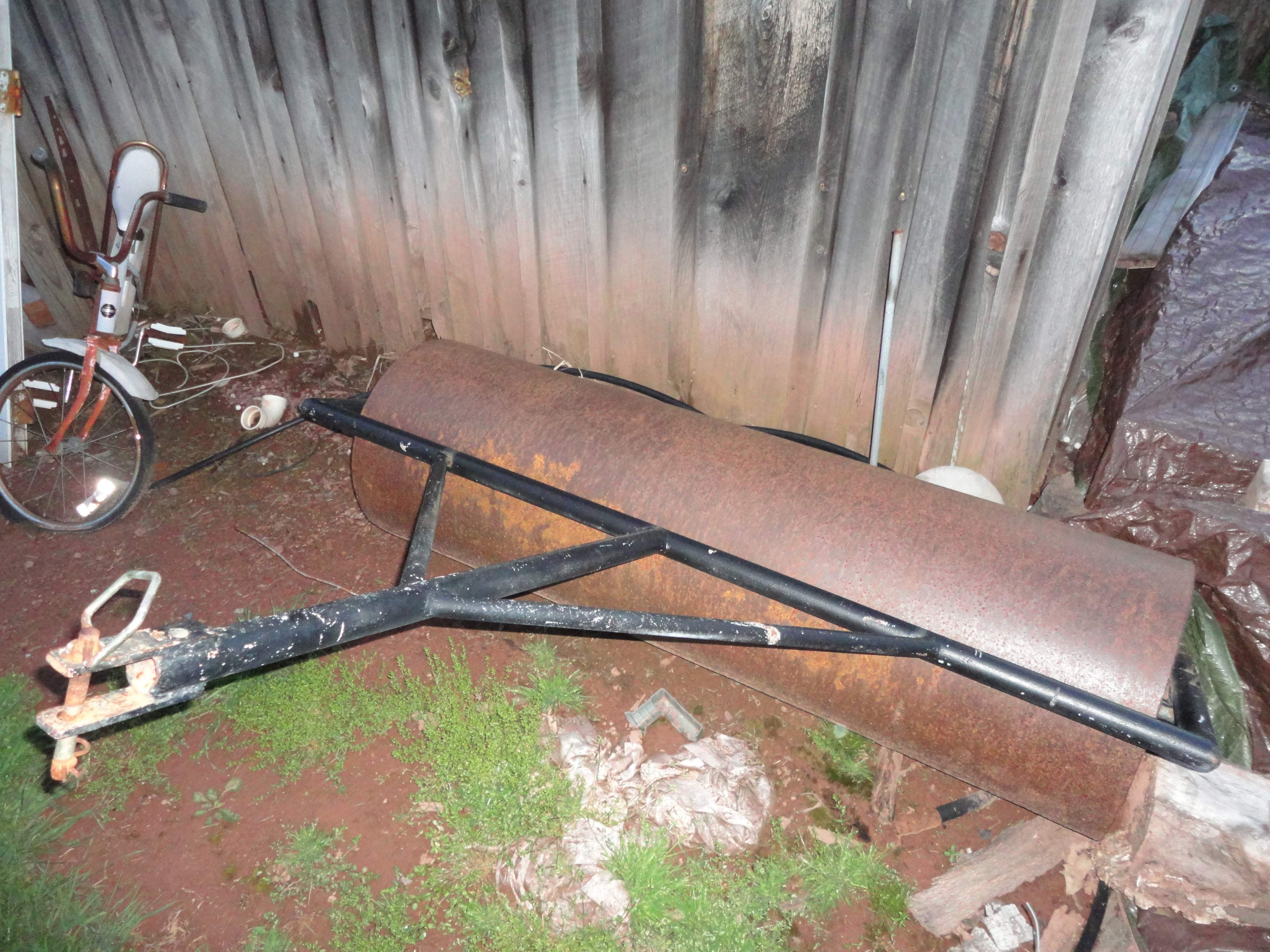

this one we made several years ago when 75% full of water it's all my jd can pull around.DSC00470.jpgDSC00471.jpg
