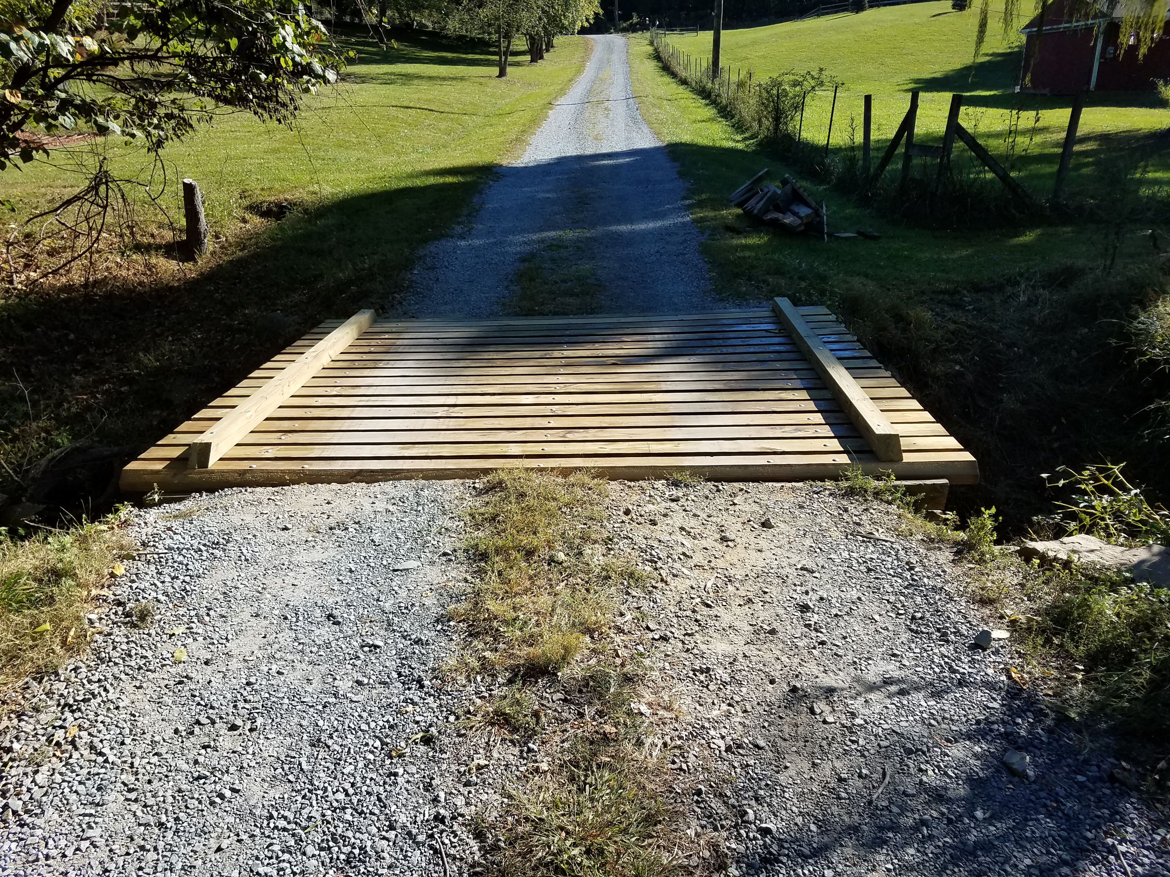

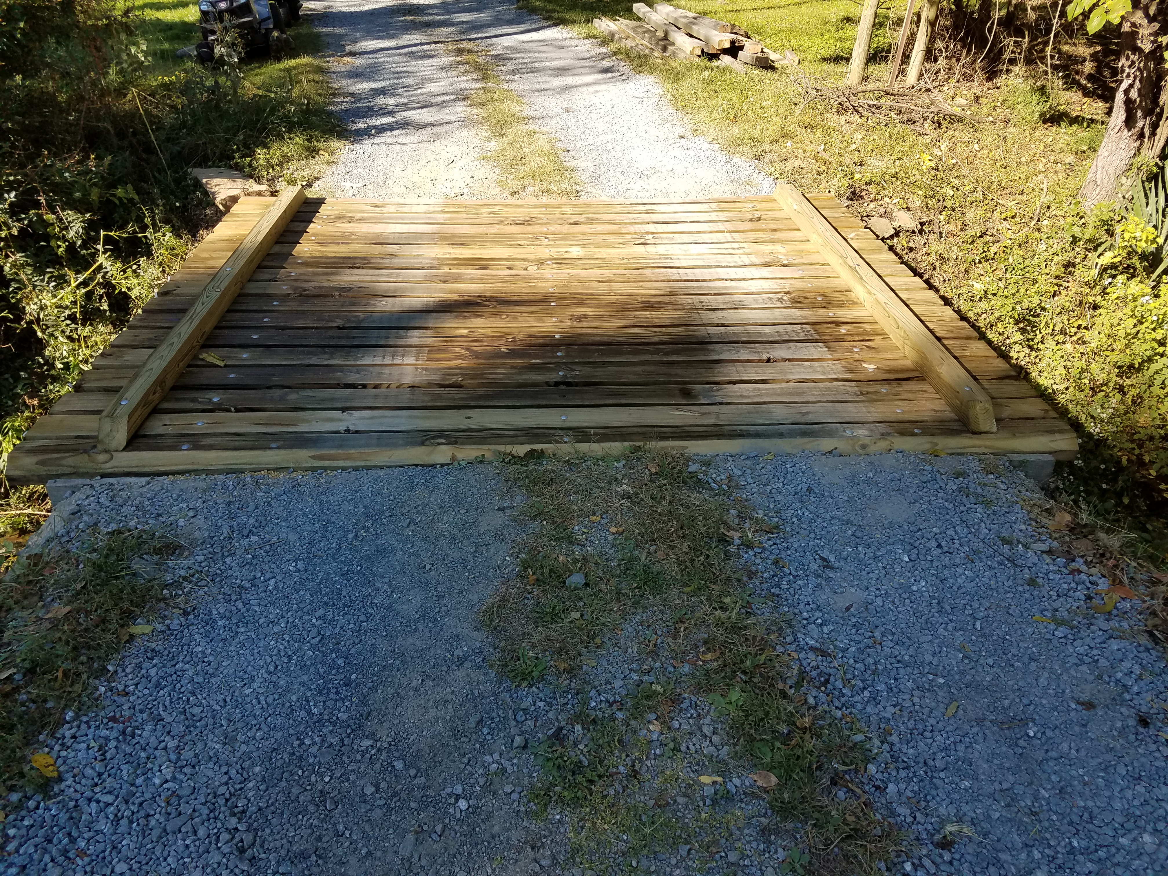

My neighbor and I share a bridge that is engineered by county regs to handle fire trucks. He and I are responsible for the upkeep. We just recently re-decked it with 4x6 PT lumber and it is secured with carriage bolts. The span is only half of what you're describing, but the same principle could be used. We have poured concrete abutments and steel I-beams for the span.

Is that two or three steel I-beams? How wide is the deck?

That's a really nice bridge and decking. I take it that it incorporates 3 main beams for support, and from the tread pattern, it seems the traffic spans between the two outer and one center beam, yes?

Sorry, I'm late to reply. The decking is perpendicular to the beams. There are actually 7 I-beams there (fire apparatus isn't light). There are 3 in the tire patch area (to the inside of the side rail) on each side and then a single down the center for support of the decking.
The only thing that drives down the center of the bridge is my MF, the neighbor's Deere, and a Craftsman lawn tractor.
Where you see the carriage bolts, the bolts are actually bolted through a 2x6 that provides a wider bolting surface for the decking and is simply to prevent rolling/racking/shifting of the deck. Those 2x6s are wedged in tight against the underside of the 'ears' of the beams and between the abutments and are themselves bolted through the I-beams.
When there isn't so much water in the creek, I'll try and grab a picture from underneath. We were so tired, we didn't think to take any under there.
