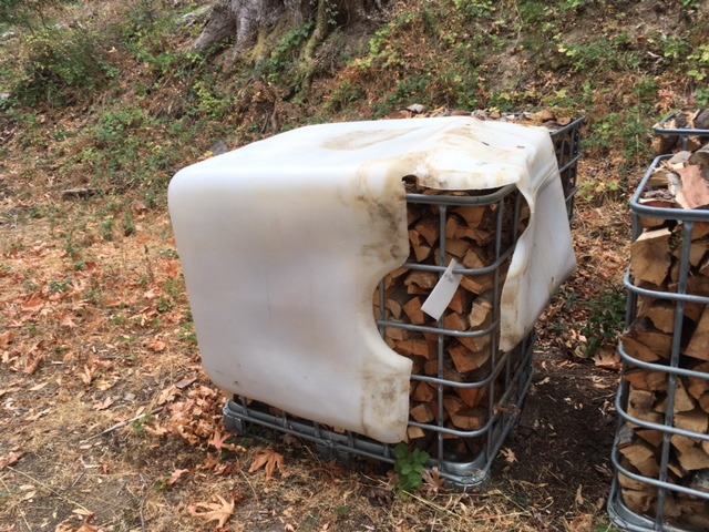

I cut off one side and make two cuts so the bottom is a flap. Then heat form the flap with a propane torch and 2x4 so it bends over the edge of the cage. I end up with a cover that keeps the rain off even when it's driving sideways (if you have the cover oriented right.) But there's still plenty of air circulation under the cover. We're in a funny microclimate and our rain often comes in sideways from the east.
I park the totes in my wood processing area in one orientation and when I move them up to the house for consumption they go in the same orientation, so it works out for me.

I'm having a hard time following you. Picture please.

Here's some pics. If you look down from the top (or measure) you'll see that the tote and bladder are not square. One side is about 6" wider than the other. I orient my bladder cover so the large side ends up on the top. I cut away the other large side. That leaves more room for air circulation. You do need to space the totes out a bit because of this, and leave room between them to get the covers on and off. I take the covers off for our rainless summers. I use a hole saw first at the corners where I am going to cut, then make the cuts to the holes. That way there's less chance of the cuts tearing later. And also drill a hole in the end of the flap to make it easier to pull on. You can barely see it near the bottom edge of the flap. When I grab wood for the stove I push the cover off, stack the wood in small boxes to carry inside and pull the cover back on.
The tag in the first pic is a piece of the part I cut out which has the date I filled the tote written in sharpie. So I can find the tote with the oldest wood. Yes I know I'm overthinking this, that's how I roll. (and also I need to get a cap for this tote that I got free)

Very well thought out, functional, and also hideous, Eric. Lol. No offense intended.
