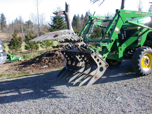

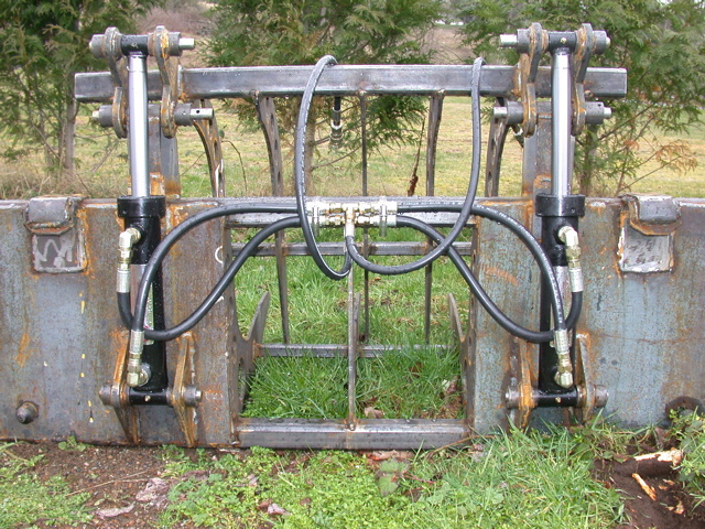

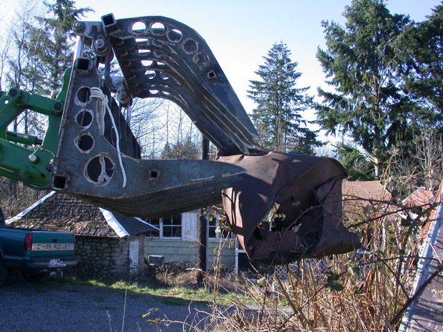

This is the grapple I built. I run it on my JD 4310. When we bought the tractor I wanted to be able to use the tractor to pick up debris (from wind storms and old junk on the property) and pull blackberry bushes and other vegetation out of the ground. It has also worked great for picking up logs and having two people run chainsaws to chop pieces off each end.
The grapple weighs about 250lbs, i think. It is 54" wide with 7 tines approximately 9" apart, the top closing part is 36" wide with 7 tines about 5" apart. The tines are 24" long on the bottom. The holes were cut to reduce weight. It increased the price of cutting, but I wanted the weight reduction.
I used 5/16" T-1 on the tines, and 1/4" for the backing and structure. Used 2" square tubing to build it off.
I had the T-1 pieces plasma cut at a local metal supplier. They didn't have the T-1 in stock so I had to purchase the whole piece, I kept the scrap. :)
I dual shield welded it, this allowed me to get very good penetration on the weld joints. I pre-heated the metal before I welded it. After it was done, I then hardfaced all the lower tines.
I have it setup for quick release off the front. I didn't know how to plumb the hydraulics so I had the dealer do the hydraulics for me. Now, I could do it the next time.
I bent the outside tine prying a rock out of the ground, so I cut a 1/4" wall 1" pipe in half and welded that to the outside tines.
If you want more information, just let me know.
