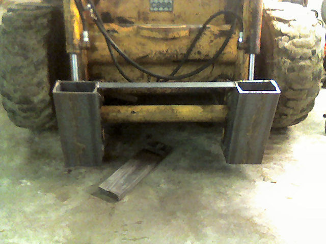

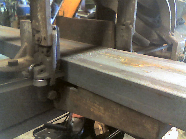

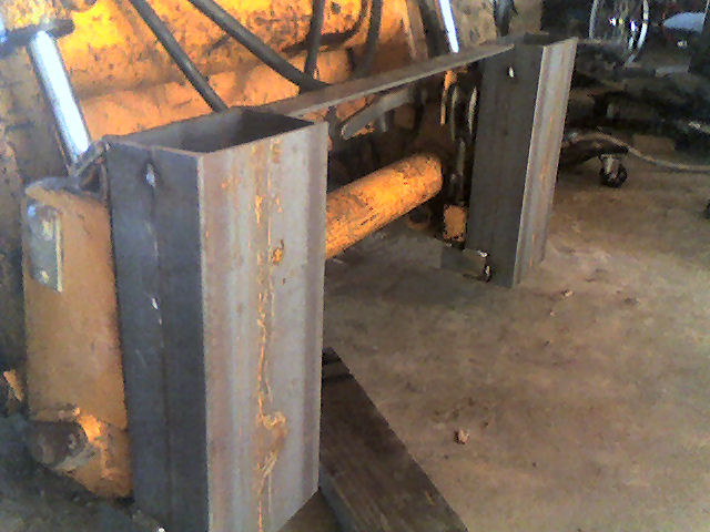

WoW!! do I move slow :D Here are some pictures of cutting steel and backing plate attached, lots more to do, be patient with me and Skeptic, I'm jealous of your fine looking grapple
Jim

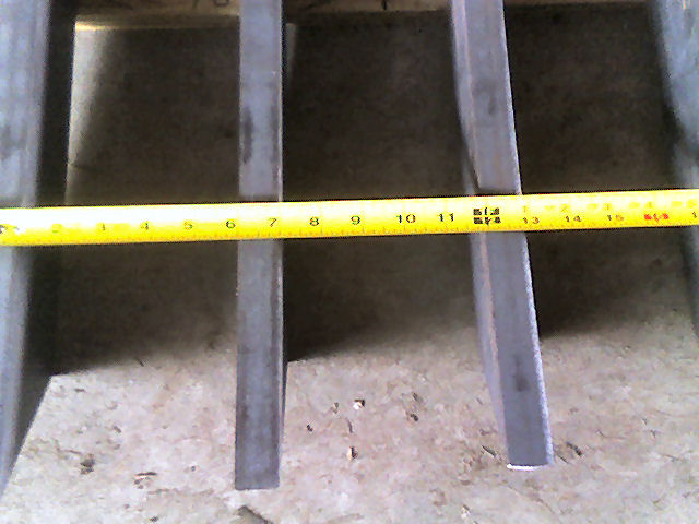

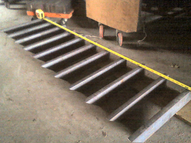

JB, We know the feeling LOL I have the bottom piece cut ( 3 X 5 X 1/4 square tube )and I hate working with rusty metal it takes forever to grind it clean, I also have my 28 teeth ( 1" X 3" x 18" flat stock ) cut also, I thought I took pictures of them but I guess not. It will be seven feet wide with fifteen teeth on the bottom with thirteen more on the top and it will be mostly a huge rake
EDIT, I found some teeth pictures, see below
