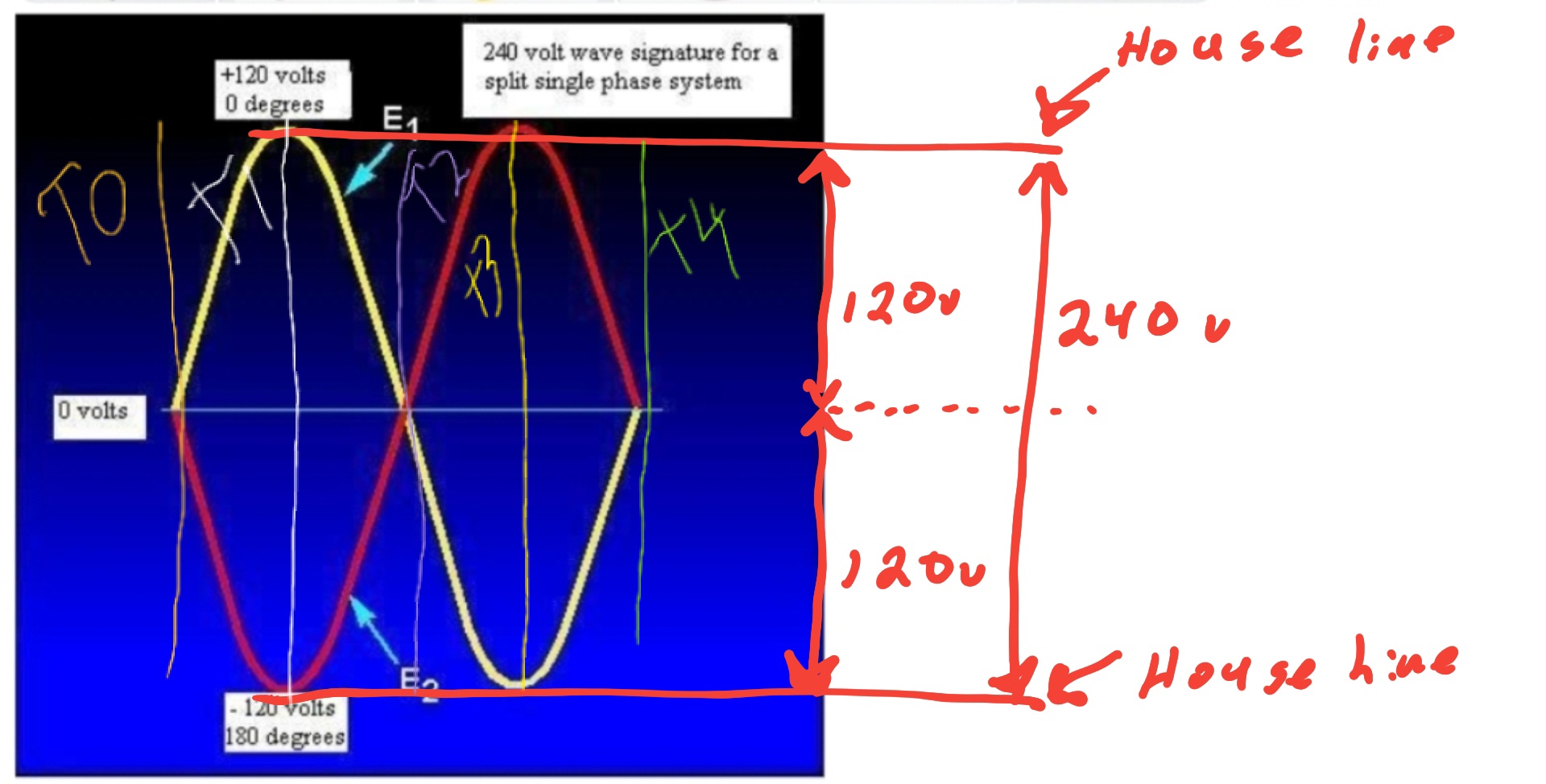

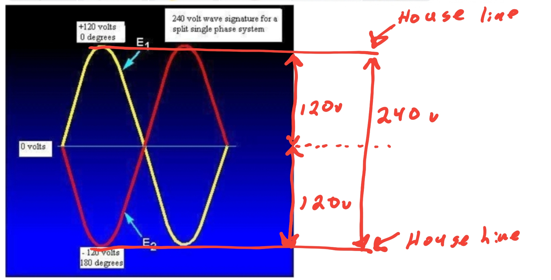

No - See the diagram on post 13. It's all single phase. The two 120 volt sources are 180 degrees out of phase from each other and this creates the 240 volt differential. At the sine waveform peak one is 120v plus and the other 120v opposite peak creating a 240 volt differential.
Incoming single phase AC power is fed into a center tap transformer , reduced and split into two 120 volt single phase lines that are 180 phase degrees apart (polarity inversion). This is then fed into your house service. This is why it's called split phase.

No - See the diagram on post 13. It's all single phase. The two 120 volt sources are 180 degrees out of phase from each other and this creates the 240 volt differential. At the sine waveform peak one is 120v plus and the other 120v opposite creating a 240 volt differential.
Just because you were able to screenshot evidence of someone else on the internet that shares your misconception, doesn't make either of you correct. Whoever typed that up is also trying to teach the rest of us that a 120VAC wave has peaks of +/- 120V. They need to educate themselves about RMS voltage before continuing to speak publicly.

I am correct. Look at the RMS potential of a single 120v sine wave in the diagram and since there is a second wave with the voltage inverted power and voltage are doubled if the load is across both. You'd be surprised how many career electricians don't have a clear understanding of this.
I am a retired electrical/electronic technician with an EE degree and numerous certifications. 44 year career.

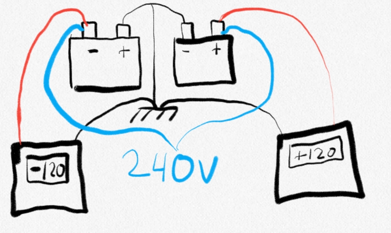

This is easier to understand if we think of it like a DC circuit. At the risk of further muddying the waters with two batteries which I'm sure someone will fixate on as two separate voltage sources (two phases), here's an illustration:
Please (please) consider these two batteries as inseparable, or as a single battery with a center post (like a center tapped transformer).
If we are referencing from ground to each end post, then our multimeters will give us one positive value and one negative. If we want them both to read positive, we can simply reverse the leads of the first multimeter. In fact, we should reverse the leads because we've got them backwards. The leads should be arranged the way that the batteries are arranged.
From here all we have to do is make the batteries reverse polarity 60 times per second, and it turns into AC example.
The only source of this "180 degrees out of phase" (revered polarity) waveform is some dingus who do doesn't connect their oscilloscope properly (or can't because they're using a non-isolated scope and don't know how the invert button works).

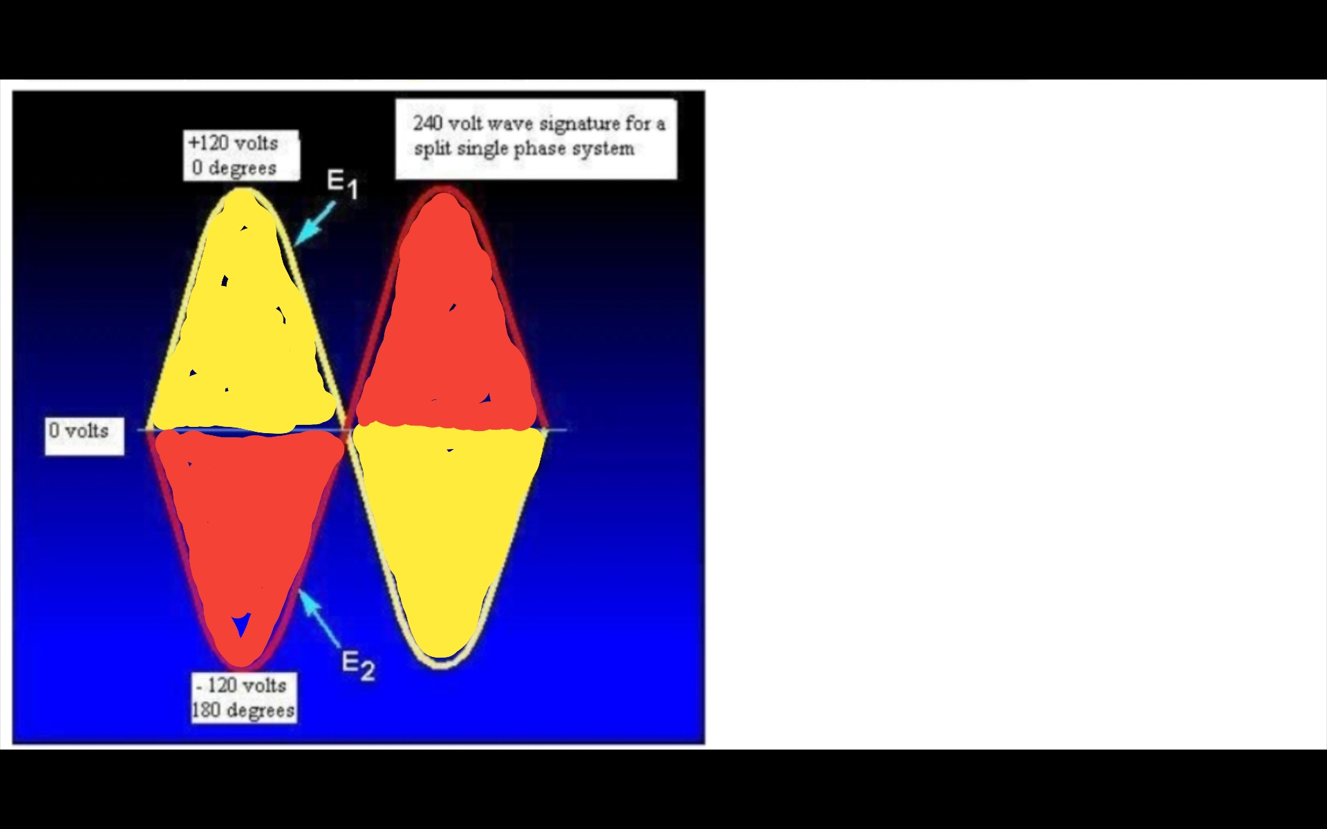

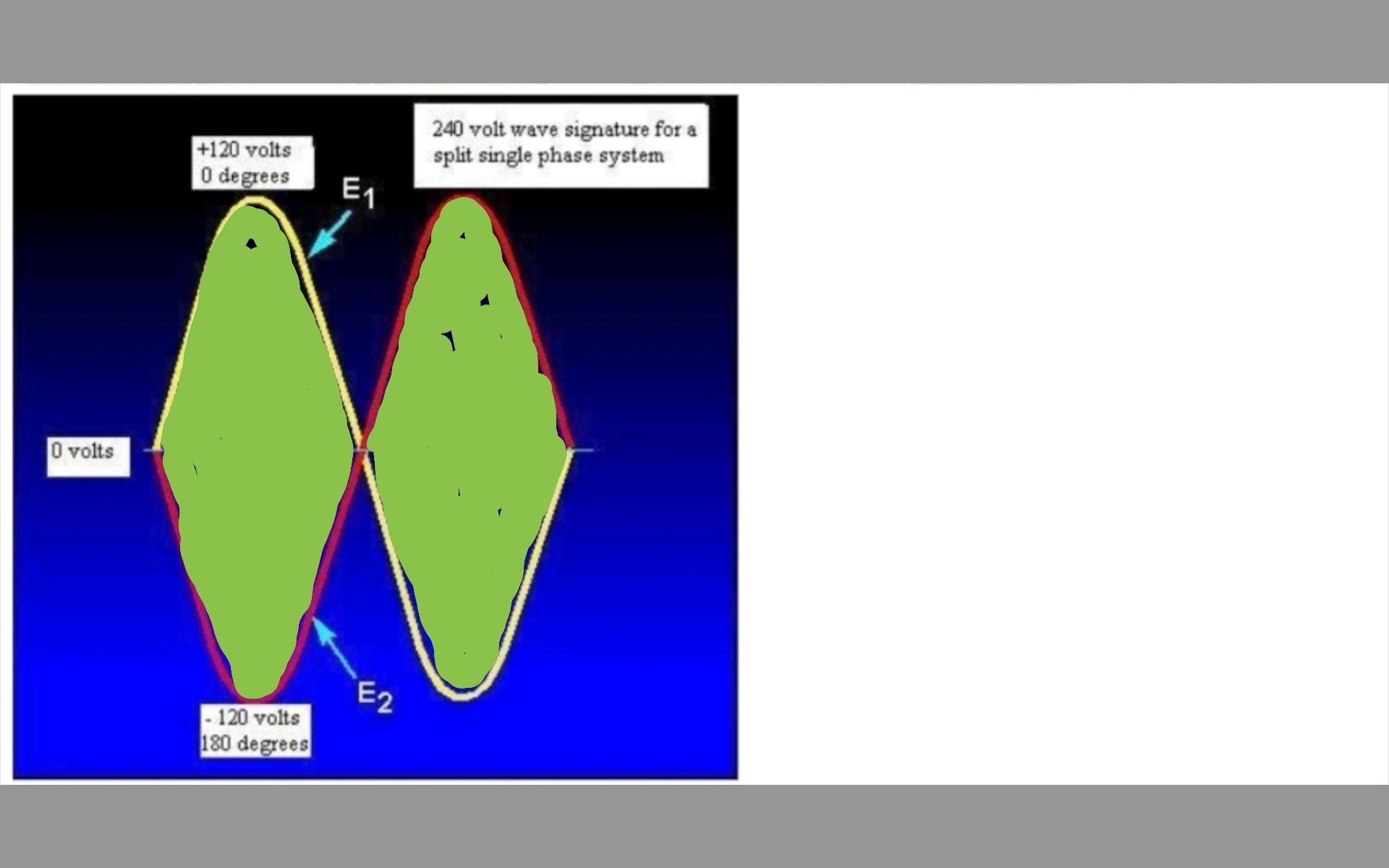

Yellow is the RMS potential of sine wave E1 - A load applied on E1 can utilize this power -120v
Red is the RMS potential of sine wave E2 - A load applied on E2 can utilize this power - 120v
Green is the RMS potential of a load applied across E1 & E2 - 240v

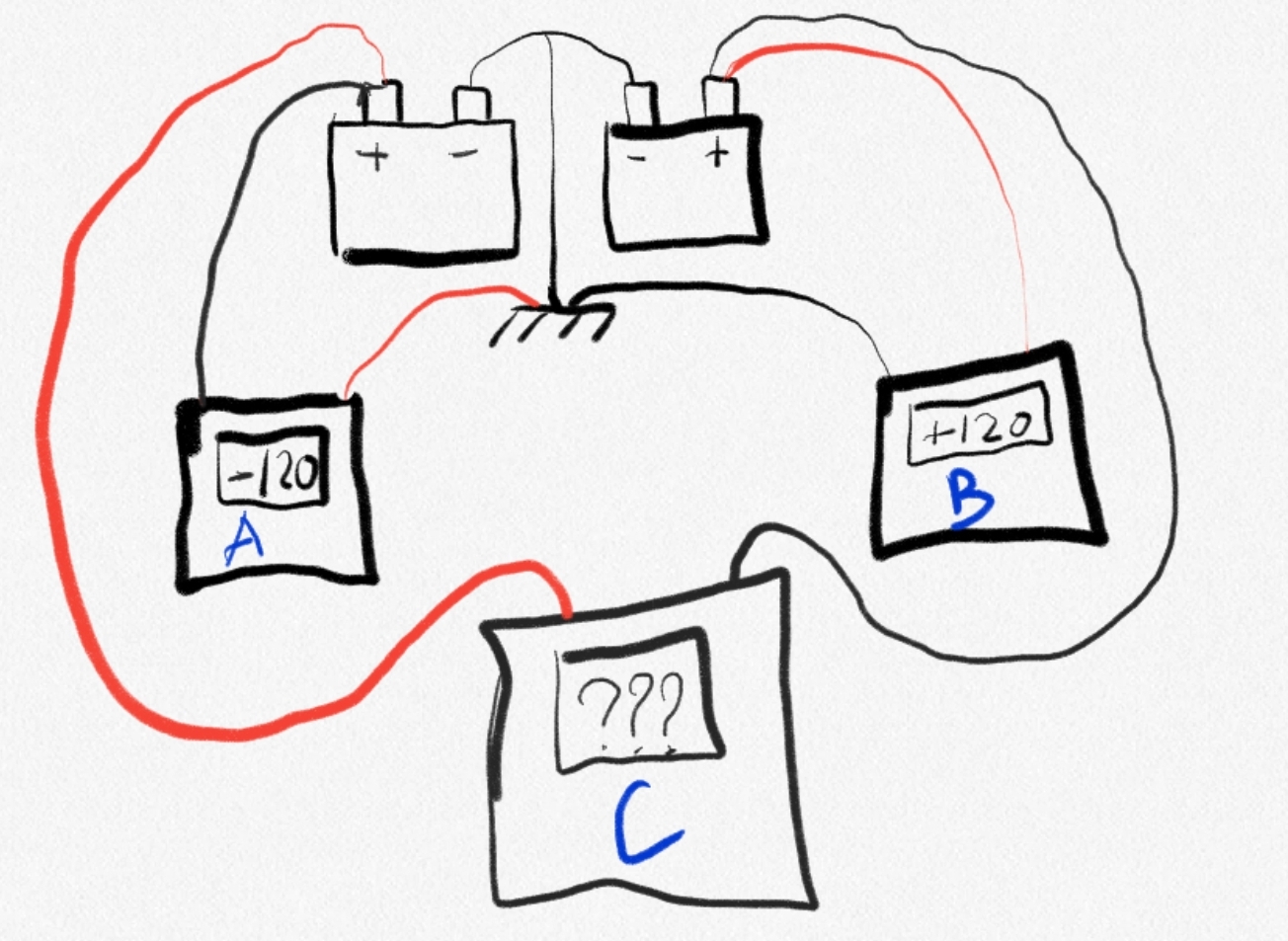

Ok I've drawn the batteries "180 degrees out of phase" (reversed polarity) as you think a split phase system works.
What will meter "C" read?
This is a pictographic restatement of my question that you didn't answer.
What is (-120) + 120?
